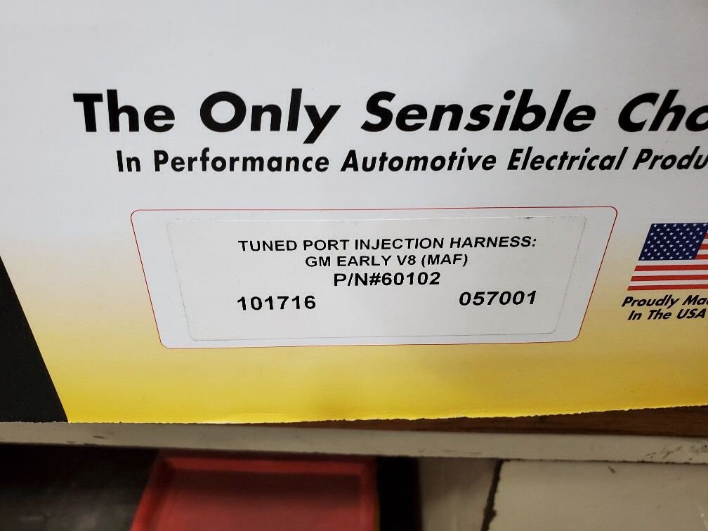

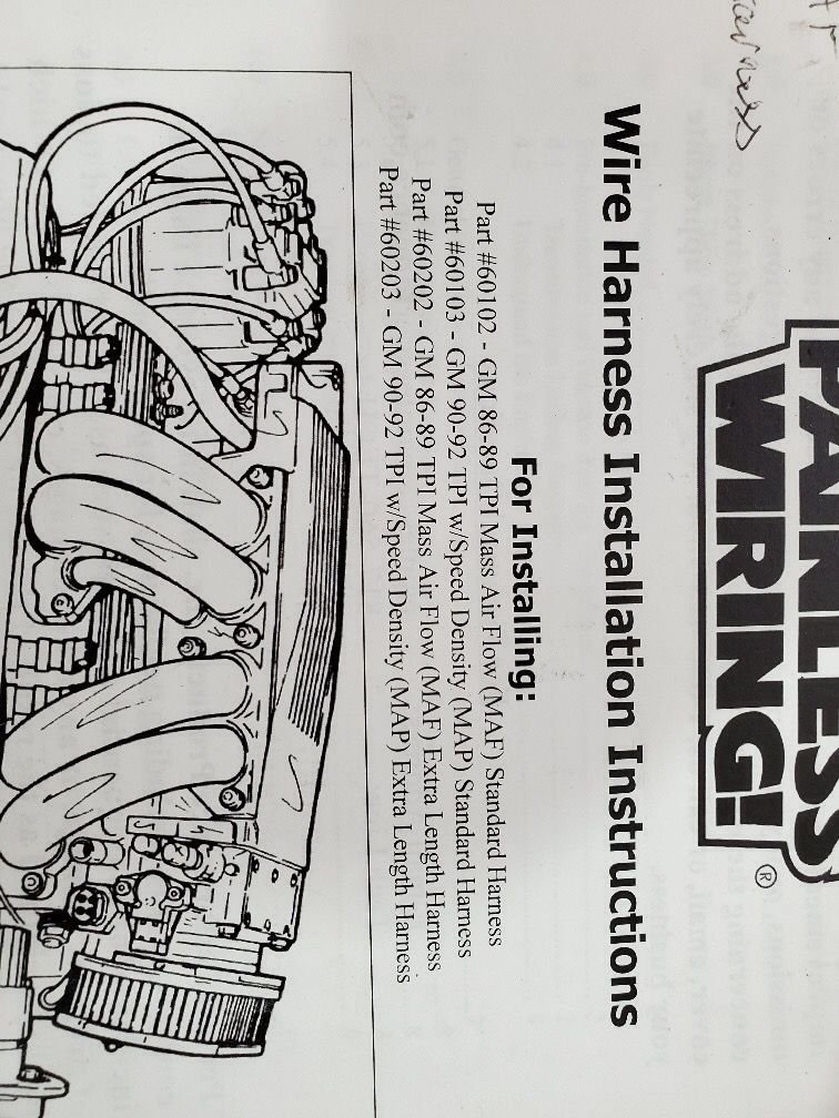

When I purchased the harness I was told it would work with the 1985 engine, and I verified directly with Painless. There is a provision for the CSI on the harness. What would need to be done to upgrade to a 1227165 ECM?

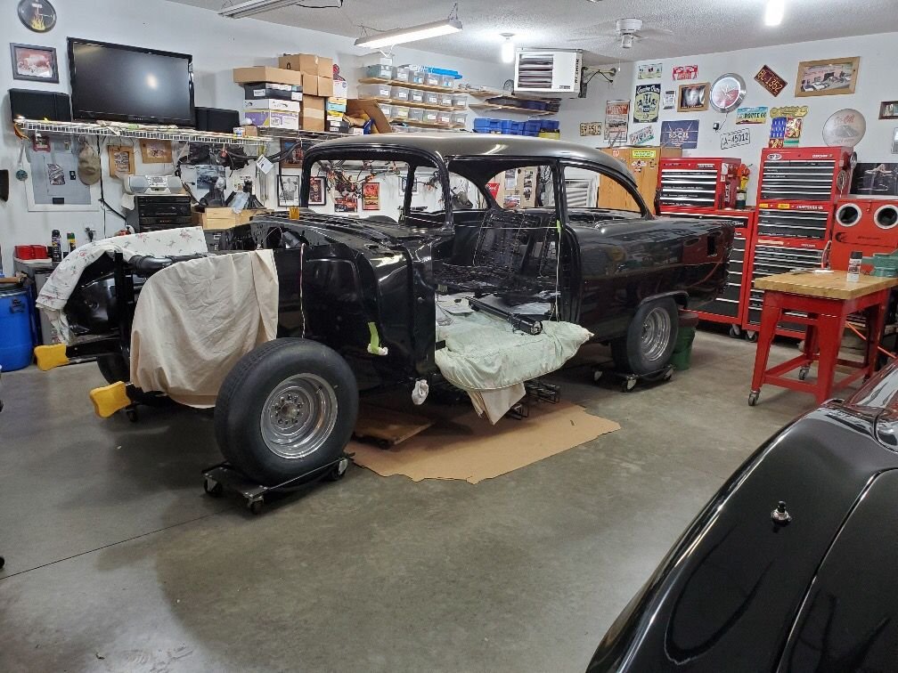

Here's what I have...

That harness is for a 1227165 ecm. I’m not sure if the 85 maf sensor can be used. Could always give it a try . It’s considered digital and 86-89 uses analog. You should get a memcal programmed for 89 without vats.
this world not use the ninth injector. There are block off kits available on eBay or hawks thirdgen.

Painless was mistaken. That will not work with the 85 computer or MAF. You will need to get a 1227165 ECM, matching 86-89 MAF sensor, and as Tuned Performance mentioned you will need an 89 PROM chip or custom chip to delete the CSI.
It has the CSI injector provisions because those were used on 86-88 models as well as 85.

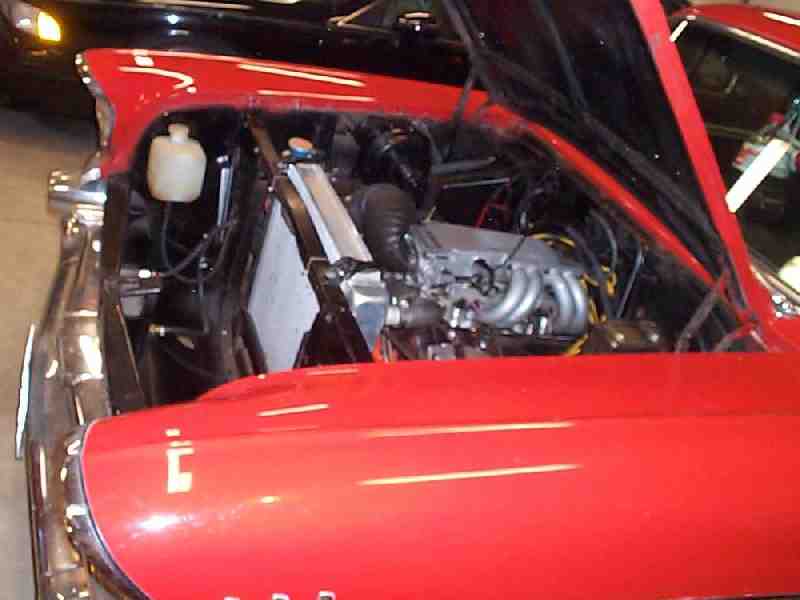

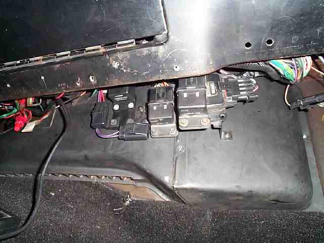

In my experience, the 1985-version FM output MAF cannot be used reliably with the analog input scheme used in the 1986-89 ECMs due primarily to linearity at the higher output end - The "dumb" input buffer cannot reliably translate thr FM output to the required analog voltage. You could build a rudimentary converter using a 0808 and divider to get the supply voltage to 5V (or a regulator IC), but it is probably just easier (and possibly cheaper) to get a later design analog MAF.
Once the MAF issue is resolved, the use or elimination of the CSI is easy, and well-documented here, many times.
Been there:

Side note on the 9th injector. Since you have what looks to be a fair weather hobby car, you could probably block off the 9th injector and do nothing else. If you are not driving it in the cold, won't matter. One thing that didn't get touched on here, is the ECM does not control the 9th injector. It is only powered during cranking to give extra fuel when it is cold. The later cars just opened the cranking pulse width, Ideally you get a chip with the updated tables, but if you only drive in nice weather, you wouldn't notice it is gone.
