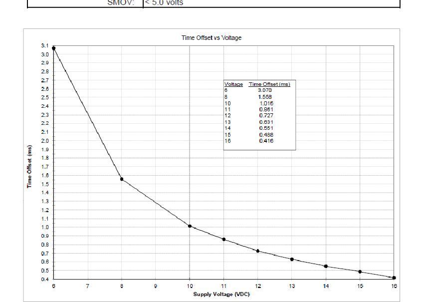

Just because they flow the same at 43.5psi not all injectors act the same . You will need to tune flow rate and offsets before you refine fueling. A lot more on this topic in the diy tuning and tuning guide

Re: TFS-89024 - Trick Flow® TFX™ Fuel Injectors - Will it fit OEM manifold?
https://www.holley.com/products/fuel...e/parts/150824
Go down to technical specs and the time vs voltage graph is in there.

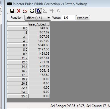

Okay, so you convinced me to buy the new Accel 150824 since they are the newer modell with less trouble and the southbay are way more expensive and their 10% wont work for paypal orders outside of USA.
Question about the injector offsets:
Can I change the old values in the slot "injector pulse width correction vs battery voltage" with the new ones from the table accel is providing? Im asking cause of the units "usec added" the "u" stands for micro or milli seconds? Cause the values in the bin file are greater than the values in the accel table. Because of that im thinking its micro seconds and the other milli?
Msec is a millisecond, usec is a microsecond.
https://www.timecalculator.net/milli...o-microseconds
That makes it extra easy to convert and plug in the number to the table.
