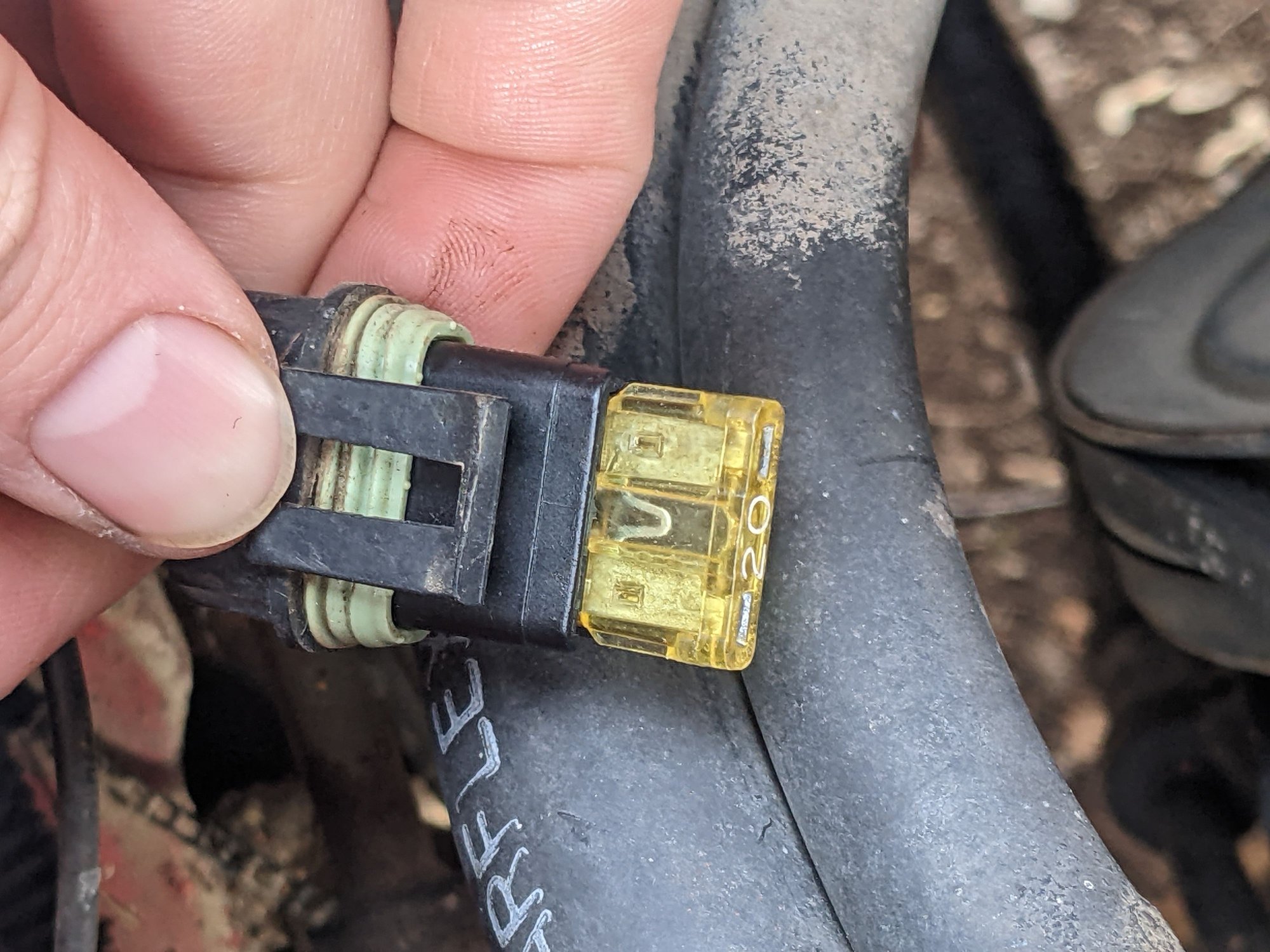

Cold start injector has 4.0 ohms. Fixed the wiring harness to the fuel pump relay. Replaced the relay. Still won't start. Waiting for my noid light kit from eBay. I'm not getting any dash lights when I turn the key ON. What's the best way to test the ECM? The 5 and 3 ohm fuses do not have power with key ON. I assume one of these is ECM. But the white letters are all worn off the fuse box

Ecm fuse is next to battery, check your fusable links at the starter if no power at the fuse box.
ecm
has accessory power and keep alive from battery. Look at 1226870 schematic

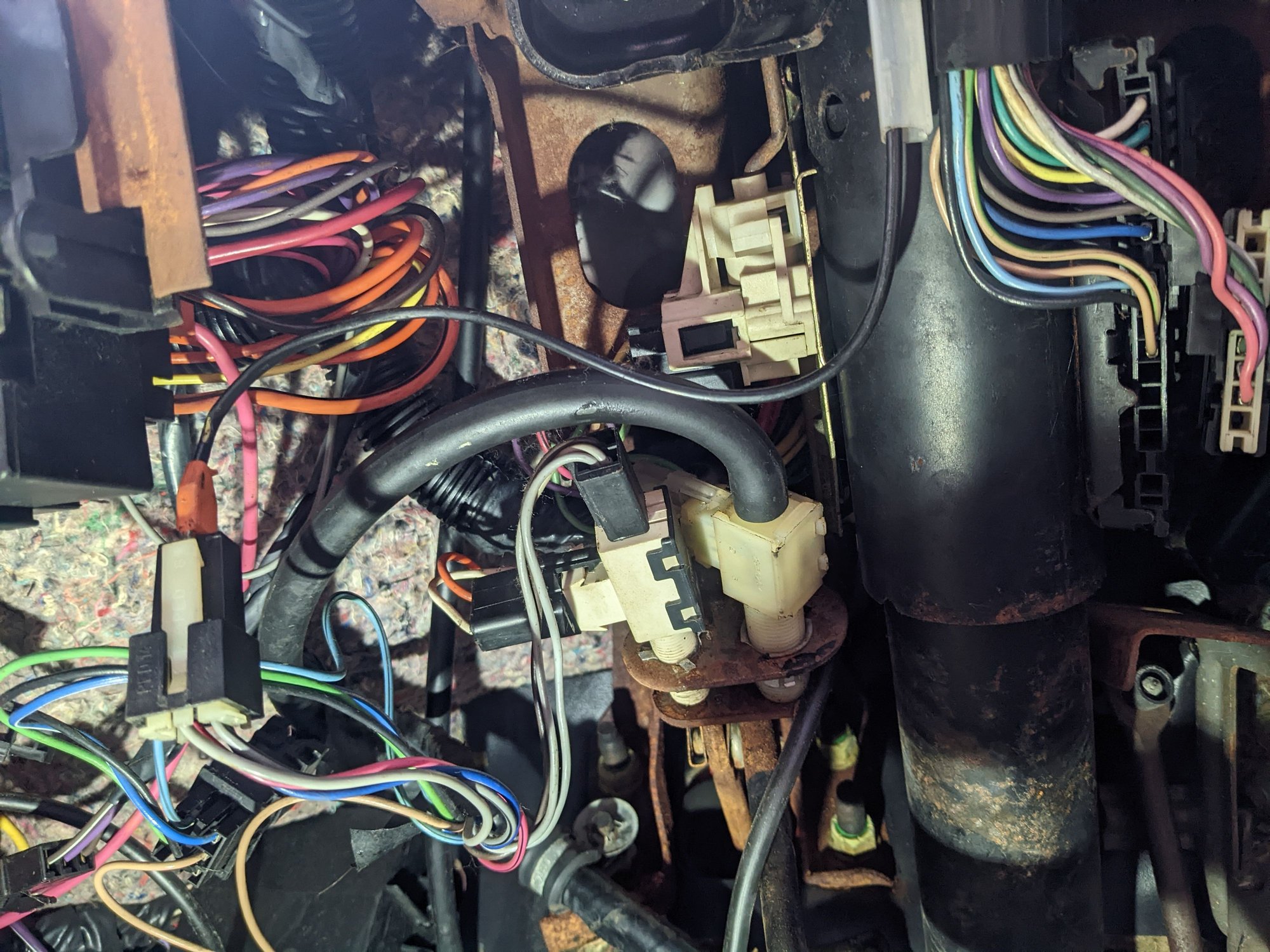

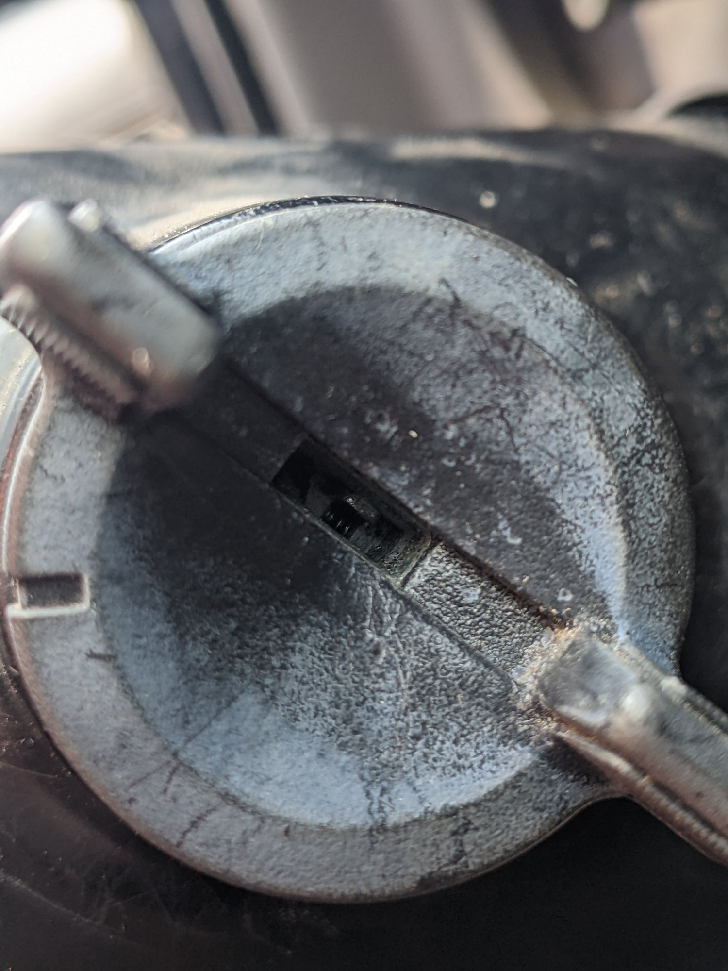

ECM fuse is good, 12 v each side. Relay is getting power and ground in/out. I started checking ECM pinout with my power probe. I have all the necessary power and grounds with one exception. The Burn Off Relay Control has 0v and it's supposed to have 12V with key ON. I see that it's up under the dash pad above where I pulled the ECM from. Maybe this Relay box needs to be replaced. I'll have to get to it and check the wiring. Also realized my keys don't have a resistor in them. The car still runs the fuel pump and cranks but obviously won't start. Ignition looks old, so maybe I simply need to buy some resistors and try to find the correct one to wire into VATS, although I have not located that orange wire yet.

Re: 305 TPI losing fuel pressure
You don’t have vats
Old Mar 20, 2022 | 12:57 PM

Good to know. What are your thoughts on a bad Burn Off Control Relay causing a no start issue?

I went thru all the wires on the ECM and found one irregularity according to the diagram. The Park/neutral safety switch is supposed to have 12v with key on, and I have a ground instead. I pulled the center console apart to look at the switch. The yellow wire on top is grounded when in park or neutral. Purple wire under yellow wire is constant ground. Found pink/black wire that runs to ECM and it had ground so I gave it power with the power probe and cranked. Still won't start. Used a noid light and confirmed injectors are getting power and ground but the light was kind of weak. Had a battery charger going at 2 amps. I still don't have any dash lights when I turn the key on and can't pull any check engine codes. I think that has something to do with the no start issue. Maybe the ECM is dead?

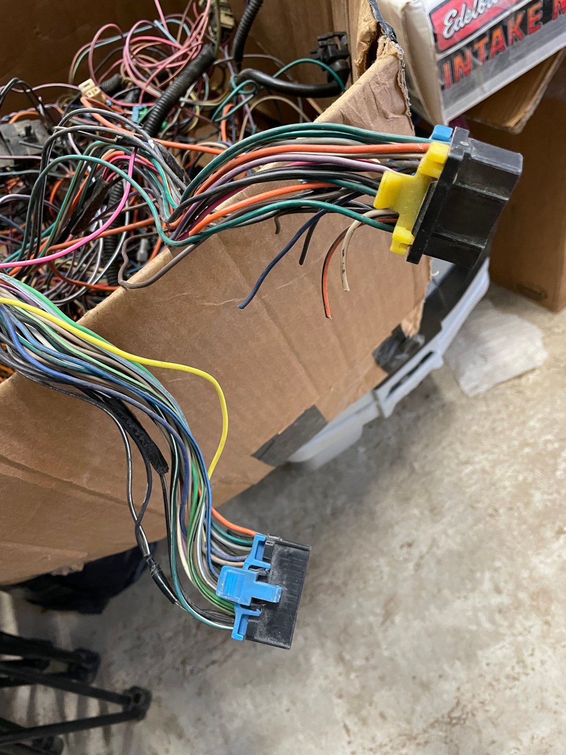

I am going to upgrade to a 165 ECM. I know I need 2 relays with pigtails, ECM and PROM. Who can I go to for PROM programming? Im grabbing a Lisle repin tool as well. Anything else I might need? Found an old website with some good info, just want to cover my bases. Thanks

I have a parts harness or can snip pigtails off a 86-87 harness for parts only but maf burnoff pigtail is junk

believe you also need a analog maf the digital one might not work with the 165

Replaced the ECM and relays to the 88-89 style and got the car running. Seemed to run well, maybe idles a bit high.
