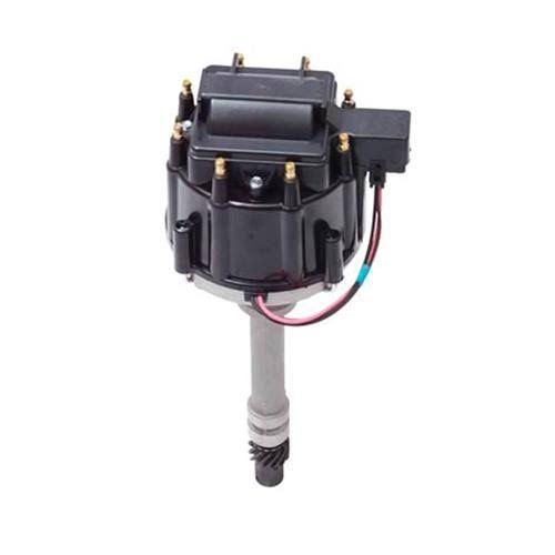

86 is likely a large cap hei distributor. 87 was the switch over year as I recall. But they can be converted from one to the other, which maybe a previous owner has done. (Not super likely but very plausible)
All you have to do is look at it. They are distinctly different. The small cap has a ign coil separate, large cap holds the coil in the top of the cap. The photo with wires attached is the large cap

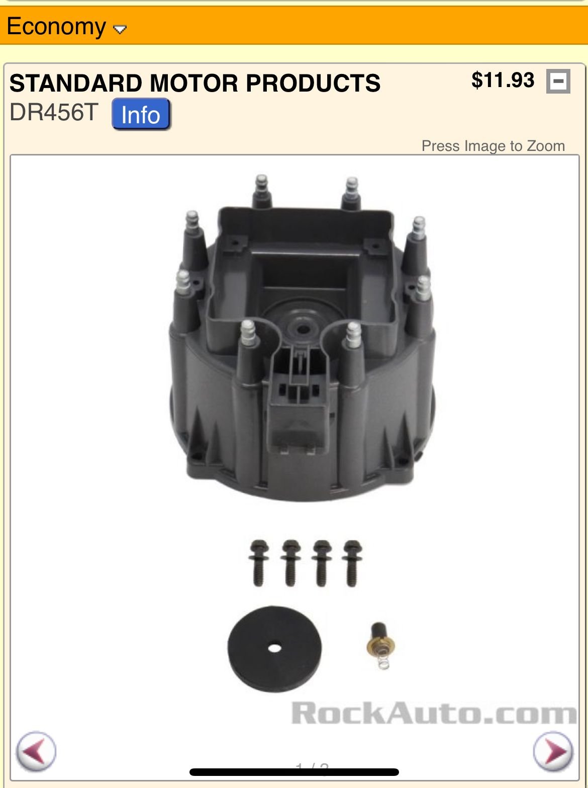

Iirc 85-86 was identical to 85-91 c4 but with a non melonized gear. Unlike 74 style hei the tpi large cab used screws instead of latches to hold on coil/cap. Can probably pick one from cardone on Amazon.

Both are clamp down. I'm not exactly sure what Tuned is referring to. I'm not aware of any screw down large cap. I took a very quick glance and the parts called for a 86 call for a normal large distributor cap.
The only difference I know of is a melonized gear for roller cam. Your 86 would've been a flat tappet cam from the factory.

I see, Tuned. I took a longer look. The listing for 86 shows both types. Which one that is on the OP's car remains to be seen. The function would be identical, I'd imagine.
Odd that I've never ran into a screw type before. Even on the 86 I owned. Interesting.
Maybe a case of one on TPI and one on carb?

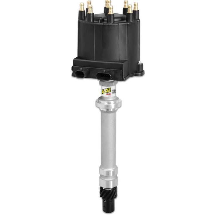

Would a Small Cap Distributor be able to fit a 86 305 TPI? I found one from DUI that is intended for an 87 but has the same engine. Wondering if that is able to just drop in or if it needs modifications.

it needs to be rewired. I haven't personally done it but these kits are available.
https://www.michiganmotorsports.com/...ness-fits-sbc/
DUI does offer a large cap cc distributor
https://performancedistributors.com/...-distributors/
