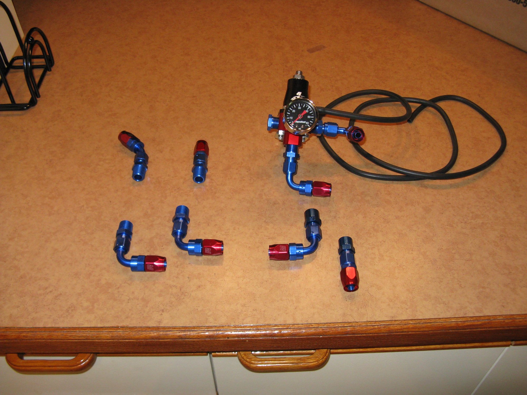

I did a "pilot project" on a stock LB9 ('91, 230hp version, speed density) with CAI, TPI foil, headers, single high flow catalytic convert, 3in cat back and custom tune (260-265 HP). I saw a tinny difference in power with the FIRST intake and my own retuning. It pushed the peak torque/HP up a bit. Here's a chart, all things being equal, I had to adjust VE tables at WOT to bring back WOT AFR to target (using AFR gauge). The engine was definitely breathing better but to what extent? Was it worth the money? This chart is not an exact science, just an idea of what the FIRST intake did to my set-up. About 3-4% peak VE gain, about 5-10hp if...
UPDATED: The FIRST TPI Intake was the 835cfm model with 1205 style port. It was installed as is on the 305 with no port match to the head. This was done because the 305 was to be swapped for a 383 in the future.
I got the FIRST because I was planning to get a 383 stroker. Wanted to test fit everything on 305 first. Everything transferred over: https://www.thirdgen.org/forums/engi...st-intake.html
Here's a video from FIRST:
Installed on LB9 engine
Some of the stuff I had to buy for fuel, coolant, wiring, etc... I did use flared fittings, a fake EGR valve (for inspection), a custom weathered connector for the IAC and other goodies.
