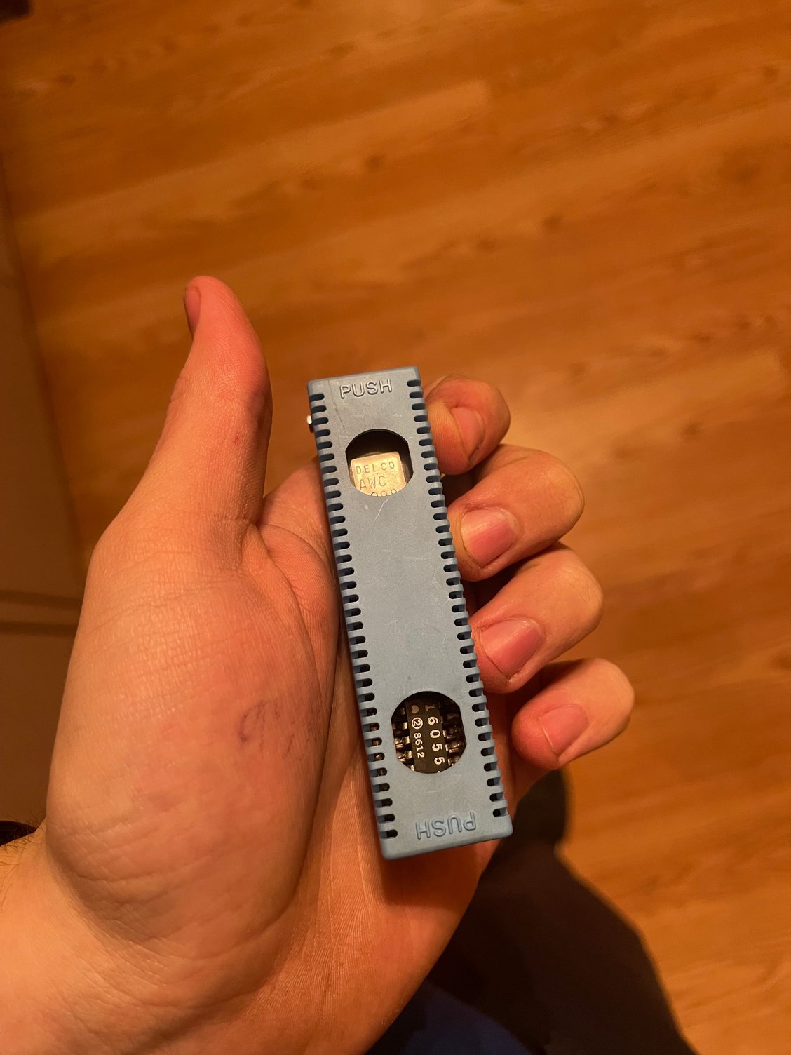

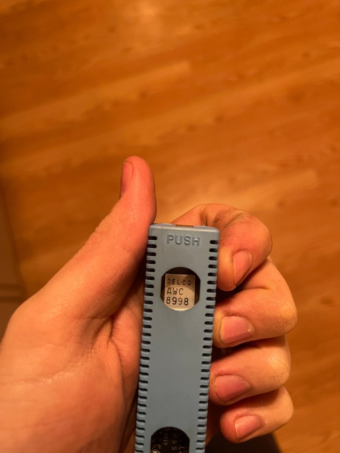

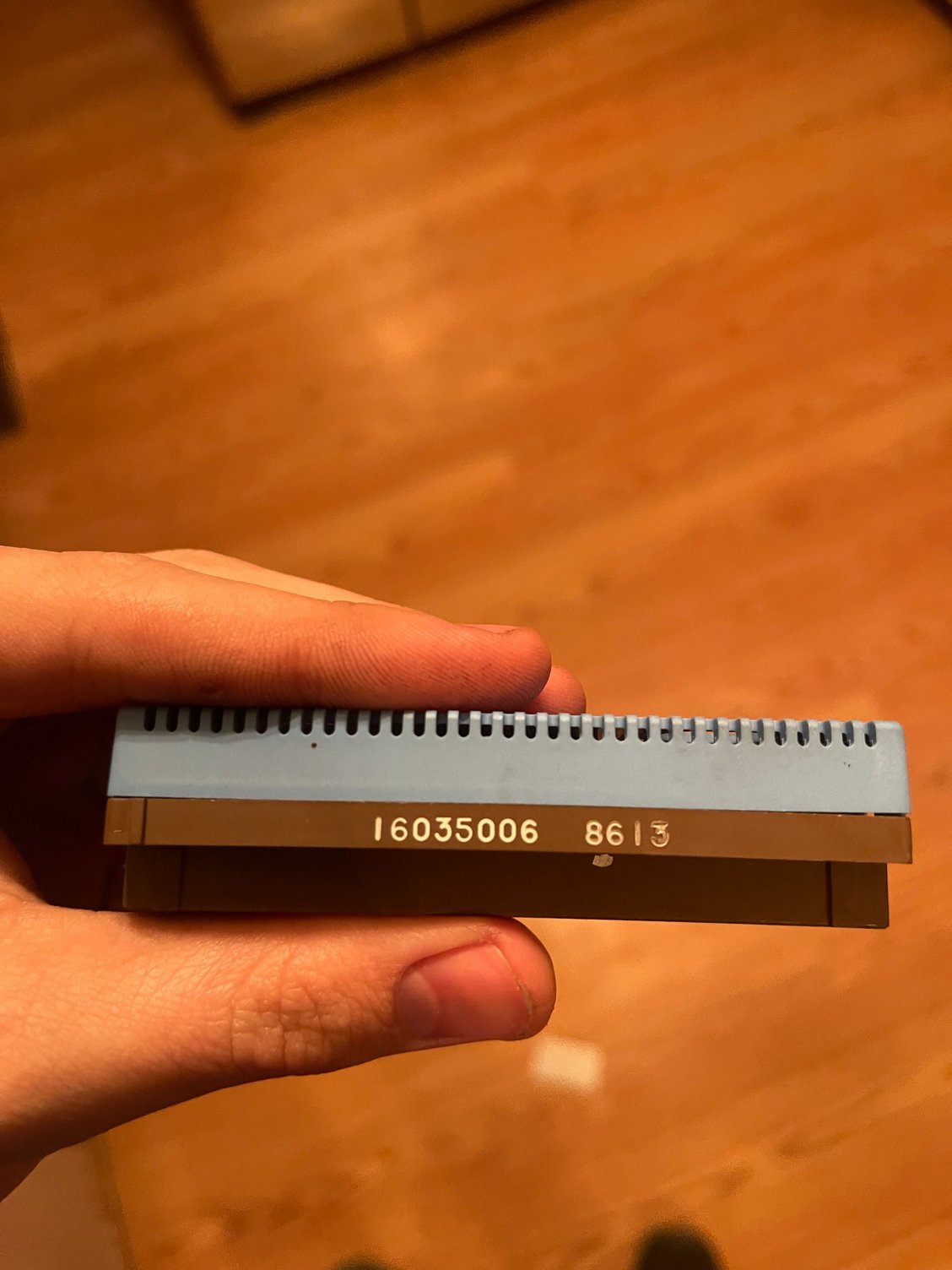

Forgive me, but I’m not to sure what a amu or aum is, I did however grab some photos once I got home

Awc has some service bulletins 86-194 not sure what the issue was
its a nb2 and na5 emissions chip that’s fed and ca requirements. I wouldn’t spend the money on a jets. What issues are you having?

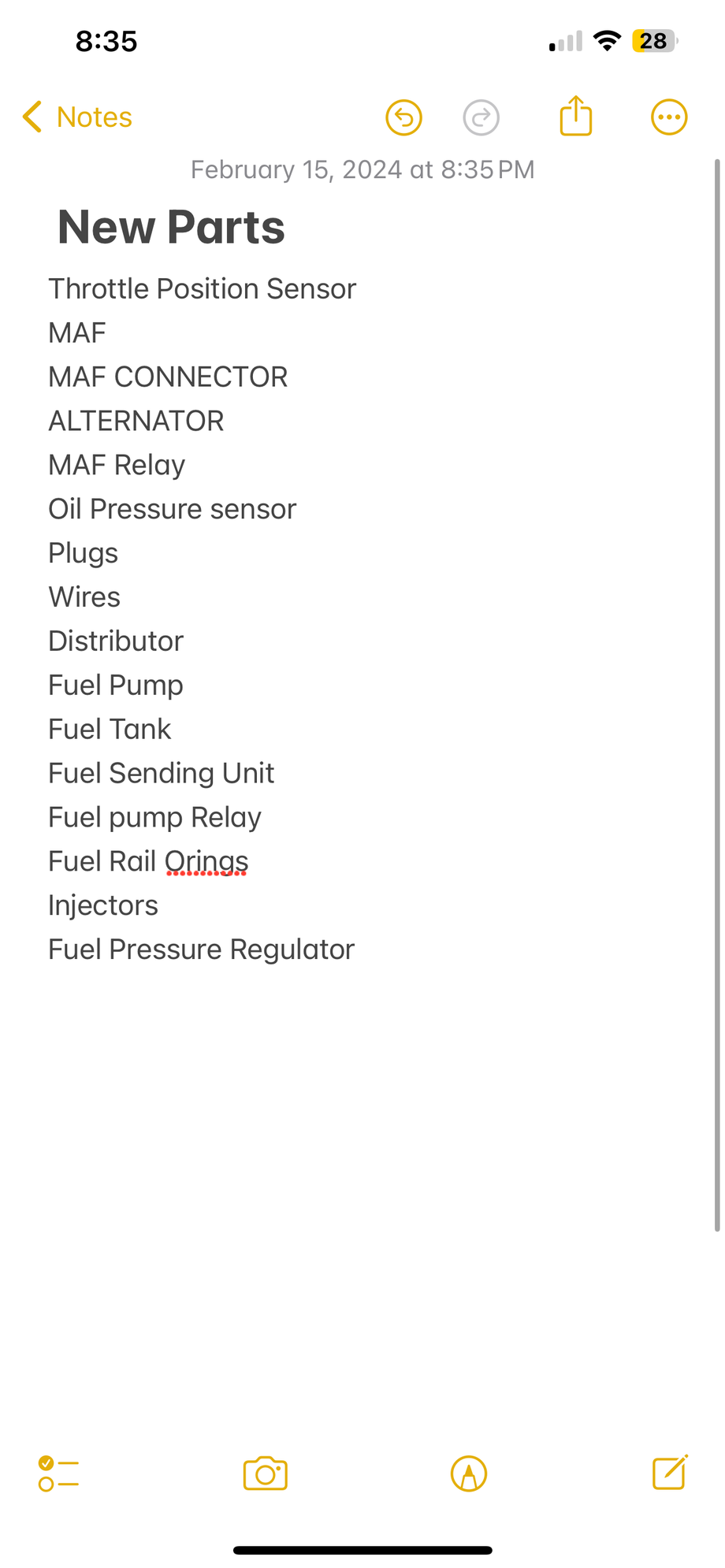

So the car is in a no start condition since I’ve got it, I’ve went through changing multiple parts. I’m at a point where I believe the ECU is the issue. Was not sure if the one in my car was correct or not. And if I could just purchase a preflashed chip or would I need to get a whole ECU and put my old chip in it. I don’t really have a history working with
fuel pressure ?
spark ?
injector pulse when checking with a noid light ?
any stored ecm codes ?
do you have a scanner to see if the ecm is getting a reference pulse ?
