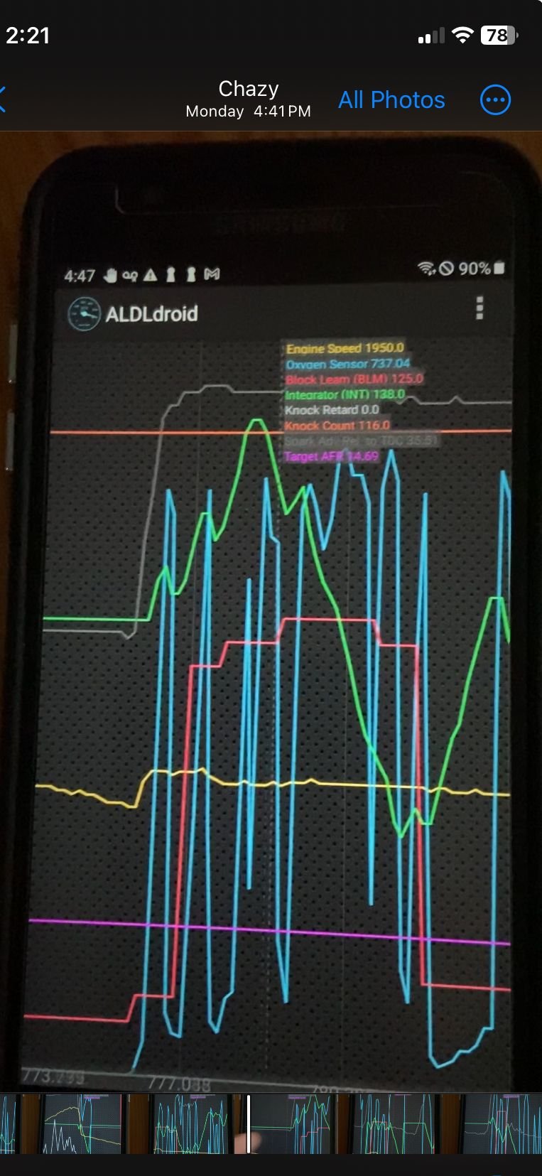

I was reviewing some old data logs and saw that my car had some knock counts and at times was pulling timing at WOT or when accelerating quickly.
I understand some knock counts being present are fine, especially at start up etc and if it pulls a few degrees of timing occasionally not a huge deal but this seems like a problem.
Examples: At start up I would see low teens like 11, engine would warm up and I would drive normally and the knock count would just stay at 11. Then if you accelerate quckly(up to 4500 rpm give or take) or WOT knock counts would go up to 30, pull up to 9 degrees timing, resume normal driving no knock retard but counts still 30 and not moving. Accelerate quickly again knocks hit 116, pulls timing again, resume normal driving knock stay at 112 until shut down.
What I thought was odd was the knock counts never went away or really moved while data streaming? They would only go up and never down even when rpm was normal/low? I also did a data log while the engine was in park and at 3000 or more rpm’s ( didn’t want to rev too high as it was unloaded) and I had no knock retard or knock counts above the typical low teens present at start up that never went away.
Before I dig too deep I have a new knock sensor on the way as the one on there looks original or I’m thinking false knocks somewhere.
Base timing is 6 BTDC and had had the same results at 8 BTDC. Fuel pressure is set to 48psi on AFPR. I have pulled a few plugs and they look fine with no signs of detonation.
I tried adding the whole video of my data log but it wouldn’t work, here are a few screen shots:
Normal driving, at beginning or drive.
Normal Cruising after WOT.
WOT or close to it.
Idle before shut down.

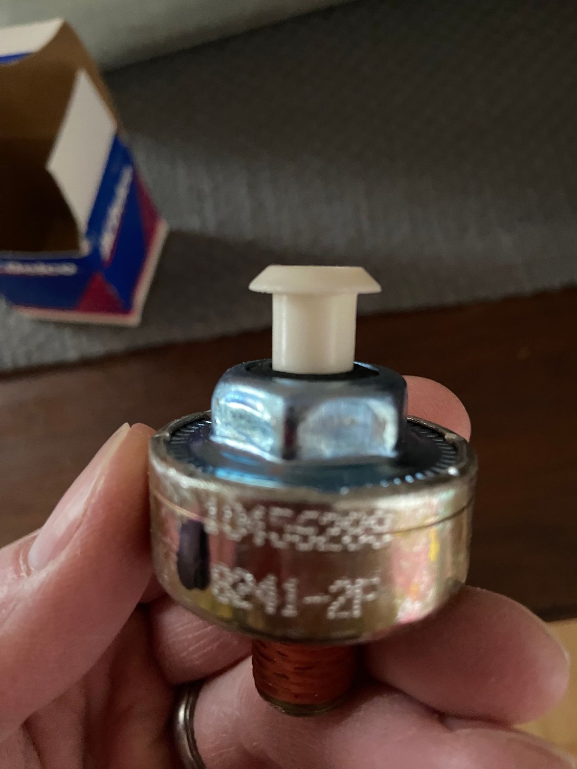

I replaced the old knock sensor, looked to be original and I was surprised it didn’t fight me more. All I had to do was use some PB blaster and it broke loose, I was easy on it as I didn’t want it to separate or strip out. I barely lost any coolant as well, it was tight putting the new one in but I got it and torqued it down to 12ft lbs.
Spec is 15 ft lbs but I read a few threads where Rbob (pretty serious contributor in EPROM stuff) recommended as low as 11ft lbs to help with over sensitive knock detection so hopefully 12 does the trick. Weather permitting in about month in a half I will be able to get it back on the road and run some data scans to see if my knock retard at WOT is taken care of.
Looks crusty
Still made in Mexico like the new ones but I like NOS for sensors when I can find them.

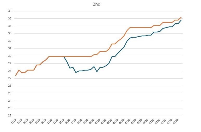

For analysis, you might want to look at the knock retard (KR). I like using a chart. Every time KR goes up, it's an indication of knock detection. Knock count (KC) could stay still but KR could go up. So KC is not as accurate as KR to detect knock event. There is a thread on that on TGO. There is also good information on TGO, don't remember who, who did some testing with knock. I did my own testing with stock LB9 as well. In both our cases, it was impossible to eliminate KC. It's also quite hard to discern between real knock and false knock.
Bottom line, we shot for "Net SA". Means, trying to minimize knock event and KR to get maximum average SA over RPM range. A knock event that triggers 8* of KR could linger for a few seconds during WOT even if no other knock events are detected. That ends-up pulling timing a lot. To do so, you have to look at:
Knock Attack Rate vs RPM
Knock Recovery Rate vs RPM
Maximum KR in PE
Maximum KR
If you have a '7730 with $8D, you also have to disable Low Octane Knock Routine
Even by pulling as much as 10* of timing across the board (see test#4 below), we still got knock events! We did lose power and throttle response.
Here's a summary of testing with a stock LB9 on $6E, rolling WOT runs on 2nd and 3rd (MT) on 3.08 rear gear. No testing was done on 4th gear as it would have yield way too much speed for public highways.
1) As is, from original owner after sitting in a garage for a long time:
2nd Gear
CT: 200Deg.F.
MAT: 120Deg.F. (heat soaked)
A: 30mp/h to 63mph in 4.8sec
B: 35mph to 63mph in 4.4sec
A: Avg SA 31.4*, Avg Net SA 30.4*, 4 knock events, -0.9* avg KR, Max KR -2.3*
B: Avg SA 31.5*, Avg Net SA 28.9*, 6 knock events, -2.6 avg KR, Max KR -3.7*
A: Chart of commanded SA (ORG) vs Net SA (BLU). Net SA is Commanded SA minus KR.

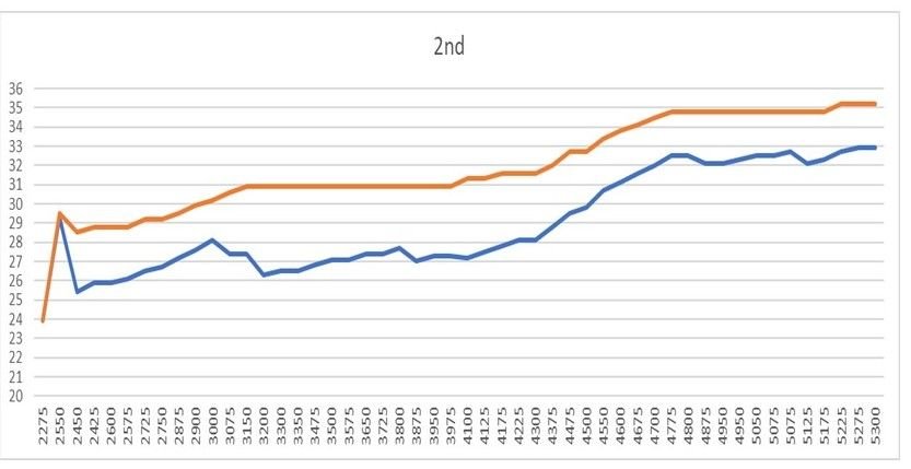

2) With tune-up:
2nd Gear
CT: 187Deg.F.
MAT: 86Deg.F.
A: 30mp/h to 63mph in 4.5sec
B: 35mph to 63mph in 4.0sec
A&B: Avg SA 31.8*, Avg Net SA 28.9*, 12 knock events, -2.9* avg KR, Max KR -4.6*
A&B: Chart of commanded SA (ORG) vs Net SA (BLU). Net SA is Commanded SA minus KR.
