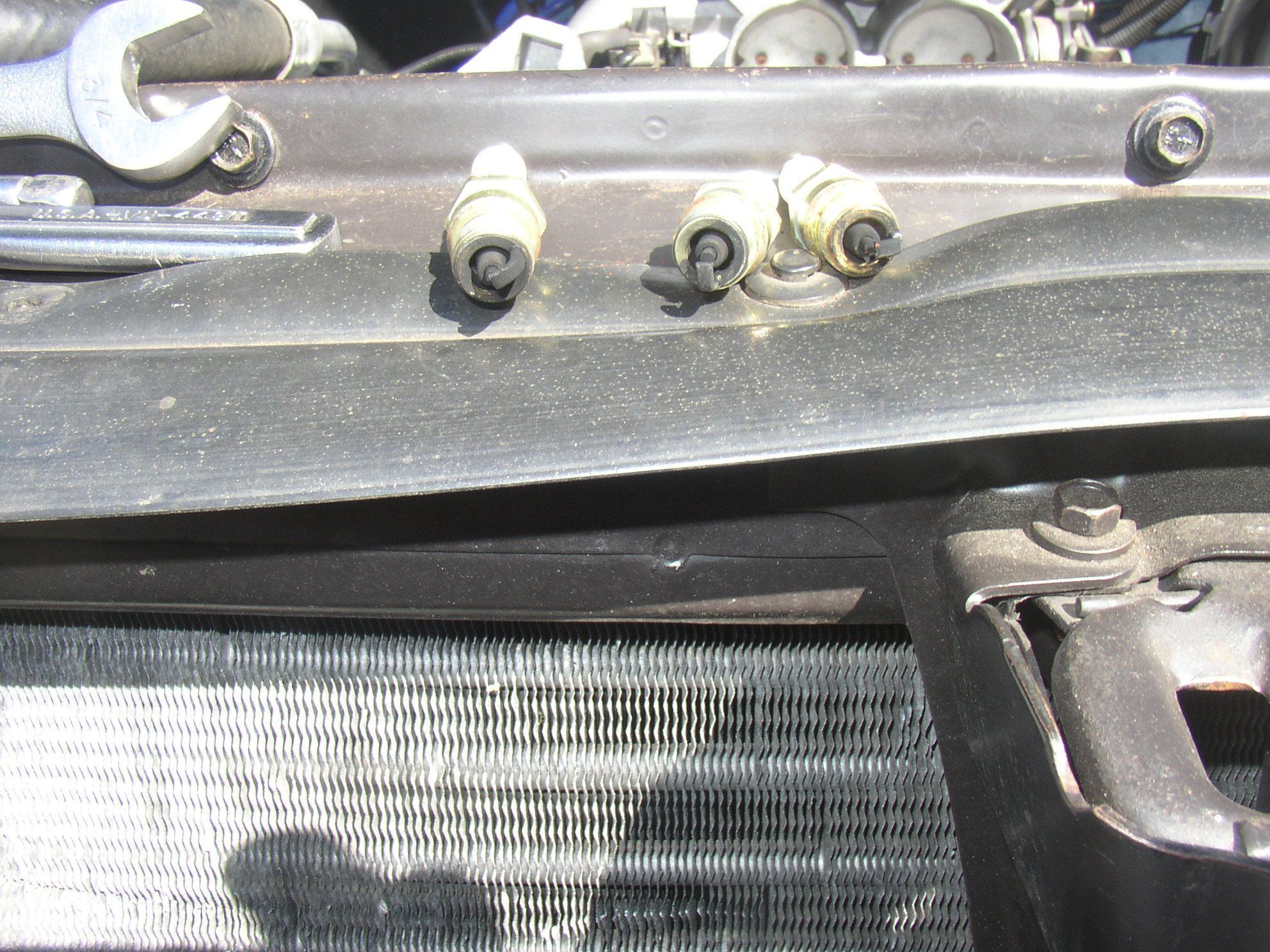

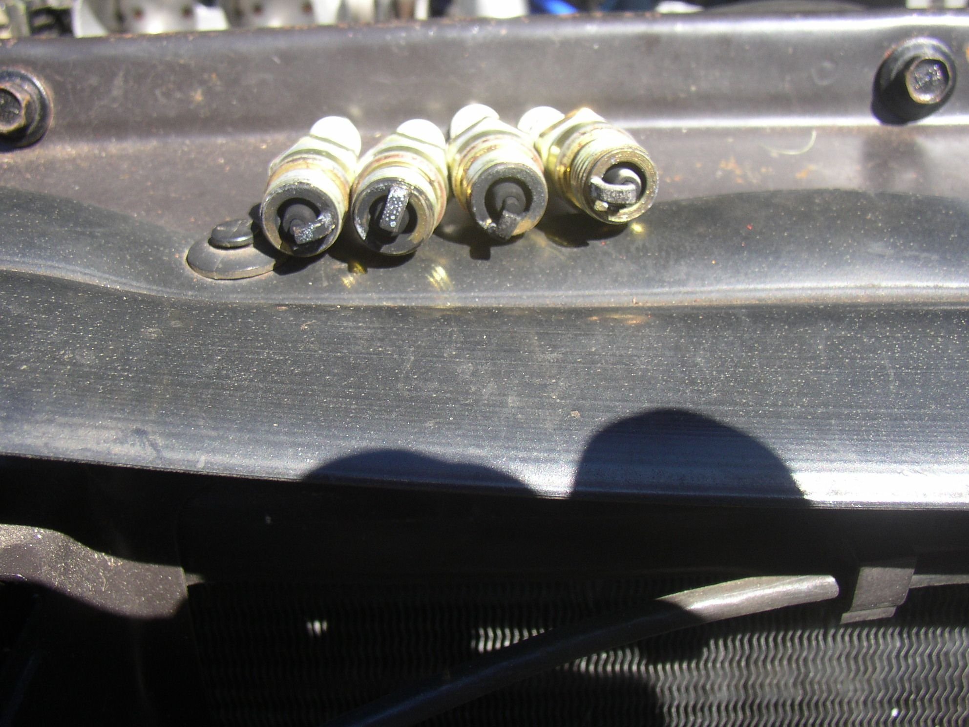

Here is a picture of them. As looking at them, left to right #8, #4, #2, #1, #3, #5, #7.
I tried to get better pictures, but my camara works when It wants to, and it doesn't want to right now! Again!
I'm thinking it's the chip, no matter what I do, it doesn't change the way it runs. It will only run 30-45 seconds at best.
Any ideas as to what to do?
Thanks, Pat

Originally Posted by Fred SS
Is it possible the injectors you have are larger than 22-24 lb/hr?
Fred
I’d be glad to read the chip and look at the file installed . But the overfueling sounds like it’s caused by something else. Btw does this have a stock or aftermarket camshaft.

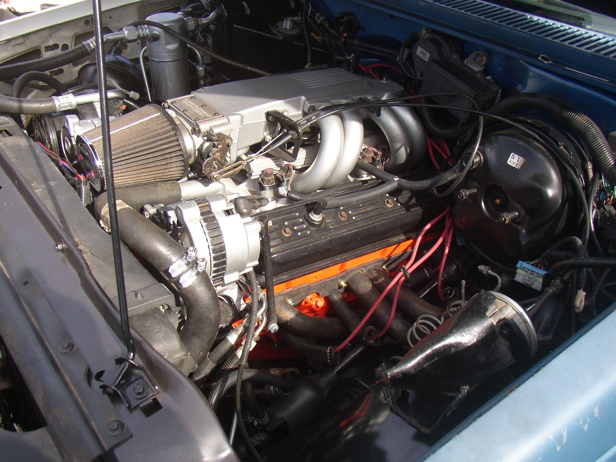

TCoupe, I pray that your wife recovers from her stroke. I know what you are going thru.
In the first picture you posted, you show the DS of the engine. I see that you have the PCV hooked to the vacuum line from the brake booster via a "T" fitting then going into the vacuum fitting between the #3 & #5 runners. There is a large vacuum fitting on the DS rear on the plenum, behind the #7 runner. Do you have anything hooked up there or is it plugged? I have my brake booster hooked to the vacuum line behind #7 runner on the plenum. I believe that is the correct routing on an F-body. If that fitting is open, you have a large vacuum leak and the motor may not want to idle.
Fred

Of course, My truck went down for the weekend! My cat plugged Friday afternoon, and by the time I got it off, ( Had to tac it, and then remove the crossover to weld it. Arrr. I found out I was out of gas on my welded! I'm never out. So, I had to dig out my stick welder and remember how to stick weld again! Good thing I have 3/32 rods. lol I got it, but it's not pretty at one end.
One thing I forgot to say before is, that when I pulled the plugs, the cylinders were giving off a strong gas smell. I put it all back together and had a guy stop by and help me. The best we could get was a short 10-15 second rich runs. He pulled the dipstick out and there's gas in the oil, enough to have to change it. It's flooding the motor.
The only thing I can thing it is, is the ecu/chip. I have checked everything else out, as being good. It's getting to much fuel somehow. I've Opened up and checked the fuel regulator, and it looks good.
Anyone have any other idea's to check out?
