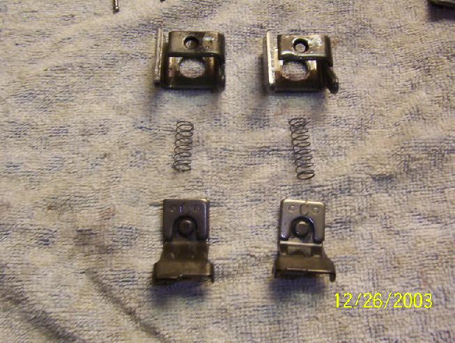

I was having trouble getting a good picture of the weights, so I just went ahead and took it apart. As you can see, C weights are on each side. One side has a heavier spring than the other. Thanks!

Old Dec 27, 2003 | 02:02 PM
Pro Built Automatics's Avatar
Posts: 3,484
Likes: 56
From: Calimesa, California, U.S.
Go to the weights that have the point on them, and see where this puts you. Then if this is not enough, use the weight that is completely flat with no point and rework it so that it has a smaller point than the one you started with, this will make the shifts at WOT later yet. You will have to experiment. The springs help fine tune it, but is mostly for part throttle. I hope this helps.
