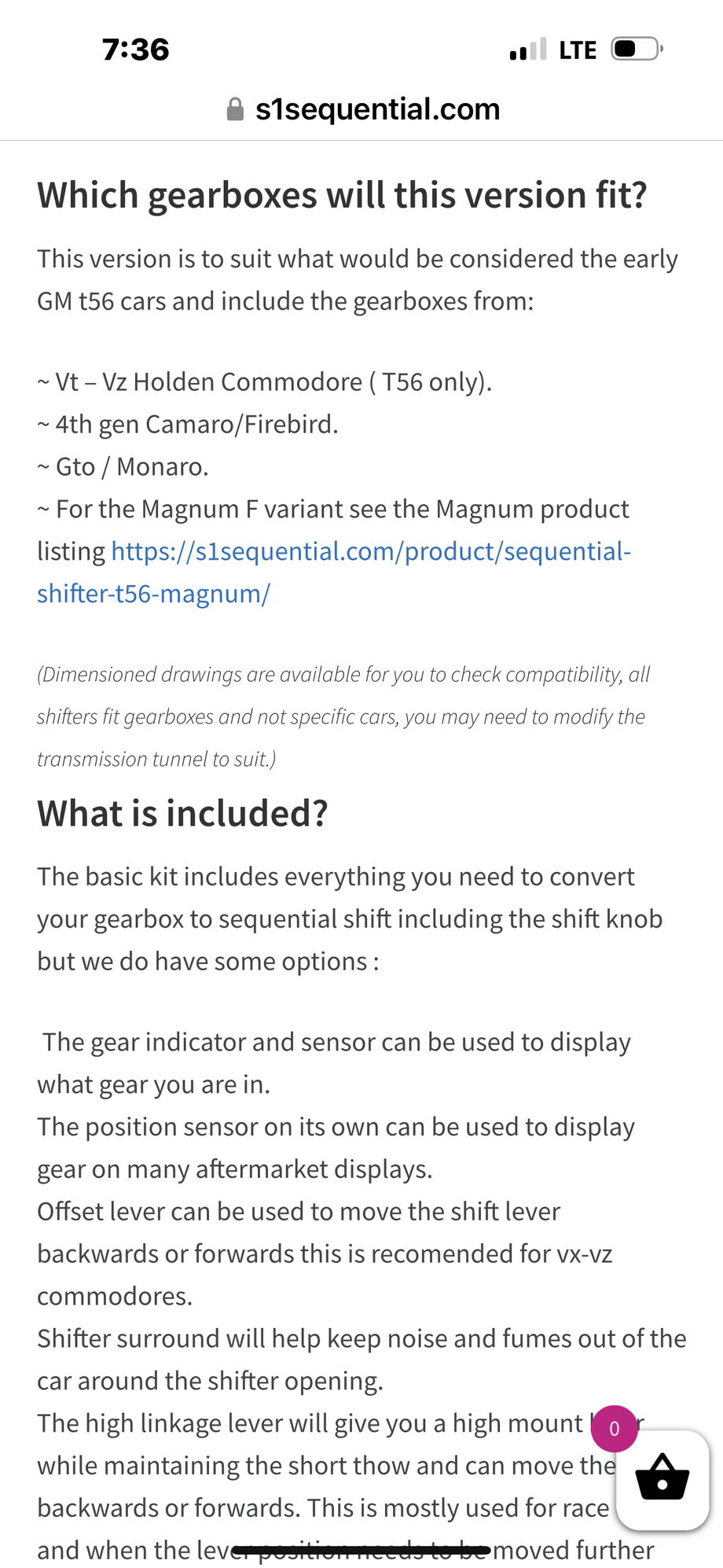

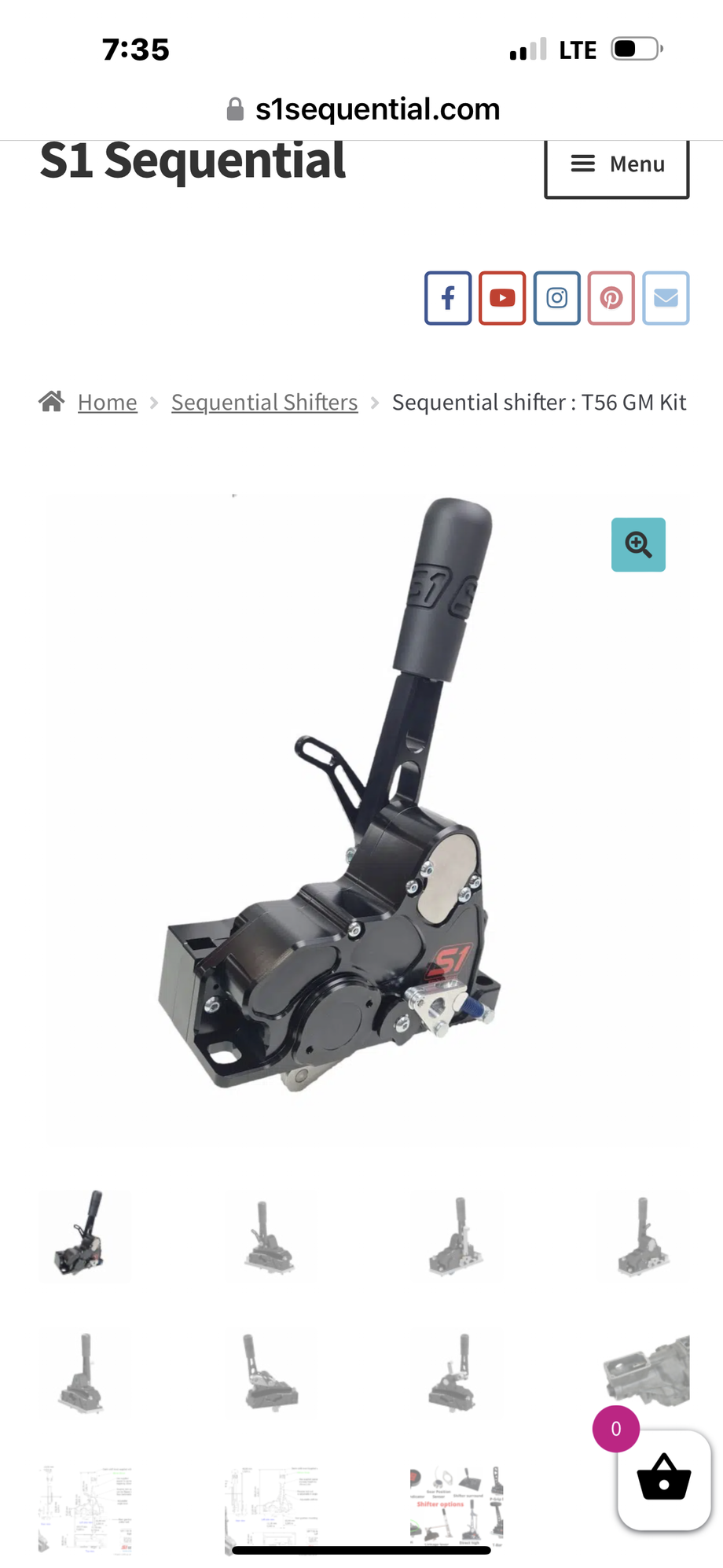

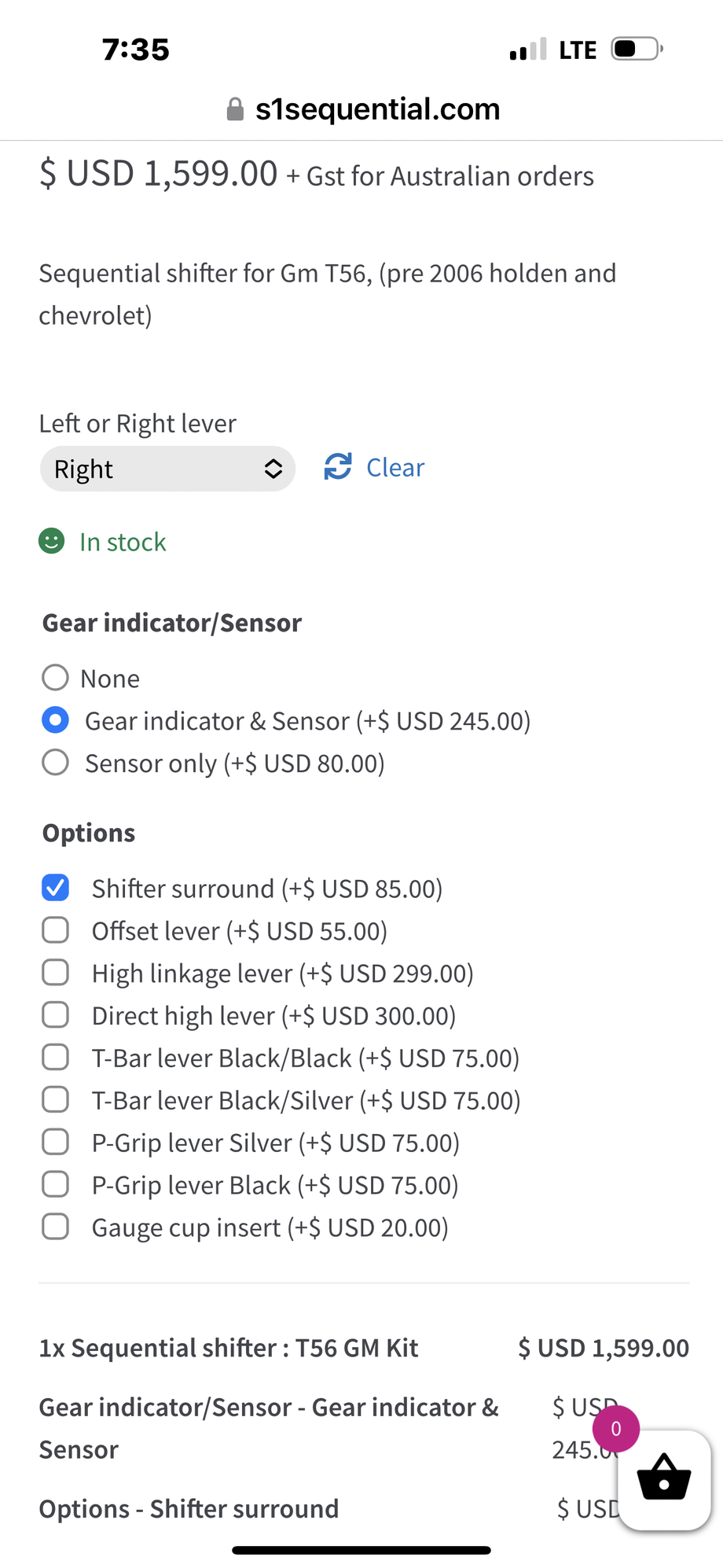

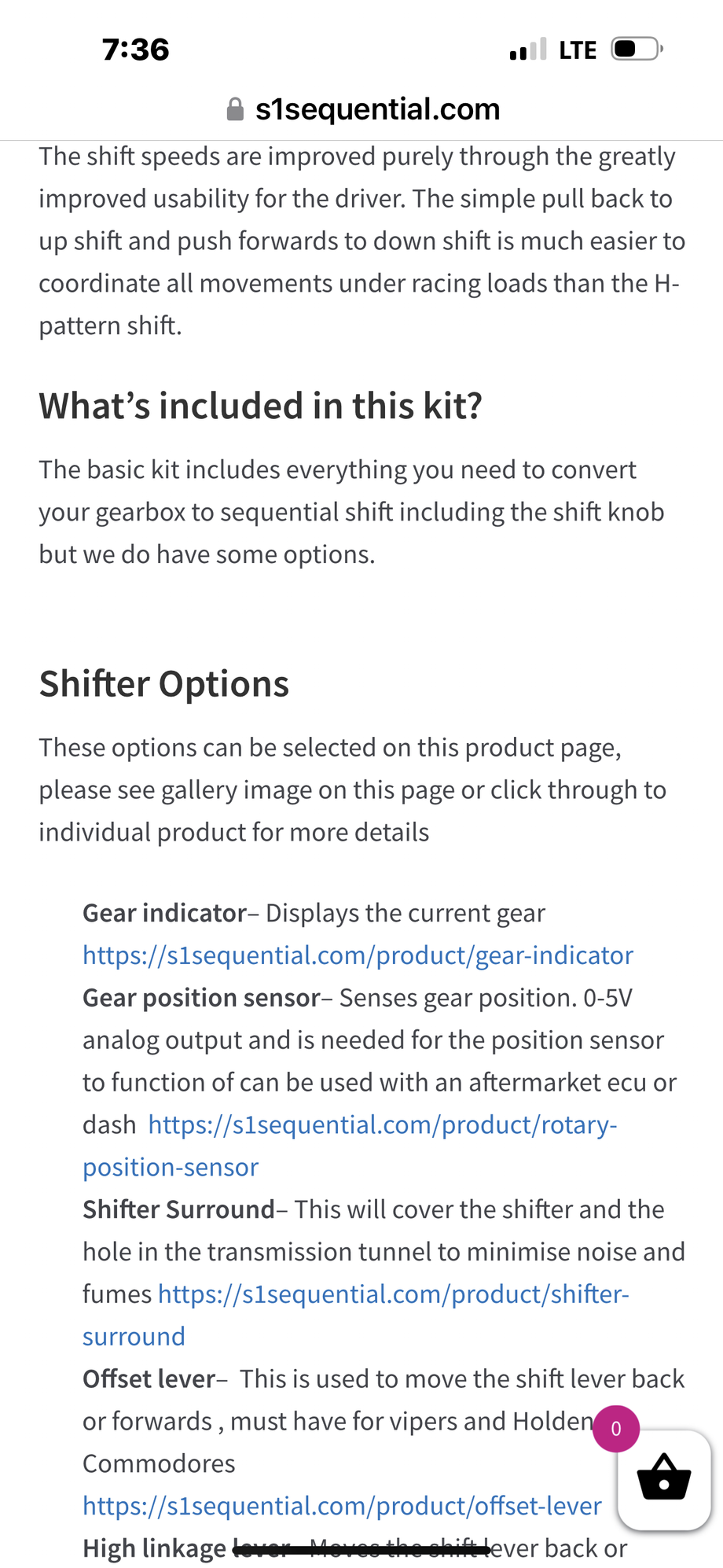

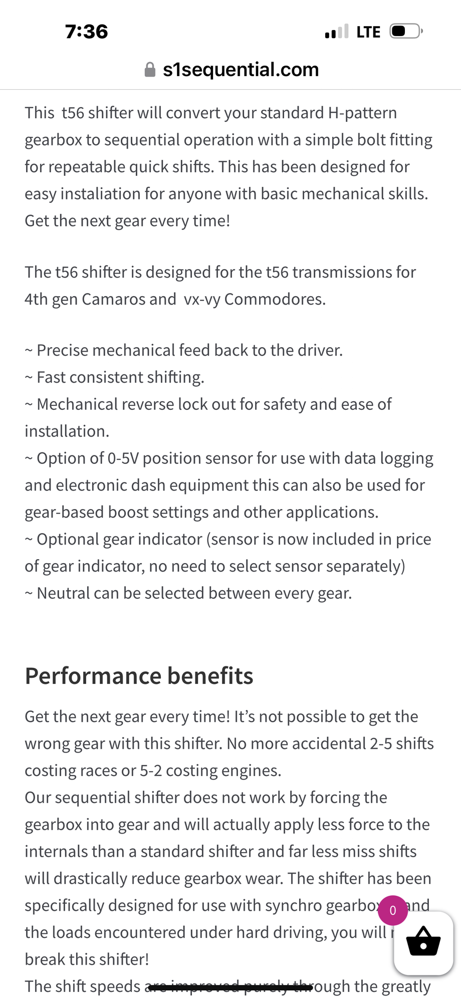

Here I go again reviving these almost dead threads lol, S1 makes a sequential shifter for many different T56’s you still need to use a clutch to shift if your transmission is stock geared. But at the price of probably 2 grand after being shipped from Australia you got something you can still drive on the street and road race pretty competitively. A real sequential gearbox is definitely no less than $25,000.
https://s1sequential.com/product/seq...aa08ffebfa06f6

You missed the mark of what I said, the shifter is only a fwd and reverse shift pattern.

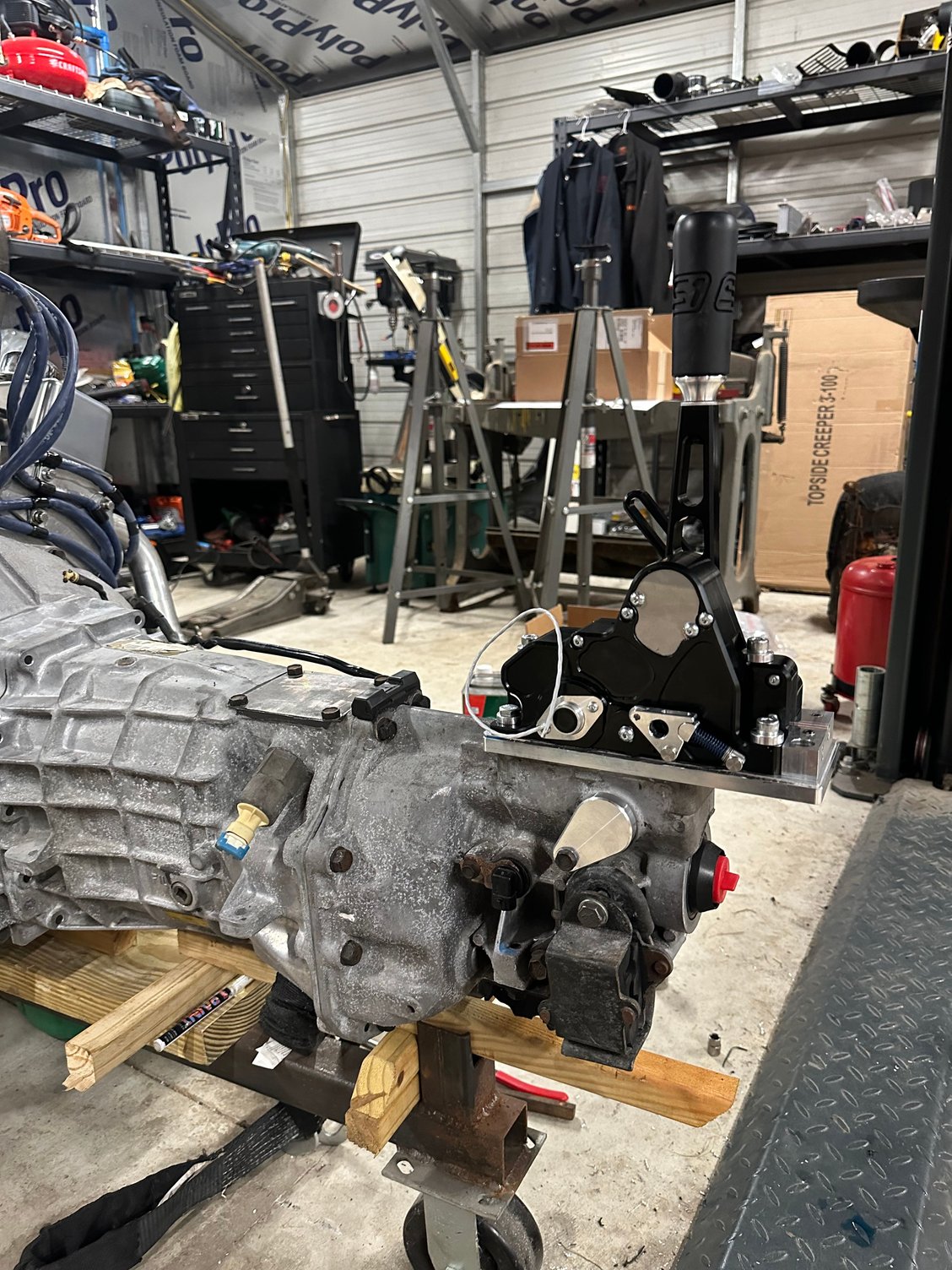

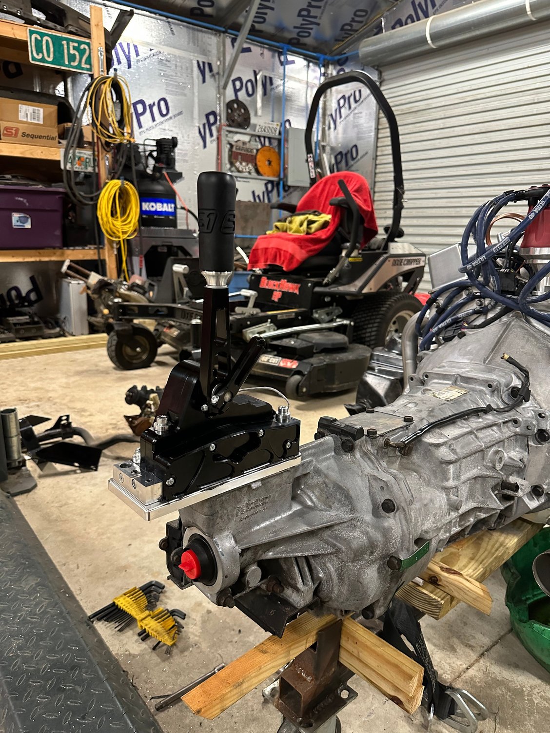

Pretty easy to install mine didn’t have instructions, but there are videos. Just all are videoed by Aussies, so poor instructions but you will get the jist.
