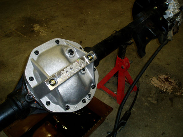

ta performance makes aluminum girdles for them and has for a couple of years now!!!

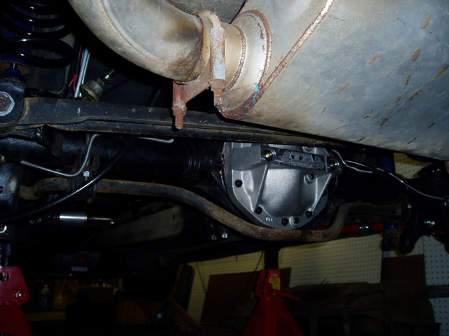

Yep, TA sure does make them, I got one of the first ones, and here's the proof!
It's a very nicely machined piece and definitely worth the price, I'd recommend getting the stud kit with it also for added strength!
-Paul

TA does make them. I have one on my car as well. Now if only someone made gears for the thing. The only ratio available anywhere is 3.73 (I really looked around). My gears howl like no other and it's annoying the hell out of me. Everything's been pulled/reinstalled a few times. Nice tooth pattern, good backlash, etc. There's just a very small blemish on every single tooth in the exact same spot (slightly indented line from a dirty carbide bit). I guess that's enough to make the whole thing whine like no other on part throttle.
