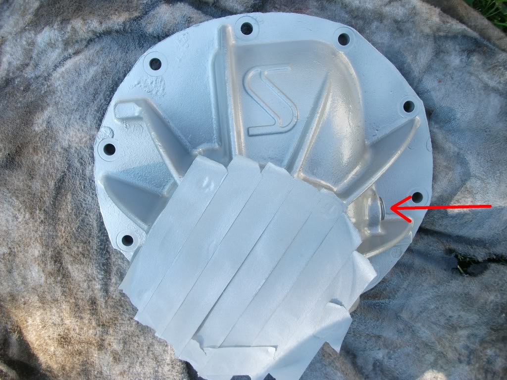

I'm doing exactly that with my Currie housing. I'll be attaching the magnet to it too so that you can remove the magnet without removing the center section. I think that's the best solution because you always want to clean the magnet if you're changing your fluid.
Here's where Strange puts the fill plug in their center sections:

That first picture is where I have the fill plug installed on my 9". I've also seen them mounted right on the top however my wishbone mount is on the top so I had no room. Even mounted on the top sides will work. You still use the factory fill port on the side of the case to measure the level.
As for a drain plug, drill and tap a 3/8" NPT hole in the bottom and install a pipe plug that uses a square drive or allen key to remove it.
