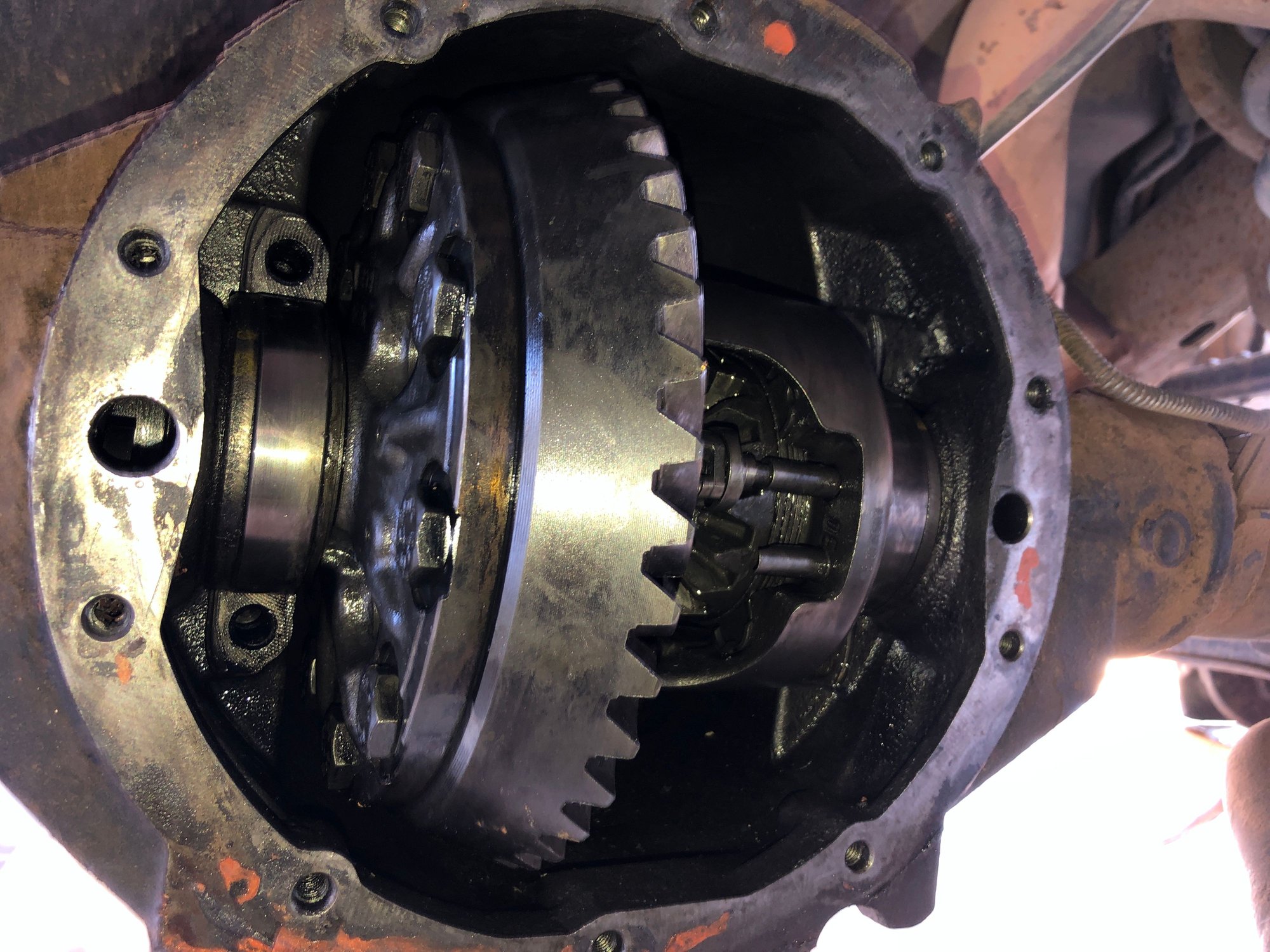

I assume you got it out. Did you in fact use a crowbar or did you end up hammering the pinion? Trying to get the Carrier out of a ‘04 Suburban and it just won’t come out with various sizes of crowbars.

I usually take a medium pry bar and put it behind one of the ring gear bolts and carefully lever on the housing (sometimes with a piece of wood at the fulcrum so it doesn't mar the machine surface) to get the carrier to pop out
Thats what I was thinking. I have a small pry bar and a oversized one, so I’ll have to go find a medium sized one. Thank you

The long one should work, unless it's just too long to use in your situation. Try the short one first like I suggested, it shouldn't take too TOO much like I just said before it pops out.

Thats what I was thinking. Watching other people do it and all it seemed to either roll out or just take a quick pry. I spent three hours trying to figure out how to get it out and it hardly budged. The big one works, but I have a hard time getting leverage since it's like 3ft.
