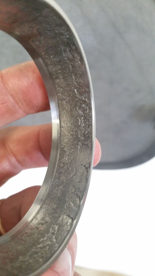

Ok thanks guys I tore her all down tonight with the help of my 19 month old. Looks like the carrier bearing race on the non ring side is shot. I was planning on doing all new seals and bearings anyway just need a slide hammer and the bearing seating tools.
Opposite side of ring gear, carrier bearing race

Wow...THAT was making some noise.

The guy I bought it from said he never ran it and didn't want to take the time to pull the cover to see what was in it. My take was he ran it and sounded like a mess so he didn't want to bother with it. The carrier looks great with little to no signs of wear but that race was shot. Other bearings and races looked fine with no pitting and smooth as glass.
