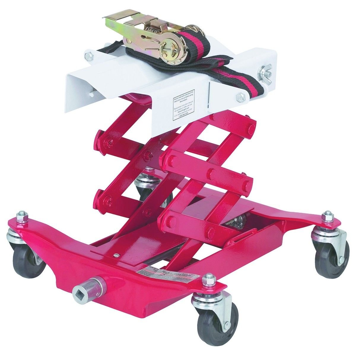

It's 75-80mph speed limit where I am and traffic goes ~80 so I go back and fourth on if I should swap to 4.11. You are right that with the 3.45 starting out does take some clutch, it may burn the clutch or cause a shortened clutch life if you do lots of aggressive street driving.
This is a great and inexpensive tool for transmission installs, I've used it a bunch for my T56:
https://www.harborfreight.com/automo...ack-39178.html

Am I the only one that can never get a thirdgen high enough off the ground to get a transmission jack with a transmission on top of it, to slide out from under the car? Ended up having to slide the transmission off the jack and removing them separately.
