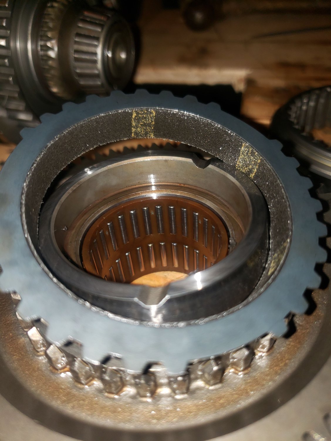

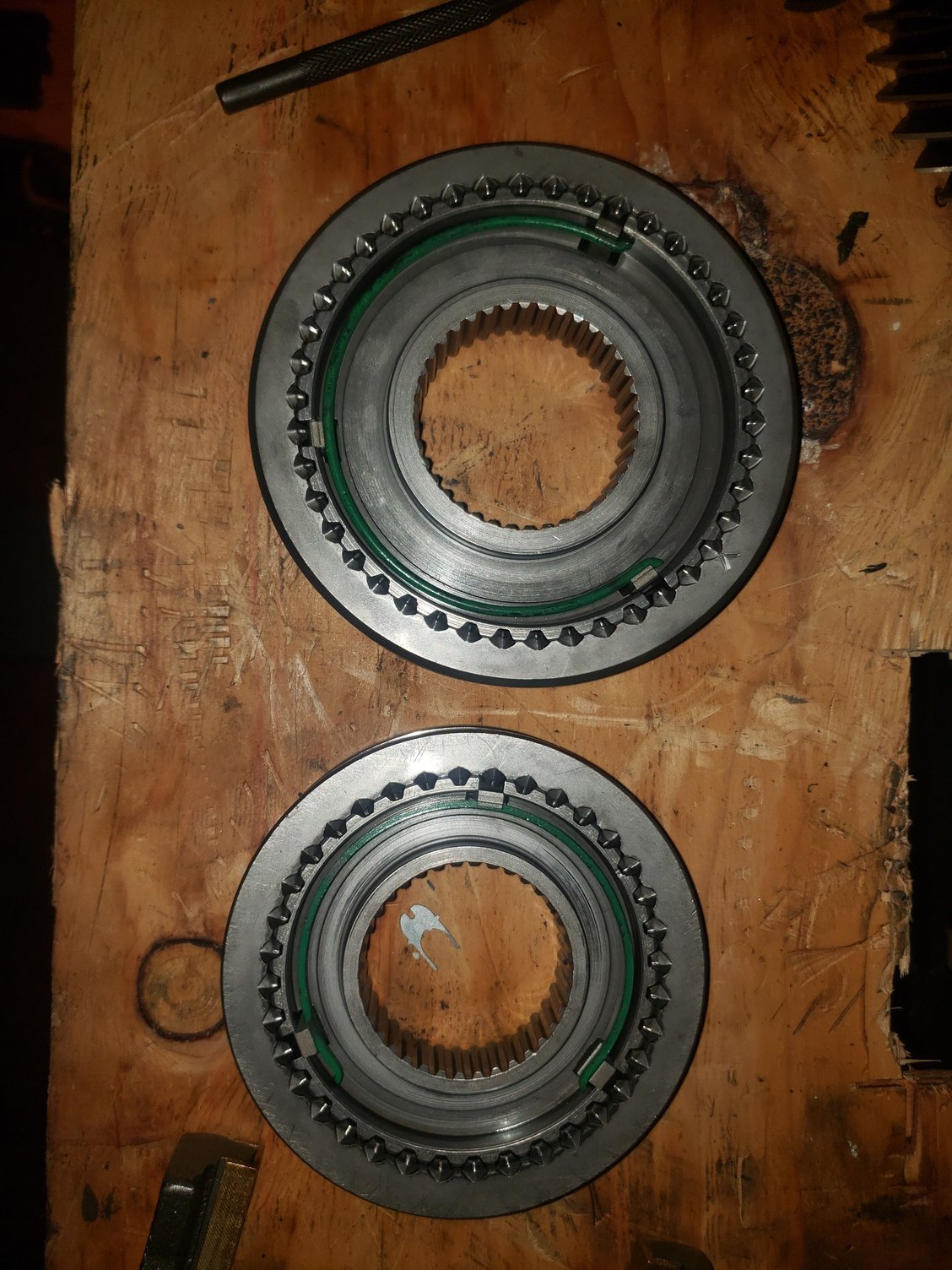

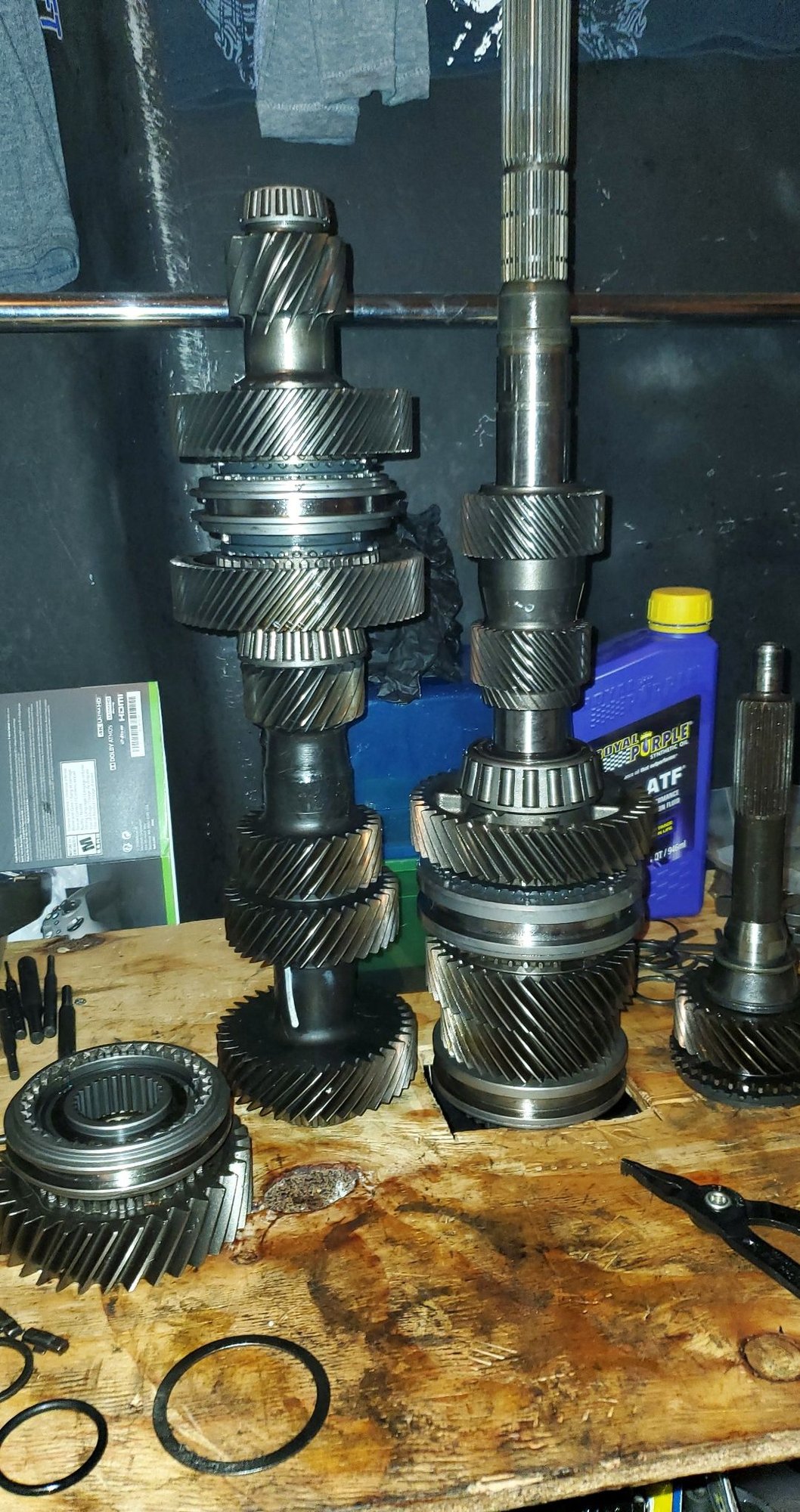

Back again! The trans is all a part. No gears or bearings pulled. My mistery bearing cage piece isn't from any of the bearings in the trans. Everything looks good. I got a picture of a synchro ring. Don't know if carbon fiber or OEM stuff. I am worried about this discoloration on what I think is the 5 and 6 gear part of the shaft. And this brass washer thing that bent out of shape. But it's super thin brass.
So here are more pictures.

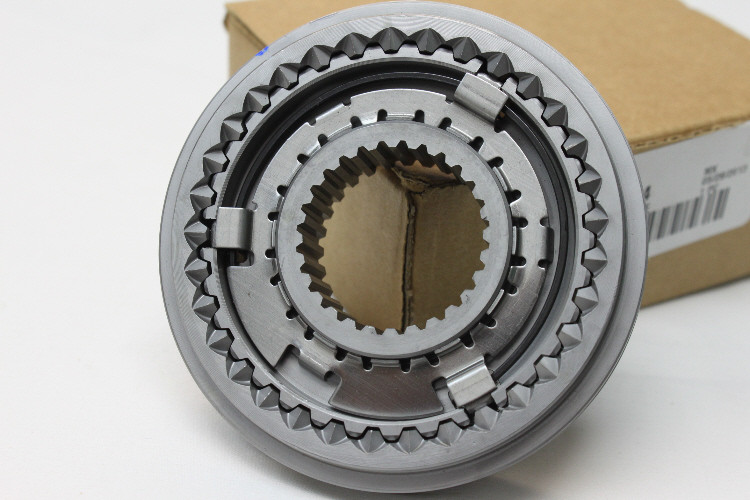

Well, it appears to be a 1993 box, but with carbon blocker on 3-4, so it's been gone through before. Probably close to 20 years ago based on the earlier design fork pads. Your 3-4 fork is still aluminum - those wear at the shift rail; just get a new one.
OEM carbon started in F-bodies 2000 or so. And it's all that was around until a few years back.
I don't see the 5-6 gear location on the mainshaft in your pictures. But it is very common for the inside of the 5-6 cluster gear to create a rust-looking condition inside between it and the mainshaft. Don't worry about the color. Do measure the cluster gear and mainshaft where it fits. OEM gears started at like 1.998" on a 2.000" shaft interference and they eventually loosen up. There are a few ways to correct that problem, but you might run it for a little bit for a shakedown before worrying about it. Depending on your plans.
Sweet! Already have carbon blockers. I guess safe to say its got them all around. I dont wanna pull apart anymore bearings or gears. Everything looks good. Can I measure clearance between other blockers to see how good they are? I know my 9 bolt you could use some of those flat metal shims to measure how much life the cones had in that. Can that be done with the T56?? And you mean replace the rail or fork? Or both? I haven't removed forks yet. So about 20 years ago this thing was taken apart. Guess good news and bad news. Recommend going to the newer style fork pads are these good to go??
I've already found out I have the loose 5th and 6th. I know I have to send out the shaft to get material welded on and then taken off for a better fit. That always might mean I gotta remove the gears and bearings I wanna keep on the trans. And other ways to fix it? I can slip the gear on. And then give it a nice tug it will pop right off. Can see wear on spines that hold the gear in place. Notbing major. Just shiny.

Replace the 3-4 fork.
Measure the mainshaft and cluster gear in the smooth surfaces (6th gear end) before you invest time getting the shaft welded. Splines showing "shiny" but not worn away is a good sign the weld will work. Talk to a shop that does this for T56s and see if one or both parts are needed before investing time and money. The weld really is the way to go if it applies to your parts.
And if you do go ahead with a new cluster gear, you might even want to consider using 94-02 5th / 6th gears. More $ for the gears but that gives you C5 Z06 / GTO 5th and 6th gear ratios.
Getting the gears off without a press is possible.
Feeler gauge measurement of synchro blockers on the single ring (3-4, 5-6) is possible, but carbon changes the characteristics of how it's done. If they bottom out / zero gap on the gear when the carbon has been ATF soaked, they're bad.

Your blocker ring in post #18 is carbon.

One of my synchronizers has this metal retaining plate for the ring that holds the keys. I can't seem to get the thing on correctly. Is there a specific way it gets put on?

Re: 1993 T56 Hydraulic TB bearing conversion
Dang, didn't realize TDP turned around the main shafts that fast. I should've torn down my trans and sent it out before stabbing it in the car. Got excited/impatient.
It has been a couple years so I can't really remember any difficulties or tricks with the reverse synchro plate. Doesn't it just kinda sit there?

That helps a lot. I have set it wrong. I'll go head and redo it. But yeah! The boys at TDP did a great job the shaft came back way nicer then what I sent them. All the wear and rust markings on that spot they fixed all gone. They had me done in two days. Got it fixed it and shipped it. No skin off my back sending it out. If I have another one. That's who its going to. Now I just need ATF to soak my blockers and some lube for all the synchros and I should be ready for the rebuild. Some of the forks and rods are still in the trans case. Also going to look into painting the trans case and bell housing. My next hurdle is that I really wanted a spohn cross member with a loop and spherical joint. But they are closed down due to this COVID outbreak.

Triple check while you're installing the reverse synchronizer; the stamped backside key retaining plate can slip off the hub a little and become pressed between it and the 5-6 cluster gear. Because you're installing a tight 5-6 cluster gear fit, I mention it.

Alright here is how far I've gotten by the last hour or so. I used all the parts off the main shaft. Nothing extra laying around. Billet keys on 1-4 and using the carbon rings that came with this trans. I did soak them in ATF. But that was a couple weeks ago. The big bearing above 1st gear need some love before it went into place. It slide right off during disassembly. I got most of everything on. 5 and 6 cluster needs to be pressed but the boys at TDP told me to use some loctite 648.
Other then that my only worry is that the gears aren't pressed in 100℅ the way in. All snap rights seated and went in without a hitch. Oh and the o ring I'm worried about. It's seated. But I figured it be a almost perfect fit. I also currently can't find my tapered washer for 6th? It sits on the end. I have it around but since it was one of first things to come off I probably didn't see it. Next is reverse and my shift forks. Those still in the case.
