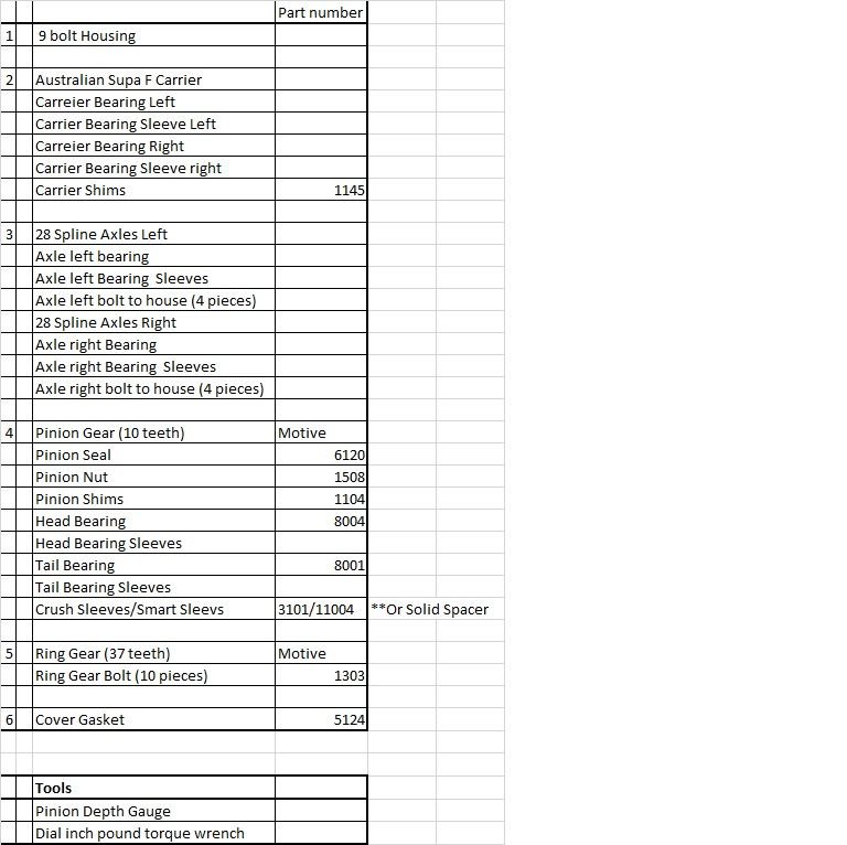

Came up with following unorthodox part list. Any little pieces I am missing?
Old Jan 21, 2020 | 11:34 AM
Sonny_T's Avatar
Joined: Dec 2011
Posts: 188
Car: Transam, 85
Engine: 305 HO, 4bbl Carb, G Engine
Transmission: 5 Speed
Re: Hawks now offering 3:70 gearset for 9 bolt
GD,
Instead of a 'crusher sleeve', is there a 'spacer' for these pinion gear. Concern of crushing the 'crusher sleeve'.
Old Jan 21, 2020 | 01:16 PM
GeneralDisorder's Avatar
Joined: Mar 2017
Posts: 4,255
Likes: 427
From: Portland, OR
I would just get the smart sleeve. They aren't that difficult to crush. I just did it with a 1/2" electric impact. Rattled on it till I hit the preload on my dial torque wrench.
GD
Old Jan 21, 2020 | 03:49 PM
Sonny_T's Avatar
Joined: Dec 2011
Posts: 188
Car: Transam, 85
GD
Did you use any pinion shim (size), and what was the Lb/inch number fro preload in dial torque for crushing.
Old Jan 21, 2020 | 04:08 PM
Joined: Mar 2017
Posts: 4,255
Likes: 427
From: Portland, OR
Pinion shim will be determined when you set pinion depth. I don't remember the pre-load setting - you'll need to look that up.
GD
