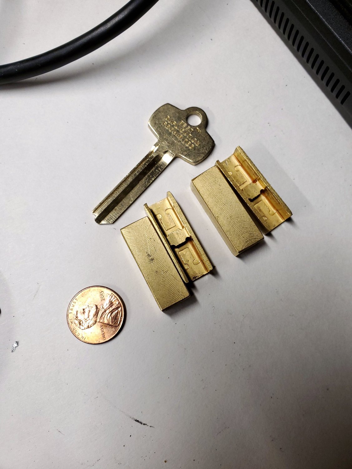

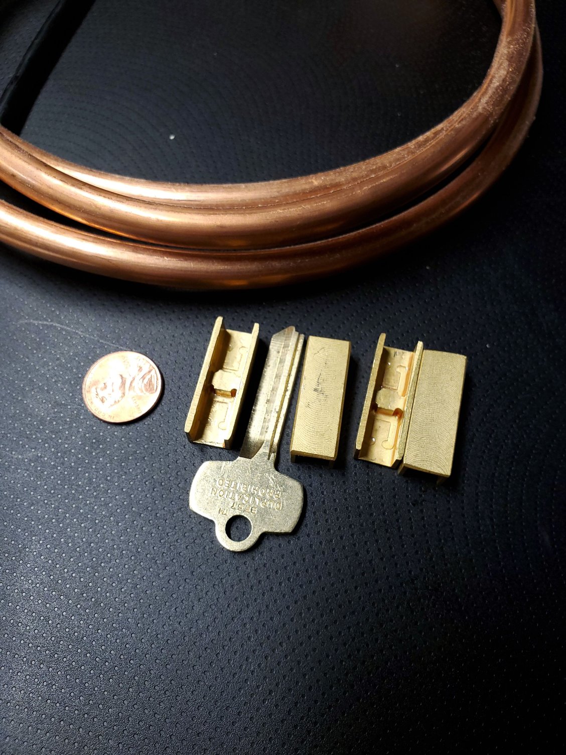

Hey guys. Take a look at the pic. Got these pads from syncrotech sold as "bronze" pads... sure look brass to me! I've heard that bronze is the way to go and that there are alot of brass ones being sold as bronze. Who has the best pads out there?? TDP, tick etc..?? Dont want to stuck brass in there to just have to replace them at 10,000mi. I threw a BEST key and penny in there for color reference. The pads look too similar to gold and not enough red in them..

Not sure what you have there. I bought all my T56 parts from The Gear Box. Everything was OEM quality or better.
They have a pic and there's almost look machined compared to yours look more cast.

So I compared these pads to some new 80/20 bronze guitar strings I had and the color is identical... i thought bronze would be darker, but maybe it's just a different type of bronze that has more copper that is darker.

It's hard to say what those parts are made of with out a cert of some kind. I think I can see mill marks on your parts.
Some bronze is alloyed with aluminum to make them more corrosion resistant and they can look like (color) brass.
http://www.metalreference.com/Forms_Copper_Alloy.html
Just make sure you use the recommended gear lube in the transmission. It might be an old school myth, but used to be that GL5 gear lubes don't play nice with yellow metal.
