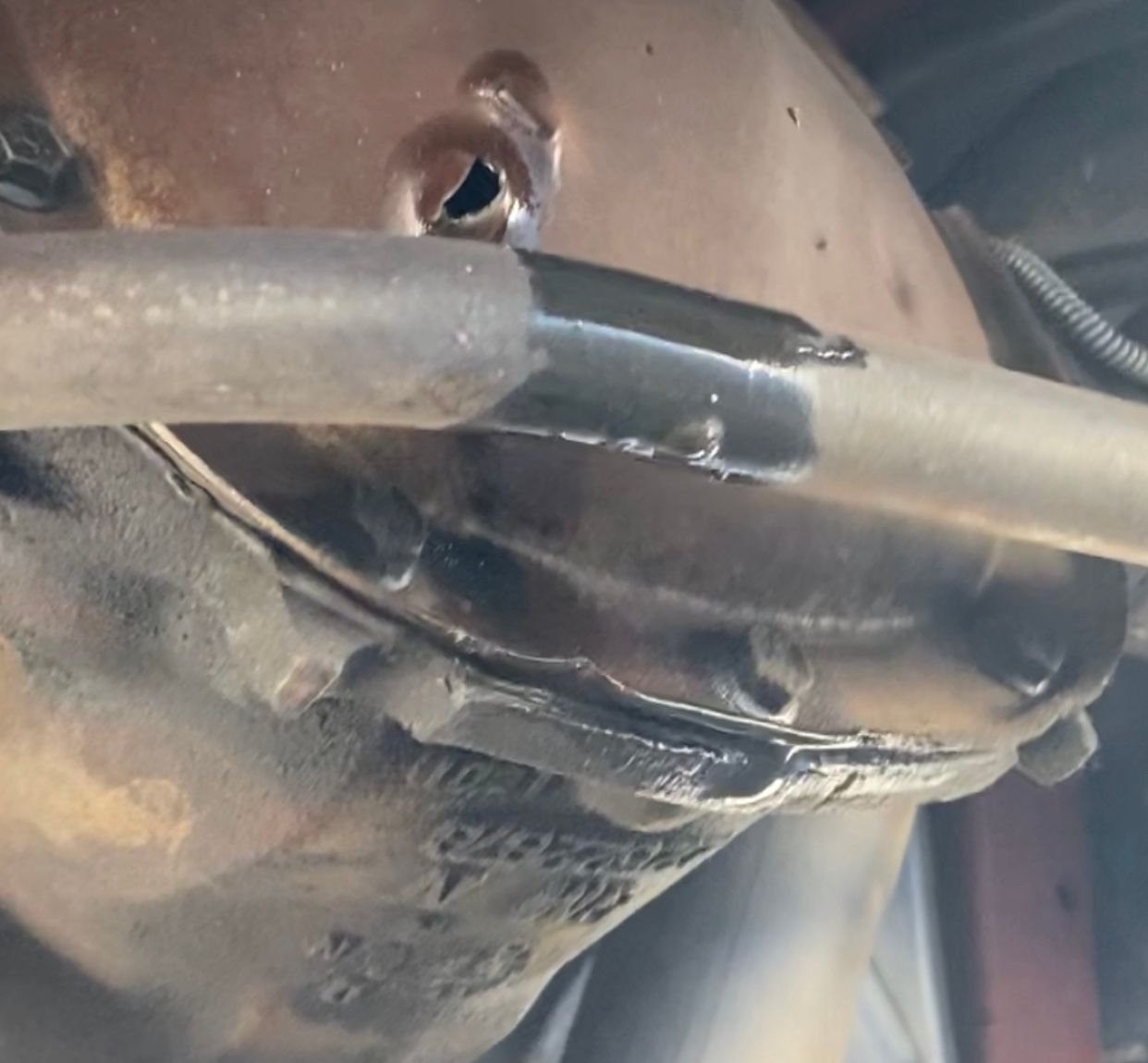

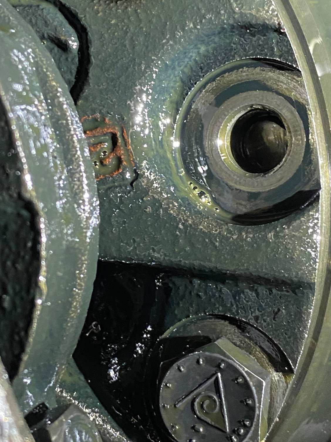

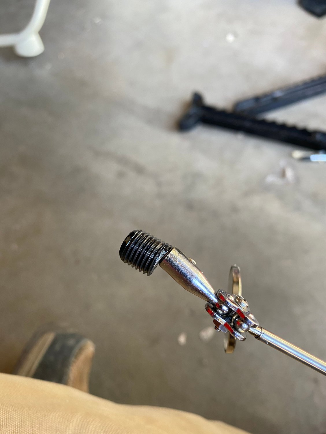

I was coasting to a stop in neutral today and it felt like the clutch engaged a bit. Looked under car to find a puddle of gear oil and a hole in the rear differential cover. Had it towed back to my house to check it. One of the ring gear bolts was sheered off and all the other bolts were loose. I’ve never done any work on rear differentials. The bolt head had about 1/2” of thread left on it. What would the process be to fix it? Here are a few pics.
Hole in cover.
Sheered bolt.
Looked okay except for some gouged on the outer edges where the bolt head got kicked around.
Close up of sheered off bolt.

Someone has been in there are that is a Richmond Gear gear-set. My guess is that they didn't torque the bolts. Best bet is to purchase a new set of bolts and replace them all. Note that they are left hand thread.
Torque spec is 89 ft/lb.

And idea best way to remove the piece of the bolt that is still in there?
Put the carrier on the bench and use a RH twist drill bit. Once it grabs into the bolt it should back the bolt right out since it wasn't galled or seized. You might need a carbide bit to bit into the grade 8/9 bolt

I was able to back the broken bolt out with a pick. As soon as the new bolts arrive (no one in town has them) I can put this thing back together. Thanks for your input, I appreciate it.
I felt like a surgeon removing a bullet from my patient.
