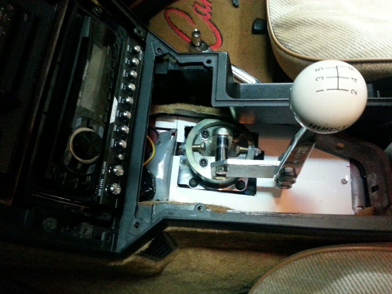

MOST people use a kit that helps realign the trans and bell a little bit for the thirdgen. I can't be overly specific as I did NOT do this. I just ran a Lakewood bell and bolted the TKO right to it. Some have to *cough* MASSAGE the trans tunnel a little!!! I did not, though it was pretty tight. Doing it the way I did puts the shifter slightly up and to the right. I made an adapter to move it back where it belongs. You'll also have to meaure for a custom driveshaft. Honestly though, it really wasn't anything difficult. I bought a UMI trans crossmember too, although I don't remember if it was needed for the TKO, or because my stock one was pretty beat, which it was.

I did a faceplated TKO 600 from libertygear and had no fit issues using a quicktime scattershield. You will have to do an offset shift handle, and id also recommend a hydraulic throw out bearing instead of the stock type slave set up.
Thanks for the pictures. Wasn't aware of the Quicktime option, do you know the part number? Does you shifter placement look similar to Abubaca's? Are you forced to use a hydraulic throwout bearing? I think I'd prefer to use a slave cylinder though.
