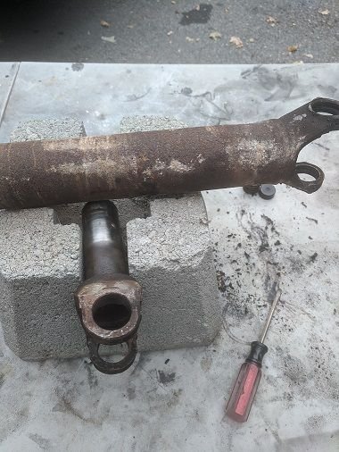

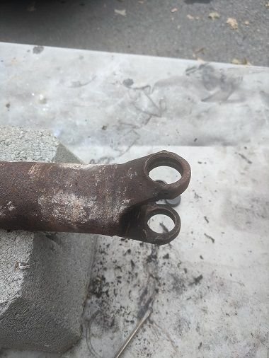

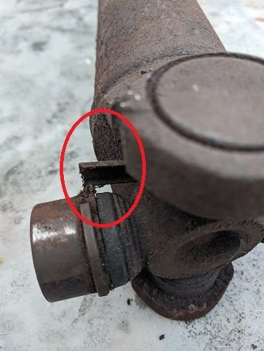

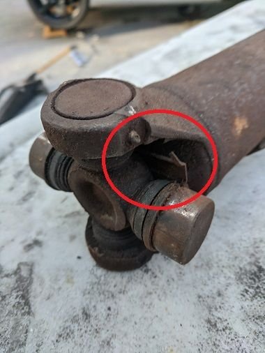

Well I found the scary noise I believe:
Some sort of clip breaking off the u joint. See below
The shaft seemed ok, no play in it, just this metal piece hanging
I had to burn our the plastic pins. So they are original 31 years old. Burn out was pretty easy. But I cant get this stupid thing to press out.

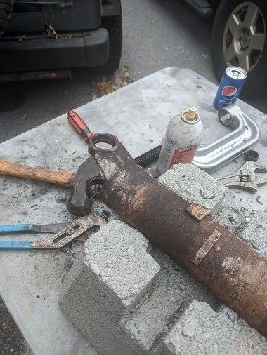

Any help on our to get these old u joints out would be appreciated. I just bought that c clamp tool from Harbor Freight for 60 bucks and its hardly moving it. HELP!!

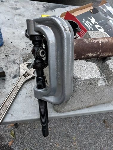

not sure this is the correct way, but you got to use what's available in the garage sometimes, I just used some sockets, one a little larger on the underneath of the bottom cup, one a little smaller on the top cup, and hammered away. not as easy a job but get's it done.. Sure all the glue is melted out, it should squirt out if I remember correctly, been a decade since I did one last.. . I'm sure you'll get a more knowlwdgable answer soon..
Edit: Is the C clamp large enough on the static side to let the cup slide thru?

Yes it shot out like a worm. But it looks like there might be some still in some of the holes.
The c clamp does have a large enough hole on the other side but it it moves when I tighten it.
​​​​​​Gonna try the socket and hammer routine tomorrow
