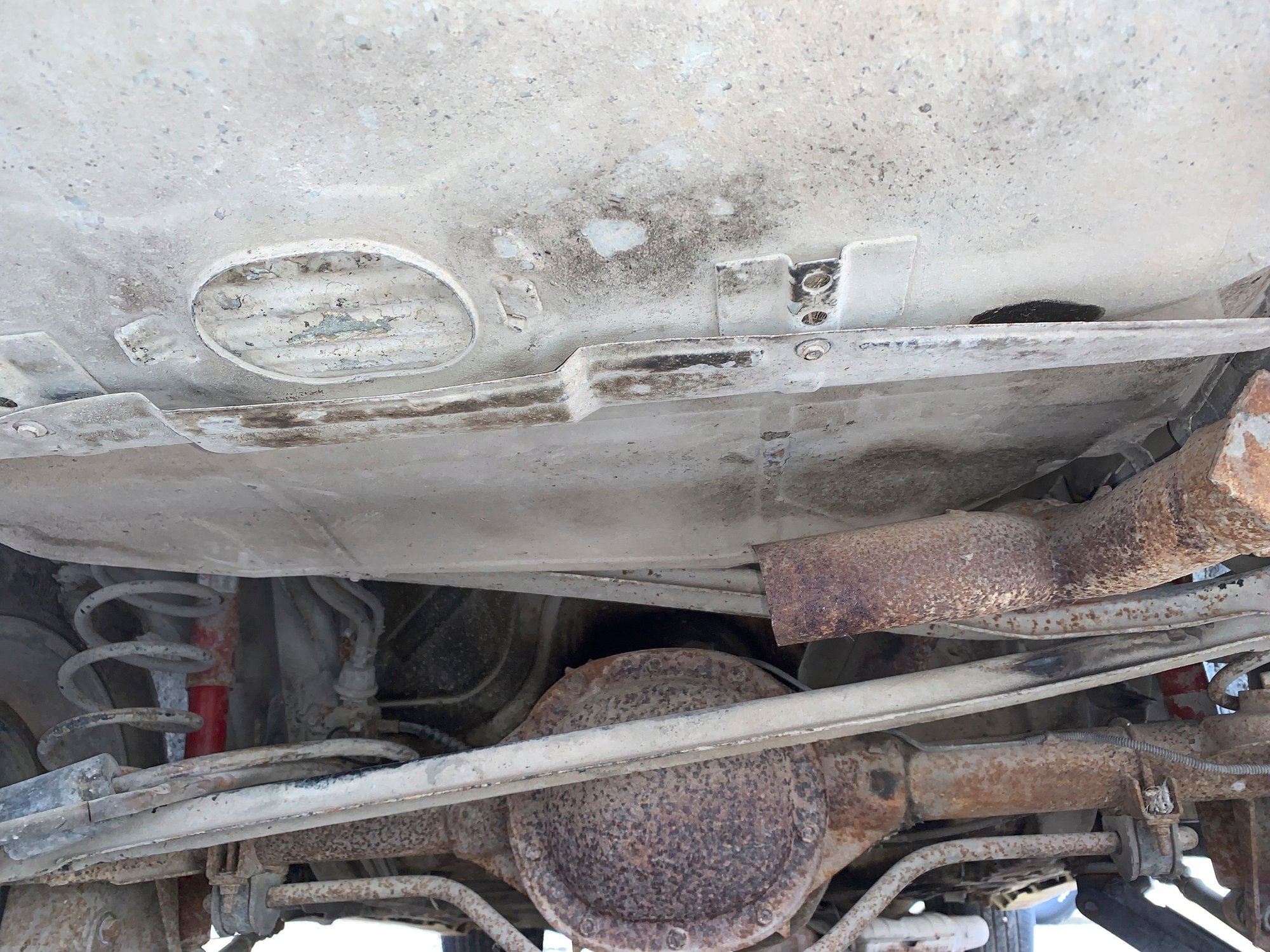

I've had two 1987's with the BW 9 bolt rear end. Both had covers with a rubber plug and a bulge in the middle of the cover. Both had coded GU6, G80, J65 and G92 but both were LB9/5 speeds. I've found an 87 with the L98/Auto. I always thought that all L98's in 1987 came with the BW and 3:27 gears. This car does have GW6 (3:27), G80, J65. But it does not have G92 code and the rear end cover is a 10 bolt cover. Can anyone definitively say they know for 100% sure that all 1987 L98's came with the BW 3:27? Cuz that would mean this one's been swapped. It is for sure not a BW axle. And what about the G92 code missing from this car's codes? If it was swapped wouldn't it have a G92 code?

I've had two 1987's with the BW 9 bolt rear end. Both had coded GU6, G80, J65 and G92 but both were LB9/5 speeds.
There's something inconsistent here. GU6 is a 3.42 10-bolt. I suppose your two LB9/T5 ?IROCs? could've had that 10-bolt, like 90-92 LB9/T5 cars, but you specifically stated that they had 9-bolts, for which the code should be GM3 (3.45), not GU6.
Now, I believe 1987 was the first year the IROC received the 9-bolt, while Pontiac had been using it since 1985, but I don't know if IROCs started receiving 9-bolts immediately when 1987 production began. Reaching here, but maybe it's possible that they were supposed to be receiving 10-bolts, and were still labeled as such, when the integration of the 9-bolt actually began? That might explain why your labels have GU6, and the cars had 9-bolts.
Regarding this part of your post, are we to assume you're talking about IROCs? All you've said is 9-bolt cars. Because Formulas, TAs and GTAs had 9-bolts, WITH the performance axle ratios, and GW6 is the code for a 3.27 9-bolt, but the G92 code wasn't listed on their SPID labels. The performance ratios were part of their performance packages, but the G92 code wasn't formally present. So if this particular car is a Pontiac, then there's your answer to why G92 isn't on the label.
Lastly, about all of the cars in question, have you confirmed that the VINs on the labels match the VINs behind the glass, the body panel labels and the firewall? I'm guessing you have verified their legitimacy, but it's worth a mention.

My LB9/t5's were GM3 cars. Not sure why I typer GU6. They are absolutely Borg Warner axles because I pulled the covers off, cleaned them and refilled them via the filler plug. Plus they are easy to spot with the distinct cover shape. I also had a 1987 L98 that DID have the BW but the SPID label was missing so I can only assume it showed G92. But wasn't the BW for the 700r a different ratio than for the T5? Regarding the car I'm looking at buying right now. Here is the label. It's clearly an 87 L98. Even if this label doesnt match this car it had to have come from some car. But every other code on the label matches what the car has. This appears to be an unmolested car based on the 40+ pictures the guy has sent me. So I pose the question. Where all L98 cars also SUPPOSED to be Borg Warner (because this one isnt) and what if any code indicates BW? It seems that it would be code G92 but I've read that isn't necessarily true. EDIT: Also incouding a pic of this actual rear end.

Counting the bolts is easy, but sometimes that top center 10th bolt can be hard to see or missing, making it appear to be a 9-bolt, when it's a 10-bolt.
9-bolts have BORG WARNER, maybe simply BW, cast into the bottom of the pumpkin housing.
The axle ratios and their equivalents: GU6 is 10-bolt ratio 3.42, and GM3 is the 9-bolt equivalent of 3.45; GU5 is 10-bolt ratio 3.23, and GW6 is the 9-bolt equivalent of 3.27. LB9/T5 typically received GM3 3.45 9-bolt or GU6 3.42 10-bolt. L98 received GW6 3.27 9-bolt or GU5 3.23 10-bolt.
As for why there is no G92 code on that label you're showing, even though it lists GW6, which is the BW performance ratio of 3.27, I can only guess that perhaps because that ratio automatically came with the L98 as part of its performance package, then the G92 code wasn't specifically listed? That's what Pontiac did, but Chevy typically listed it, or so I thought.
But that label is on the car with the 10-bolt in the other picture? Label lists the 9-bolt axle ratio, so the axle was either swapped at some point during the car's lifetime, or the switch occurred at the factory, due to a possible untimely change by Chevy between the 10-bolt/9-bolt in 1987.
I'd lean toward the later swap, as Sofa suggested. There's not likely to ever be any evidence to the contrary.

All 1987 5.7s had a BW 3.27
None came with the G92 code.
Over the past 36 years someone replaced that BW 3.27 rear with a GM 10 bolt

You've made some good points. First off it is unquestionably a 10 bolt in the car. And it appears to have been native to the car because #1. The SPID label indicates so #2. The seller is experienced in selling older cars and he says not one single thing on the car appears to have been molested in any way. So the swap theory, although valid is the least likely. Plus who would swap a 9 bolt and replace it with a 10 bolt? Maybe the dealer would do that due to a defect or recall but then the label would indicate it being built with a 9 bolt. So perhaps the boiled down question is this. EXACTLY what RPOs indicate a 9 bolt Borg Warner? That is really what seems to be unclear. I always thought it was G92. Maybe that is still correct. If so then the statement that all 87 L98's came with a BW 9 bolt (G92) is false. We have one right in front of us disproving it.
I am not as familiar with the performance gear options as you seem to be. But I always thought if it was a performance gear it would have the G92 code. You're saying a GW6 in a 10 bolt was considered a performance axle? Not disputing that just clarifying what you're saying. I think the theory that this car got a 10 bolt due to production line changes or shortages or perhaps it was a very early or very late car is most likely. We cant see the build sequence number on the label so I have asked the seller to send me that.
No.
GW6 indicates a BW 9 bolt with a 3.27 gear.
So according to the SPID, this car was built with a BW 9 bolt with 3.27 gears. What has happened in the subsequent 36 years is anyone's guess.

No. A 3.42 10 bolt behind a T5 V8 has the same ratio-specific RPO as a 3.42 behind a 700R4 V6. And the RPO changes if it a 3.45 9-bolt behind any trans. option.
Nothing required a third gen to ship with either rear. If Borg Warner's pricing went way up, GM would have shipped new builds with 10-bolts. I am sure the 9-bolt seemed like a way to beef things up, at a decent price point for an OEM at the time, so that's what they did. I am unaware of any dealer literature that (hypothetically) would have led a buyer to expect a 9 or 10 bolt. Because, this is tier 1 supplier opportunity in the 80s. There were limited slip shortages and some GM models didn't get them as-ordered in the years preceding 1985. Related? I don't know.
G92 represents optional rear gear instead of the one automatically included.
A stand-alone option for 3.23 instead of 2.73 would lead the car to get a G92 RPO.

The make / model and RPO are all that's needed for the third gen. You couldn't get a 3.27 rear axle 85-90 in an F without it being a 9-bolt. You couldn't get a 3.23 without it being a. 10-bolt.
Nope. Salespeople and enthusiasts with a vested interest in a car seeming valuable, rare, desirable, or otherwise doing the equivalent of bleach and a Brazilian on their swarthy sister will label things "high output," "performance gear" and other nonsense.
It's still an optionally available gear indicator.
Whatever it took for the line to keep moving.

I am beginning to think this is the most likely scenario for this car. I'm betting GM used what they had at the time. Unless the car was built with a BW and that rear end was blown up (not likley) and then replaced with a crappy 10 bolt. I just don't see anybody swapping a BW for a 10 bolt otherwise, especially when no other mods were made to that car. (It still has the original cat on it).
In theory I could put the rear end in it that was supposed to be in it and I wouldn't be committing a forgery.

People swap out the BW rear for a 10bolt still to this day.better posi, better brakes and cheaper to build are the main reasons.

Old Mar 9, 2023 | 11:21 AM
Posts: 28,012
Likes: 2,492
Re: Another 1987 Borg Warner Question Found a weird car
No, GM didn't deliver the car with a 10-bolt.
The RPO code you supplied from the SPID sheet (or wherever else you got it) is a 9-bolt ratio. Therefore that code says 9-bolt. Therefore it didn't come with a 10-bolt.
Either that or you're lying about the gear RPO code.
Either way, it's pretty obvious who's "small-minded" here. Anybody that will come on a forum populated with "experts" to the extent such a thing exists, and try to LIE about what they have, and then attack anybody that disagrees with their LIES, doesn't seem to me a very wise or far-sighted thinker.
Have a wonderful life in your personal fantasy world!!
Old Mar 9, 2023 | 11:52 AM
neilcase's Avatar
Joined: May 2012
Posts: 208
Likes: 16
From: Kansas City MO
Car: 1987 IROC-Z convertible
Engine: 5.0
Transmission: 700R
Axle/Gears: 2:77
That is no longer what I'm talking about. My point of my last two posts were about your conduct and not who is correct. You could very well be correct. Where does that give you the right to be condescending and holy? Here's my definitive answer on that. NO WHERE. I'd rather be wrong about something than to be like you. No need to worry about my life. Anybody here can see that.
On a side note. 30 years ago when I built my 1st 68 Camaro there were also guys who thought they were so absolutely correct on how those cars were built. That "correctness" is still being disproven today. GM is well known for using parts they had on hand. I never said I knew for sure this was the case on this car. I said it was a possibility and wondered if anyone else had ever encountered such. And you and Aaron chose to speak for EVERYONE even though there were other members who agreed it was possible. But once you've got a hardened absolutely correct opinion of something you can't see the possibility of being wrong. I have no problem being wrong. It's the best way to learn. You on the other hand don't seem capable of understanding that concept. You keep acting like a deity if it works for you.
Old Mar 9, 2023 | 01:38 PM
Posts: 28,012
Likes: 2,492
It's better to stay quiet and merely be thought a fool, than to open your mouth (keyboard) and remove all doubt.
Have a WONDEFUL fantasy world life!! You're doing pretty well so far, reality doesn't seem to have had any effect on you.
