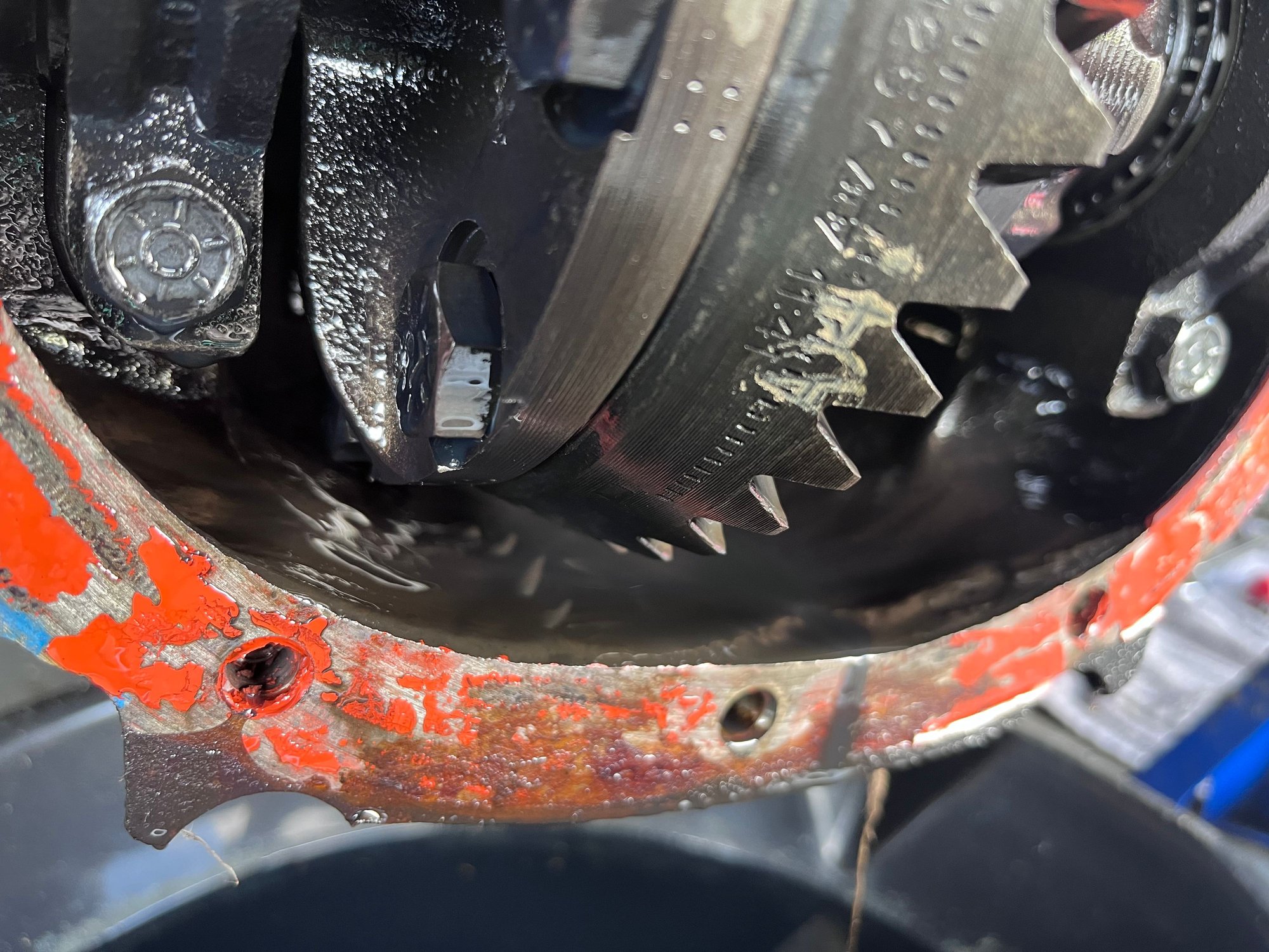

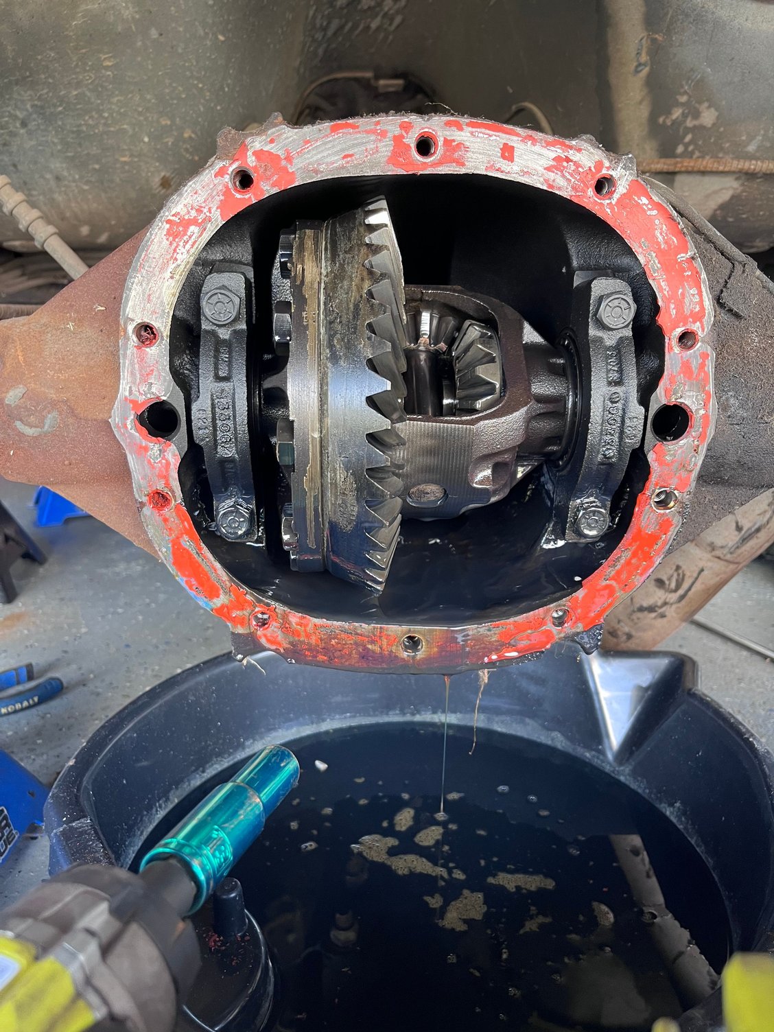

Re: Axle code help!
Alright here is the diff with the cover pulled. From the picture what are we looking at? Looks in good shape to me but how would I know. Why I am here. fire away gents
Old Jun 25, 2023 | 03:47 PM
Tuned Performance's Avatar
Community Influencer
iTrader: (95)
Posts: 16,900
Likes: 1,014
From: Mile High Country !!!
Car: 1967 Camaro, 91 z28
Engine: Lb9
Transmission: M20
Re: Axle code help!
Open differential, might rotate the driveshaft to see numbers on ring gear.

It says 11:41…3.73. Maybe a stupid question so forgive me but it seems like now is probably a good time to pull the axles and inspect/clean? However the Haynes manual cautions against a borg Warner. Is this one of those?

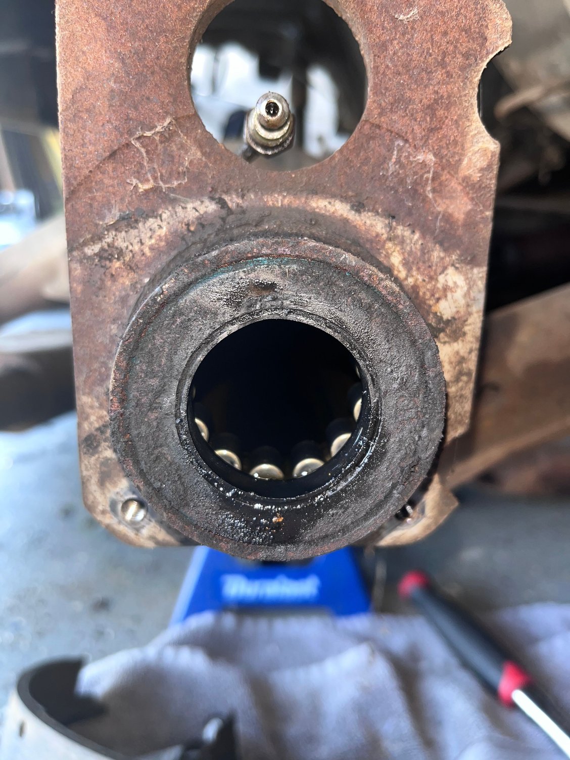

Old Jun 25, 2023 | 04:54 PM
Posts: 28,003
Likes: 2,485
Re: Axle code help!
That's a 2 series carrier with the "thick" 3 series gears. Started out its life with 2.73, 2.92, or 3.08 gears in it. Non-posi aka "open". Looks like 26-spline axles (early, weeeek), by the size of the ends of the carrier, maybe original to the car, maybe not. Hard to tell about "shape" just looking; the usual problems involve the bearings not being preloaded right, or the gears shimmed wrong. Neither of those things is visible to the naked eye unless they've led to major devastation.
Did it run quiet? Vibration free? Leeeek free? I can see some fluid has been coming out at the pinion seal, not a good sign although it doesn't look to be at a tragic level.
Might want to pop the axles out. To do that, take out the little tiny bolt holding that center pin in. It has a 5/16" / 8mm head. Use a 6-point box end wrench (go BUY ONE if you don't have just exactly that); get it on the bolt securely, and tap it gently with a hammer to break it loose. Remember, 6-point box end wrench: NOT a 12-point, NOT a socket, NOT an open-end, NOT NOT NOT NOT NOT. 6-point box-end wrench ONLY, either 5/16" or 8mm. Once you take that out, the pin will fall out. Once it's out, the 2 little spur gears will fall out. Once the pin is out, if you push in an axle, the C-clip will fall out, and then the axle will fall out, and the side gear and its thrust washer will fall out. It's REAL COOL in a way: there's nothing holding it together really, just, as long as that itty bitty bolt is in there, it can't fall apart. The deal about axles is, the axle itself IS the inner bearing race, and if the bearings are farkled, then the axles are fornicated too, since they're part of the total bearing package. You'll see. If the place on the axle that the bearings run is damaged, then they're toast, and you're basically in a world of s***. Post pics when you get the axles out. If the seals are leeeeeking, then odds are the whole bearing deal has taken a dump, and you've got basically abuncha garbage on your hands.
Drum brakes, I'm gonna guess?

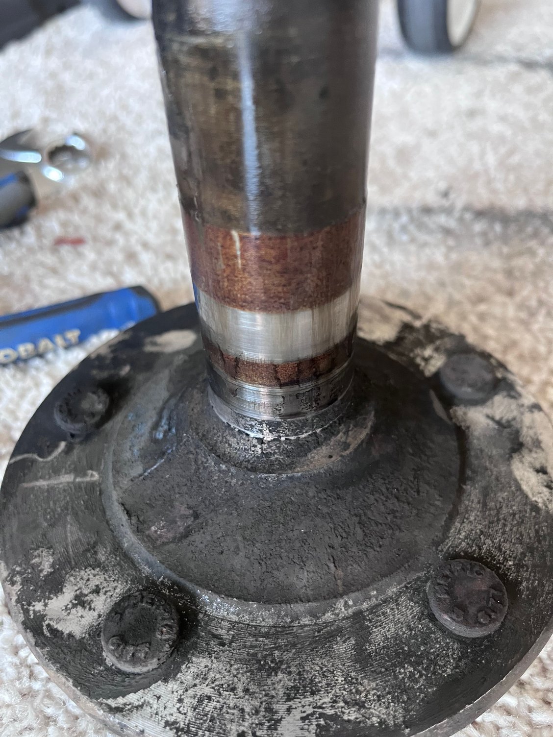

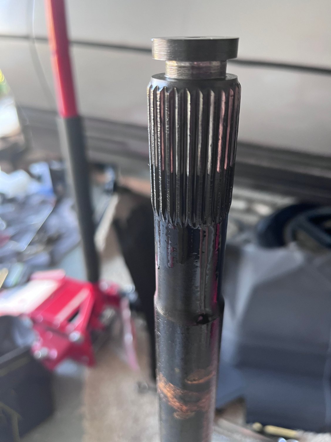

Re: Axle code help!
Alright here’s the right side axle removed. Haven’t really cleaned it yet but I’d say it appears reusable if properly cleaned/lubed. Went ahead and ordered new seals/bearing just in case. As always, fire away gents…
Old Jun 29, 2023 | 07:07 PM
Posts: 28,003
Likes: 2,485
Re: Axle code help!
Clean up the place on it where the bearings run with some lacquer thinner. Hard to tell much for sure with all that gunk there.
To remove the bearings & seal, get about a 5' piece of pipe, stick it through, catch it on the inside of the bearing, and bonk it out from the other side.
