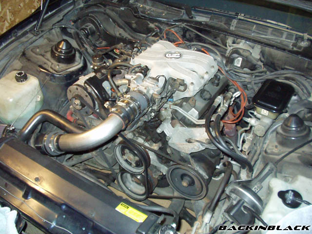

So, which one is this? MPFI or SFI?
Attached Thumbnails Differences between TPI & MPFI, I don't know-2.8-engine.jpg

mpfi
