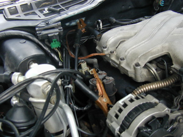

here are some pix what your looking at like you said!

WTF is that doing there?? Is this a 3.1 thing? That ground strap should be going to the right rear passenger head. Does your negative battery cable go the bottom passenger side of the engine block?
Also what's the negative jumper cable going to?

the jumper cable was my test wire. thats where i took off the ground. so i put it back there here i will ty to bolt it to the backe of the head
