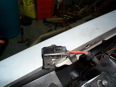

they might.... but i would pull the ECM/Fuel pump fuse thats in the engine bay.. look on the fender near the batt.. theres a little plug into nothing... pull the plug off the cover and theres a fuse inside... pull that one.

I can't find the fuse mentioned above. Does anyone have a pic of it, or would it be in any other location on a 90 RS?

Your pic of the fuse is correct, passenger side fender under the hood.
As for the idle learn it is more then just driving the car. Search on 'idle learn' & 'RBob'. It has to do with teaching the engine how to idle.
Pulling Inj1 & Inj2, or the fuel pump relay would be better. No idle learn is then required. You don't really want the injectors pumping fuel as you do the compression test.
