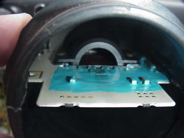

here's the one i have. (not the one on the car now)

That's a 2.8 MAF. It'll work on your 2.8 Camaro. (Firebird MAFs are a little different because they have a 45 degree bend on the end)

that one looks a little different than the one in the car now though. On this one, the chip is green and tick but the one in the car now isn't.
