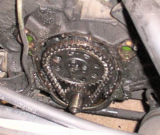

Going to change the oil, I realize my engine is 2 qts low on oil
So why is this :scratch head: , so I start looking around, notice the whole front of my engine is soaked with oil, and leaking antifreeze from around the timing chain cover.
Ok, so time to replace the cover gasket, and check the chain since the cars speedo broke at 186,967 miles, and that was ATLEAST 1.5 months ago. I'm already halfway their.
I get to the chain, realize the guide is broken from the chain smacking it, it also has been smacking the timing cover. I almost got the chain off w/o removing any gears from the engine.
So never less, new timing chain, new gaskets, oil change, 6 hours later, for this simple oil change, it runs sooooooooooo much better.
Attached is a picture of the chain.

Crap
Is the timing cover still good? I also see that you finally sold teh truck . Better take good care of teh GTP or I'll park it next to my 99 GPGT

Yeah, that's some nasty chain flex.
Looks like mine did when we cracked my old 302 open... Naaaasty....
Good to hear ya fixed it without much problem!

Cover was just starting to get rubbed, so it fine. Its still on the car.

It is a really good idea to change the timing chain if your car is getting up there in the miles (100k+) and has never had one. That's one thing that makes an engine run like crap (lack of power, rough idle). Eventually, if you keep ignoring, it will leave you stranded.
My old lg4 died while making a turn one day as a result of me putting mine off (using the , 'eh, it still runs' theory).
The result of neglect (though it would still turn over and barely run for a few seconds)...

Just as bad.. the chain had enough slack that it had been riding atop the the cam gear sprockets until a few of them sheared off causing the death problem...
Attached Thumbnails Emergency Repairs, Timing Chain :eek:-chain.jpg

Hehehe mine was worse. you could all most touch both sides of the chain together. Of course the guide plate was gone. I'm asuming it is some ware in the oil pan. Or the last person who worked on it left it off. Chain was slaping so bad it left a bunch of hair line cracks in the timing cover.
