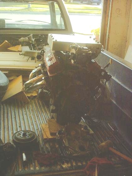

Process of gathering
Me too. I finally fiound my block and crank and then some for cheap. This 3.4 actually only has 60K on it but I intend to tear it down and trick out the internals. Time has come to start collecting the rotation parts, and have the machine work done.
Joined: May 2004
Posts: 1,340
From: Orange, Calif
Car: '87 Cam RS V6
Engine: Top Secret
Transmission: DYT700R4 custom inerts and conv.
Thank you Karl- Not bad for $200, and I didn't even have to get greasy to get it- Found it from an old acquintance/team member in the GRA (Guldstand Racing Assoc). He's working part time Tech support for Doug out at Global West. Let me know if you or Jay need anything off this before I through some of this crap away (only things I don't want though
I quickly sat some of the parts I have onto it for kicks. Wanted to see what it would kind of look like finished before I completely start tearing it apart.
)I quickly sat some of the parts I have onto it for kicks. Wanted to see what it would kind of look like finished before I completely start tearing it apart.
