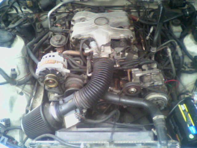

im not really worried so much right now about power, just because its such a frankenstiened motor, plus the car not being what the engine was ment for. i thought that it would be easier to work out all the little bugs that the car has. no computer no electronic stuff to try to figure out. but ill try to get a picture or two to show you. how thw mazda a/c compressor was still used, plus the fact that only the driverside has the "air injection". absolutly mind boggling, what these guys were thinking when they did this.

I need some help

Wow.... Well, first off, what little bugs does the car have? Maybe we can give you some insight

well, since im new to the engine. i havnt figured out where there are areas where vacum leaks can occur. i have replace all the vacum lines that i can see. and on the back of the intake manifold there i a T-fitting of sorts, snd its loose, but when i tighten it i cant connect the hose that is supposed to go there(you can see the mix-match orange/black hose that connects to it in the picture above). that and the smog pump only connects to the air injection one one side the hose thats supposed to connect to the otherside is just open, should i remove the smog pump and plug the hole in the exhaust manifold. or do i need to plug the open hose from the smog pump. or doest it even matter. oh and im not sure how these engines normally run, but when i hit 4500 rpms the engine stops making anysort of power, and kind of "surges" (thats the best way i can describe it). if you all have any ideas i would appreciate it,. and one more thing.... im not sure but is the egr valve from a diiferent generation, of mototr or is it all the same?

well ya the power band ends at 4400 4500 after that your just pushing air
but that engine looks to be a 2.8 not a 3.1

well i was told that the way the idler pulley was there that it was a 3.1, it has a 2.8 intake, along with(what ive been told by someone who looked at the engine in person) a bunch of parts that shouldnt bee there, beacuse of what engine it is.

3.1 uses a digital egr you have the old type found on 2.8s
the idler is differant then 3.1s and you have half vbelt half serpentine setup weird

the egr isnt supposed to be on there , its one of the oddities about the car, the crank pulley is different than what is supposed to be on it, hints why the idler is different. sorry if that sounded rude.
