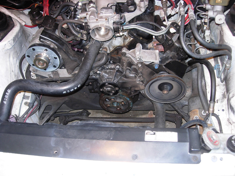

just did this two days ago. took me two days. but i also did timing chain and gears as well as the oil pan gasket at the same time. if i just had to do the pump it would be a one day job. remember i am alloting for dry time of the RTV.
on my car I did not have to remove the power steering pump.
I have attached 3 pictures.
1st one is car with belts and intake off, and the pulleys removed. so far this is about 30minutes in if you are slow. I also have the coolant draining. you do not need to remove the crank pulley, but it may make things a bit easier to get too. I removed it because i was also removing the timing cover.
2nd
is the timing cover after I put it back on, before I put the water pump back on. you can see the holes that need bolts. at this step it is important to note that you must put RTV on some of the bolts as they go through to water jackets. if you do not you can get water leaking into your timing cover, and thus into your oil. to be safe just put it on all of them. I mostly just put this up so you can see what it looks like with the pump off.
3rd is after I put the water pump back on. see how nice and shiney. all in all it was not too dificult. i took the oportunity to replace the lower radiator hose and clamps as they are easy to get at with the pump off. if you do this take my advice. drain the radiator by cutting the lower hose. if you pull it off the radiator you will dump coolant on the core support and it will drip on you for days. same thing if you use the drain plug.
Attached Thumbnails Going to Replace WaterPump....-dscn4426_small.jpg   Going to Replace WaterPump....-dscn4463_small.jpg   Going to Replace WaterPump....-dscn4467_small.jpg
