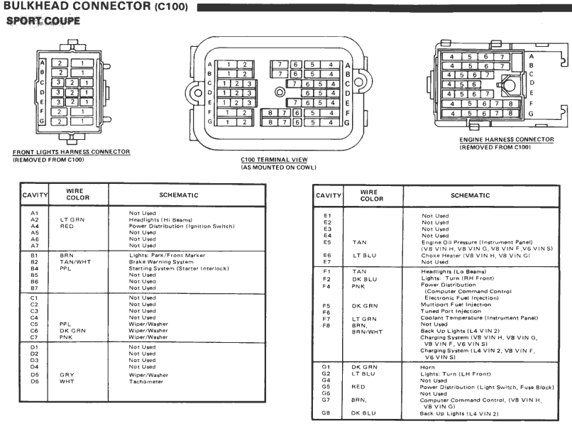

http://www.autozone.com/az/cds/en_us...rInfoPages.htm
Looks like the green/white and light blue are the ac, the diagrams might help you out. Good luck
