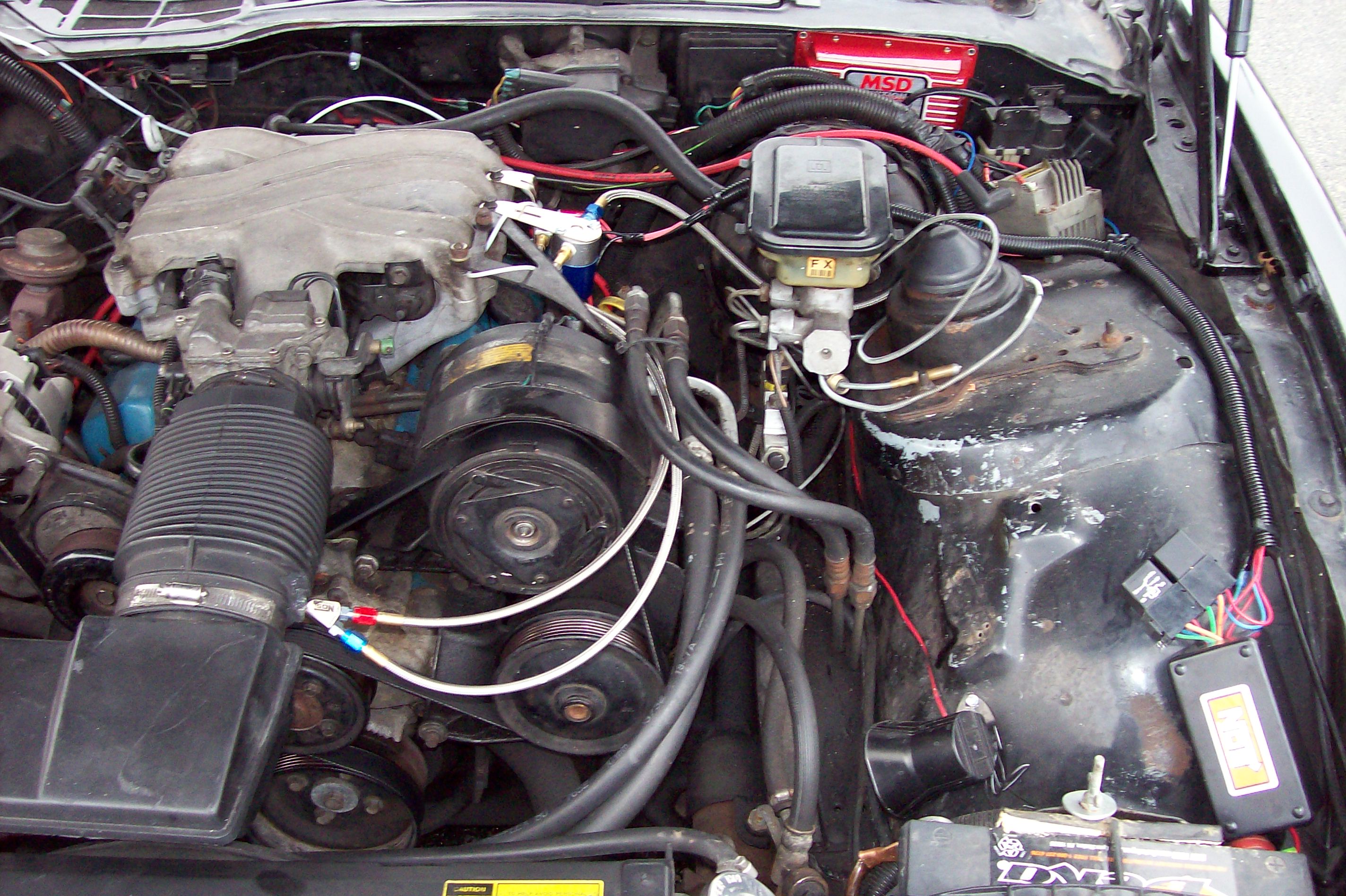

Attached Thumbnails Planning on nitrous-166106_1691043148649_1014842255_1845234_1514948_n.jpg

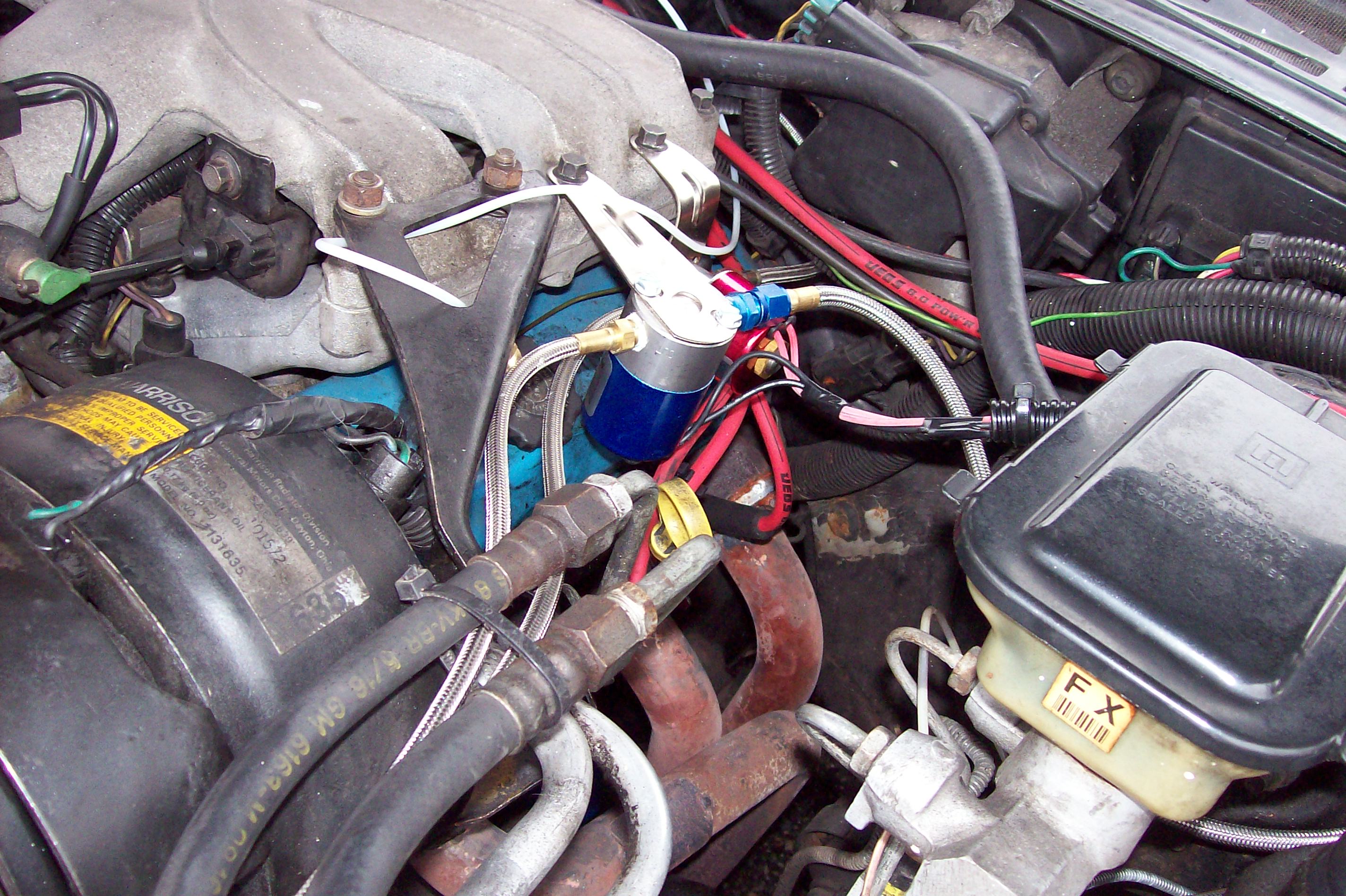

Started installing it and checked for leaks. The Fuel hose from the rail to the solenoid leaks bad, but not from the fittings. It leaks from where the braided hose is crimped into the fitting. Any Ideas? I think I'm going to have to buy a new one and return the old one. Think I could solder it?

There is rubber under that brain, its a failed crimp.

Those lines should be teflon lined, i.e. they'll melt if you get them hot enough to solder. Call Holley/NOS and have them send you a new line.
I used a brass 90* swivel fitting between the fuel hose and the schrader valve... I don't much care for how NOS wants you to screw a stiff straight stainless line into a vertical fitting, then bend the hose over horizontal... NOS part number 17535 is basically the same as what I used to take the stress off the stainless line.

Drew, did you use that swivel connected straight to the rail then a hose from the swivel to the solenoid? Was the fuel rail -4AN or 1/8in?

The female end screws right onto the schrader valve (remove the core first) then the hose screws on the male end. The current version of that part is nickel/chrome plated steel, in the mid 90's it was just brass. The GM schrader valves are -4 an.
Don't get excited and do something stupid... The few days it'll take to get a proper replacement isn't going to kill you. You've only got a few options for fixing it yourself. You could carefully cut the crimp sleeve, cut the hose down, and have a hydraulic supply house put a new crimp on the line. Or you could get a reusable fitting and cut the old end off, and install the new fitting. Either way assumes you have local businesses that carry Aeroquip or other specialized fittings.
Take the time while you're waiting on Holley/NOS, to plan out your install, and start mocking it up in your car. You're bound to find something about the instruction book install that you really won't like, and you'll want to change. I ordered and returned several parts before I finally got the system in the car, and since then I've changed the setup a few times to make it more user-friendly.

I got it all setup up and installed. Using a 75 shot. It pulls harder then with out the bottle for sure. I'll take some pictures of the install soon.

Ignore the white hose on the intake, that was for a ghetto purge I setup before I sold the solenoid and also ignore the unhooked up mechanical temp gauge.
Attached Thumbnails Planning on nitrous-100_4217.jpg   Planning on nitrous-100_4216.jpg   Planning on nitrous-100_4215.jpg

IM guessing that its feel like more but is still kinda ho hum still or you would of posted right after your first ride???

No, it really kicks in. I'm just too embarrassed to show under my hood haha. Its such a mess. And I just about forgot this thread.
My setup's still sketchy too. Push button activation. No safety blow down tube. Bottles not bolted down yet. The weather here sucks, We just got an ice storm and were suppose to get hit again Friday. The Firebirds my daily driver also.
