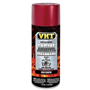

this would look pretty sharp for a block...

In my experience with engine spray paint, it won't hold up and will wind up looking crappy, as for mods, if you have the tools and knowledge, port the heads, put a 260 grind cam in, and some 1.6 rollers. Should be good for 15-30hp, more if you have other mods to support it(ie. exhaust, intake). Also, just throwing it out there, SS lines will really set the engine bay off, though if you are polishing the plenum it would be a little bit much, could do nylon mesh though.
