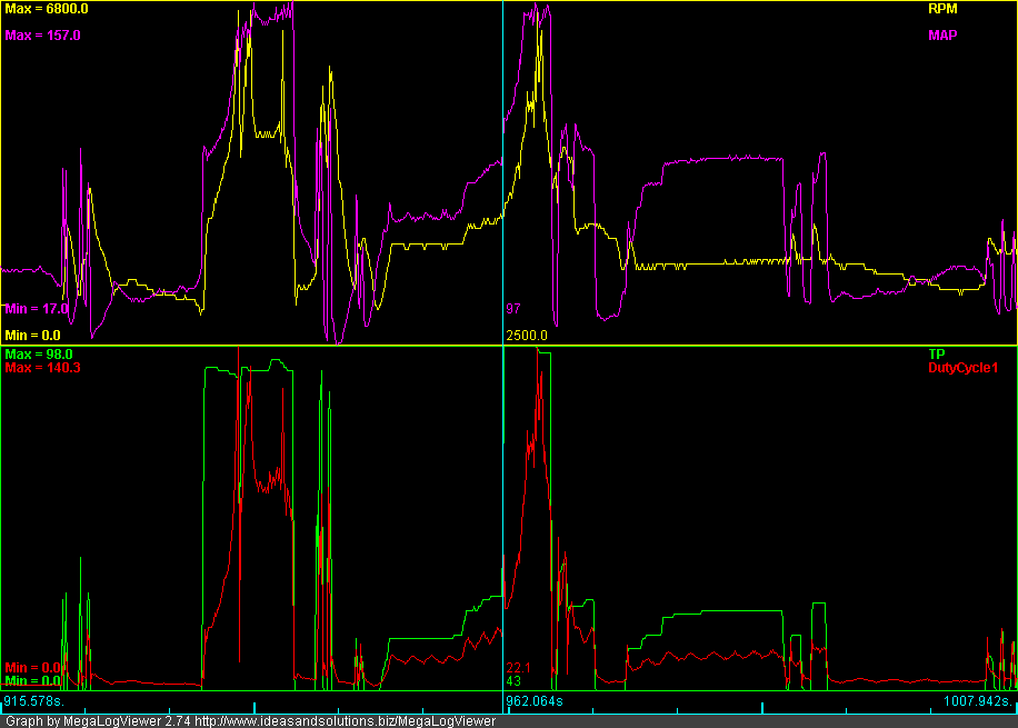

hey fast if u think ur out of injector check out this datalog from my 13.00@105mph run
140.3 duty cyle
man i was really pushing that thing at the time before i installed the larger injectors
the blue line down the center of the graph pic represents were i went wot, on that pass i launched at 2500 rpms and 0 boost but if u look how fats my converter flashed and boost came up it was instant,also shifted @ 6,800 rpms
the stuff to the left of the blue line is my burnout

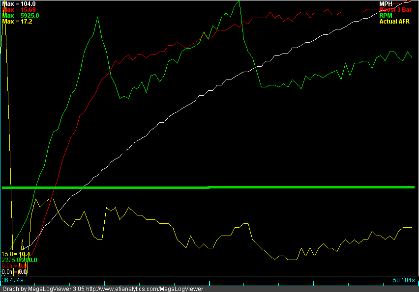

lol heres one to 7,400 rpms, i have datalog somome were with the motor turning 8,600 rpms witht he 4:56 gears and t76 turbo

Well I dont know how good the bottom end is on my car. Its stock, Its got 110k miles on it... so its a coin flip I guess.
Seems like the more boost I feed it, the higher she likes to rev. 5900 from 2nd to 3rd. And yea that damm motor sounds sweet the higher it revs thats for sure.
7400rpms is high. Wow thats amazing. you had a rebuilt motor the whole time you reved it like that?? Right....
Your map was 156 or so in that log?? As in 156kpa?? Thats some low boost levels. 8 psi or so? But on your set up 8psi was like what mine would need at 18psi...lmfao

Opps I need to remove shims.....lmfao..read me and actually do the math on the excel print out datalog.. from 0mph to 100mph in 12.54seconds
And yes I wont do that again as I was truly maxing those injectors out, but didnt relize it at the time.
After I fixed the leaks and retested it, I ran that reference line to the back of the manifold, And I had to use slightly smaller line but it wasnt too small. So I took her out without the boost controler active.... The first time I just gave her helll to 70mph and saw it made 12-13psi of steady boost!! I was like WTF.
So I then cooled her down and proceeded to take her up to 100mph+ with a passanger to carfully watch mainly KR and AFR. Also telling them if I see 15psi Tell ME!!!
My buddy said the AFR was fine and that the KR was not there as I told him you may see a .0x degree of it so dont tell me when you see that, only when you see 2,3,4,5 degrees exspecially once we get going.
Well the run was something to say the least. Man I went 0-100mph in like 12.4 seconds and eased into the throttle at first. Boost was up to 15psi and if you look at the log, nothing looks bad EXCEPT the injector DC. That was bad. But it was also rich as a skunk as I guessed at the VE table and timing earlier just in case.
I will remove some shims as this log below was with no boost controler. 15psi is a little much for my injectors but DAMMM was that car smoking fast and it felt so GOOD!!!

lmao i told u to go slowly when u add shims,and the boost leak will change ur afr's a lil bit.
ill take a look at the log now

0-100 in 12.5 seconds
ur afrs were ok even a lil rich , but the datalog was reporting 100%+ duty cyle
if u got the afrs back to 12.5-1 u have just enough injector to run 15 psi
ur afrs under boost were in the very low 11's to very high 10's ill post up a graph for u in a second
tune it to 12.5 afr and let her eat !!!!!!!!!!!!!!!!!
Joined: Apr 2008
Posts: 10,401
From: Utah
Re: Turbo Install
wow u had a masive boost leak then
anyways see the green line i drew across this graph thats 12.5afr
now look at the afr line and see how rich it really is

Yea it was way rich. My asked my co-pilot..lol.. and he just said its in the 11's so I just kept going. Man that was a rush! Ill tune the afr.
Those injectors...I have no idea how they kept up now that I look at the datalogg
The leak was pretty bad, would loose all the 15psi I dumped into it with in 1-2 minuets.
Id really like to see what that run "could" have been. 0-104mph in 13.57 seconds on the road, and you see how I started the run. Car felt very strong though!
