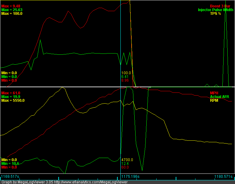

that log opened , before u even steped on it afrs were in the 19's
u hit the throttle afrs dipped into the 10's then shot right back up under boost
can u make another log file for me with mph
from the looks of the log the ecm is going wacky it never shows u lift off the throttle
and the injectors at points were going to 25.63ms while u were idling

ok if u look at the first pic i posted the log was actually showing backwards compared to the one u posted now
but it still looks like the ecm went wacky the pulsewidth was jumping up and down randomly in that log , especially when it went lean the pulsewidths went from 11ms to 6 ms then back to 11 then back to 6 or so.

i dont think its the fuel pump though it could be. looking in the datalog the puslewidths are randomly going up and down for a second at a time threwout the log even before it went lean
heres a snapshot of when it did go lean , and after the fact of it going lean the injectors pulsewidth went even more erratic when he let it idle then it was before he hit the lean spot.
there is no reason the pulse width should be jumping aorund like it is
Unfortunately, this is normal. I am surprised this hasn't been corrected in $59. The reason for it is that the RAM variable that is used for the injector PW changes as the calculation is being made.
So from time to time the PW shown in the data log is incorrect. As it is an intermediate PW value, not the final one.
These show up as 'glitches' in the PW. To verify that this isn't new I looked at the "March 6th WOT(only).csv" log file from a few pages back.
It too shows the PW jumping.
As for why it is going lean, be sure to keep the tank at least half full.

Ok guys heres where im at. Its got to be the fuel pump! And to add there is between 1/4-1/2 tank in the car I just put 5 gal in it yesterday morning. And only drove it about 30 miles.
All injectors come out to 15.4 ohms. All of them. @ 75 degree ambient temp in the garage.
I didnt even have to check the fuel pressure becuase its almost no existant. Barly will it come out.
That rubber fuel line that runs up to the rail from the rear of the car...you can physically push it and colapse the hose, so there is NO fuel pressure in there at all. The car will still start as I tried before I started to trouble shoot. But as you can guess barley runs.
Also checked the ecm and such. Every connection is fine.
So I have these questions that I hope you can help me with...
Why can I still hear the fuel pump prime?? But yet no fuel is coming out?
And also what is the best overall way to put in a new one? In tank or inline?? And what kind/size 255 LPH?
I have never personally droped a tank to replace a fuel pump, just thought Id add that and im also on a budget.
Thanks guys!!

I also checked the fuel line off the tank before the fuel filter... yea no pressure in it when its suppose to be.

I do get a little fuel but nothing much from the rail, soon as I push the shrader it barly come out but it i turn the car over it does come out pretty good but no way near 20-30psi, i dont even need a fuel guage to see that.
Id like to also check the fuel filter but am scared to mess up the flare fittings that connect to the filter. Any tips on that?? Stuffs so rusty down there

Ok i got it off rob. I can blow threw it. Not much pressure from the fuel came out. Basically just dribbled out when i removed the filter.
Do you think its my fuel pump? Is there anything else i should check? And also what fuel pump shoul I be looking for? Im a newbe at upgrading a pump.
