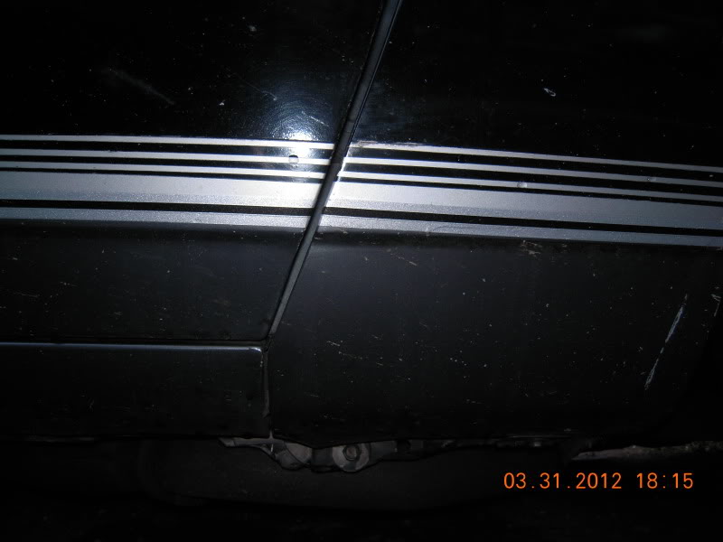

some type of jack was used. The bottom flange is bent completely up. The fender seems to be bent up and out from its original position. I am comparing it to my passenger side door and fender. I will post a picture.
See the bottom flange is completely bent up...I believe someone used a jack here and bent the fender up and out so now the body line is completely off along with the molding.

Passenger side (kinda hard to see its dark out) see the bolt on the bottom? seems as though no jack was used on it.
