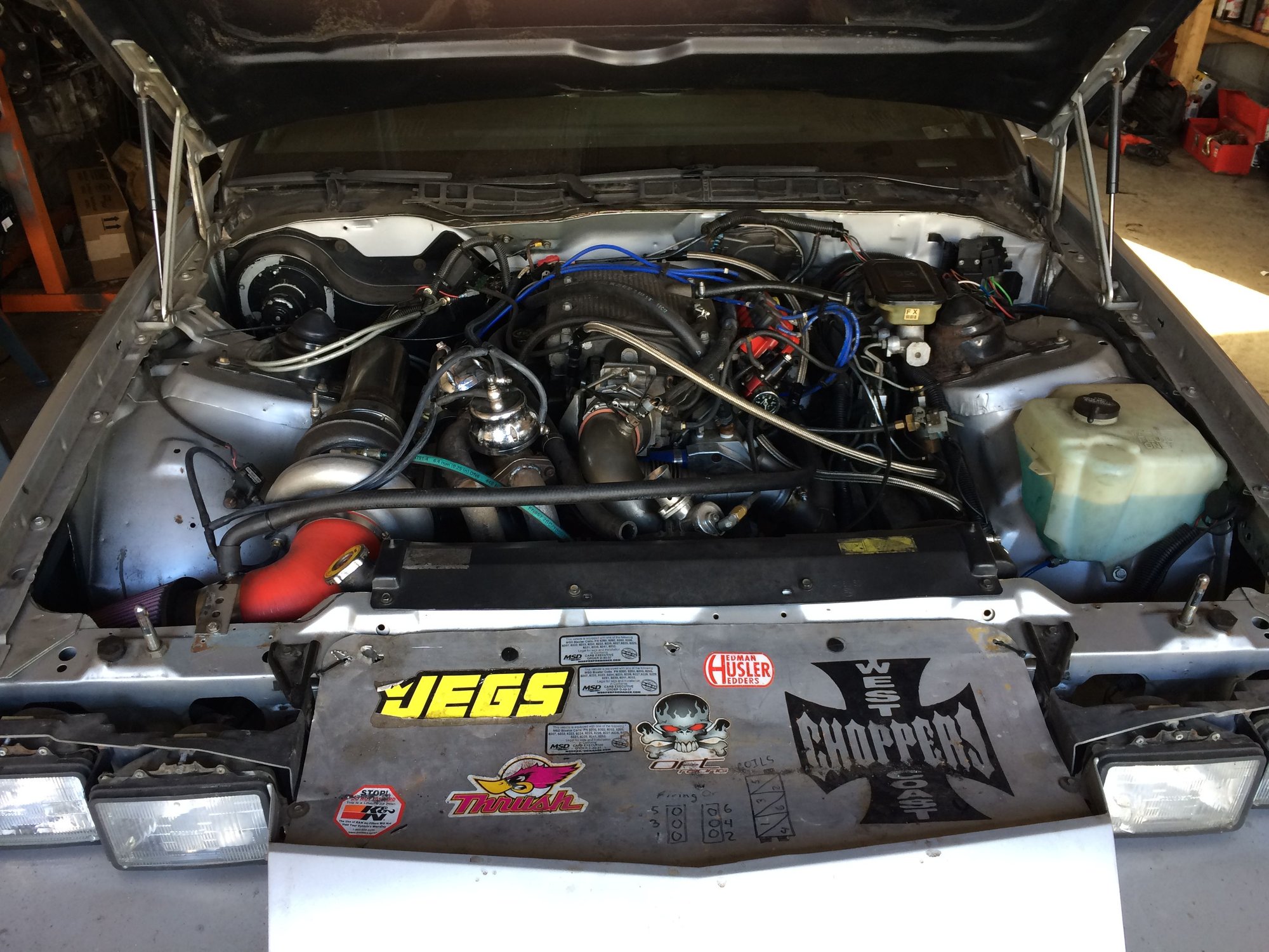

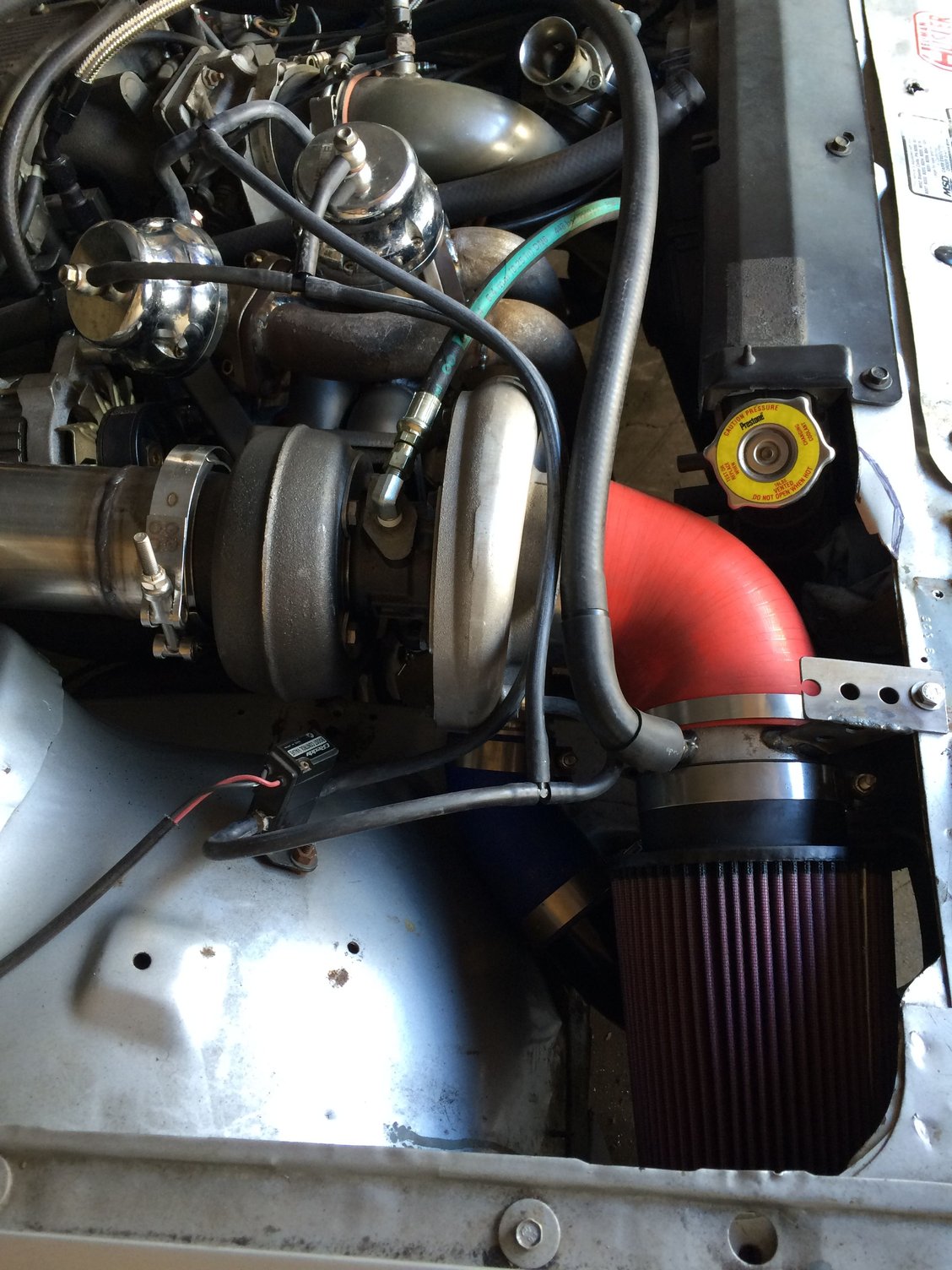

Thought I would update the thread. Turbo is in. I changed the gates around a little and placed the turbo in such a way that I can fit the larger airfilter.
The weather is starting to come around now, lots of smaller things left to do but I'm finding the time to pick away at it.

Why did you go with the s369? Trying to find the limits of the stock rods/pistons?
Also....
3900 IROC-Z28 buildup.-img_20160331_155021496.jpg   3900 IROC-Z28 buildup.-img_20160402_185858147.jpg
