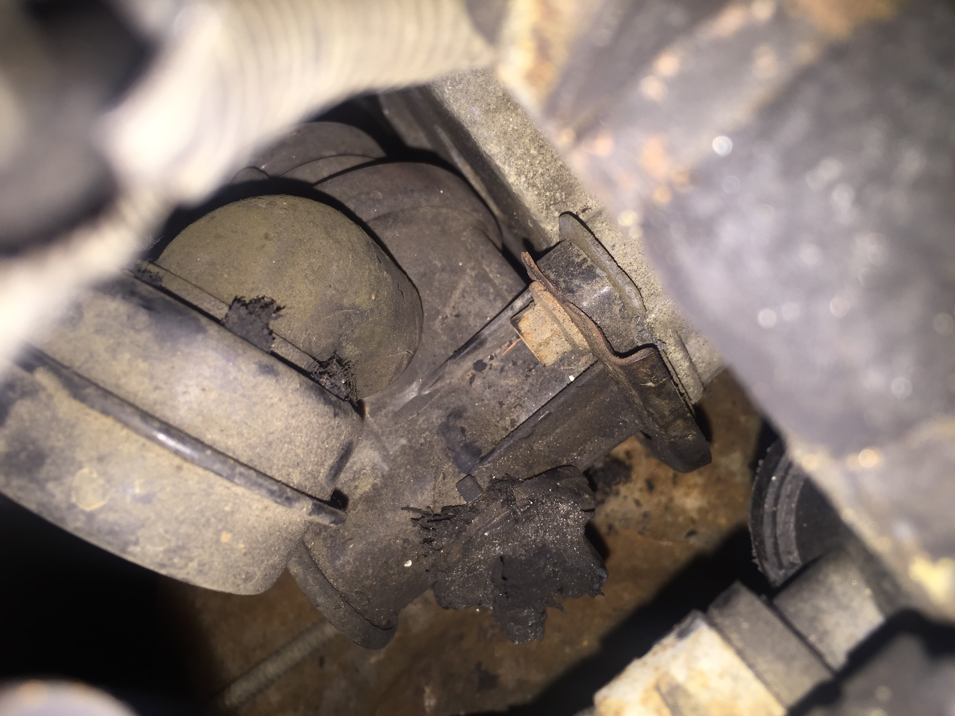

I purchased this car non running. Everything seems to check out except one part on it seems to be burnt melted and has a hole in it.
car will barely start most times and when it does start I have to give it gas but it won't stay running unless I keep my foot on the pedal. Fuel filter and pump seems to be good and it's reading no codes.
but I noticed a burnt part and it's melted with a hole in it. I have no clue what part it is and I was hoping someone could help me identify the part and could it be the reason the car won't idle or run. I will try to upload a picture.
But the location of the part is on the passenger side
front lower corner of the engine block. It's behind the lower passenger side pulley

That's part of your a.i.r pump. It pumps air into your exhaust to lower emissions. Maybe why your car wont idle But not 100% on that. But yeah start there. I completely removed that whole unit pulley and all and got a shorter belt. If you don't have to meet emmissions were you are i would remove it. On you tho.

Hard to see but looks air pump related, I don't think this would affect your running much, I removed mine also with shorter belt. Have you done a good tune up of all the basics first ?
