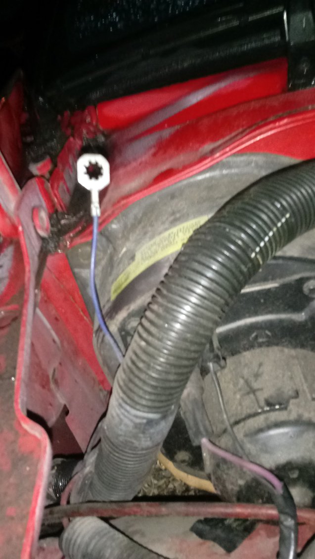

I think I'm just gonna sell it and look for another 3.1. I mean it runs "OK" once it warms up. First I gotta fix this damn starter clicking problem. I had this same issue on my 3.1 but I fixed it by installing a push button start. No solenoid or anything like that, just the push start. Has been starting every time since I installed it a while back. Simply ran a 12v hot wire from batt to button and another wire from button to S terminal on the starter. No more stupid clicks. I always start it with my button and never clicks. But lets say I decide to try to start it by turning the key....... guess what, it clicks. What could be the issue? The ignition switch? Anyways I have my button. Would be nice to fix that though.
So now on my 2.8 T5. Dam thing clicks a million times before it decides to start LOL. I'm lazy so I wanna try the same fix but a little different. I want to hook up a 12v wire from battery to button, then from button to purple wire that goes on the S terminal to save me some time. Basically the same idea. But I want to splice into the purple wire from up top . Were can I find it? I know the manual cars have a neutral safety switch but not sure were.. I also found this wire not grounded to anything. Any idea what it could be? Maybe nothing

I'll let someone else address your starter issues,

The push to start should be fused out, with a relay. Just saying.

Re: 2.8 Issues
I have had it on there almost 2 years without a relay and no problems. If for some reason my 3.1 had trouble starting, and long crank times then definately I would wire in a relay. But it starts up in 0.4 seconds haha.

Man wish I had the money for the MS and carb swap. One day...... So I went to pick up a brand new starter for my 2.8 from AZ since I have warranty from my 3.1 starter. I'm using a 3.4 starter on my 3.1. Nice to get free parts ,and the dude brings out this tiny mini starter and I'm looking at it like damn is this the right part? Turns out it was, Thing is sweeet, half the size, half the weight and it makes this cool whine when cranking. My 2.8 starts right up, no more clicks and I didn't need to wire a push button. Kinda feel like ripping it out and sticking it into my 3.1. AZ is stepping up their game. So while I'm down there I notice the freeze plug is rusted like hell. Not leaking but it's definitely on it's way out. I checked the driver side freeze plug and it's in great shape no rust at all. Weird. One thing I have been neglecting is to drain the rusty coolant and flush it. Previous owner must have put tap water in there. Damn. I'm pretty sure my intake manifold gaskets need replacing as it smokes a bit at startup. Pretty sure it's coolant. That would explain my issues. Saw some leaks coming from water pump and intake area. Another thing I always noticed, when making turns I get a creaking cracking sound coming from the pass side. My A arm bracket welds are shot and are a bit rusty. I'm gonna get them welded. Driver side is good. Good thing I was down there. Don't want it to break any further. Man now I feel like I have to tear out the motor&trans and freshen it up. Runs beautiful on the highway once warmed up but I know it can run wayyy better. I have to wait and see.
