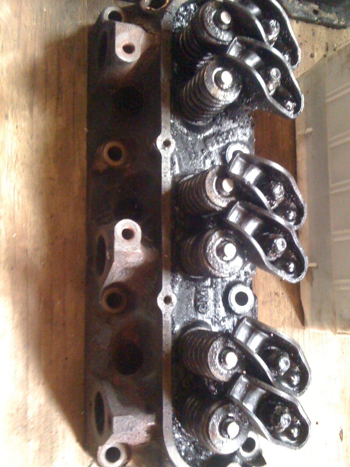

I just checked , mine only bolts to the head just above the manifold , and to the back of the pump , with no other bolts into the block . In this picture of an old head , it's the bolt hole just behind where the manifold would bolt on , on the front cylinder . I now wonder if it's not the right bracket on mine (mine is just a flat steel bracket fitting between the head and the pump)
