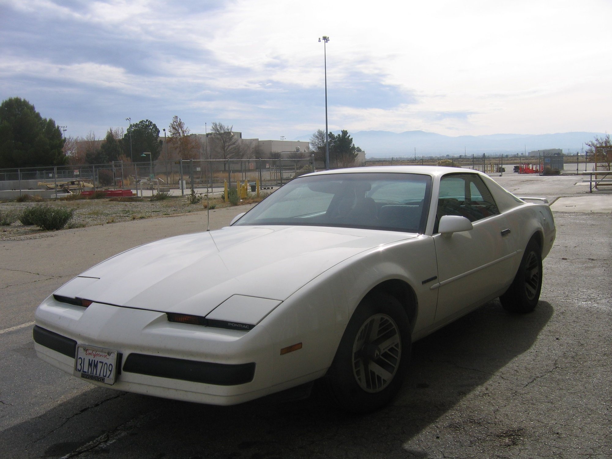

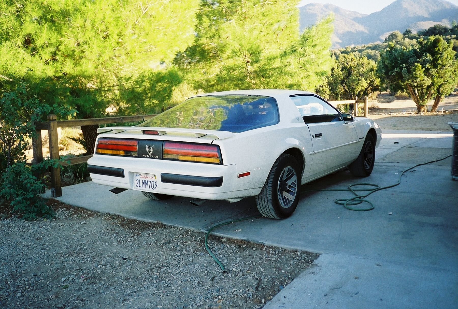

I'll add a few pictures just because I always like to see pictures of people's cars in forum threads. The first three are from 1998-2003. The last two are the day it got delivered to me in Texas, and where it sits now in my garage.
2003
1999
2003

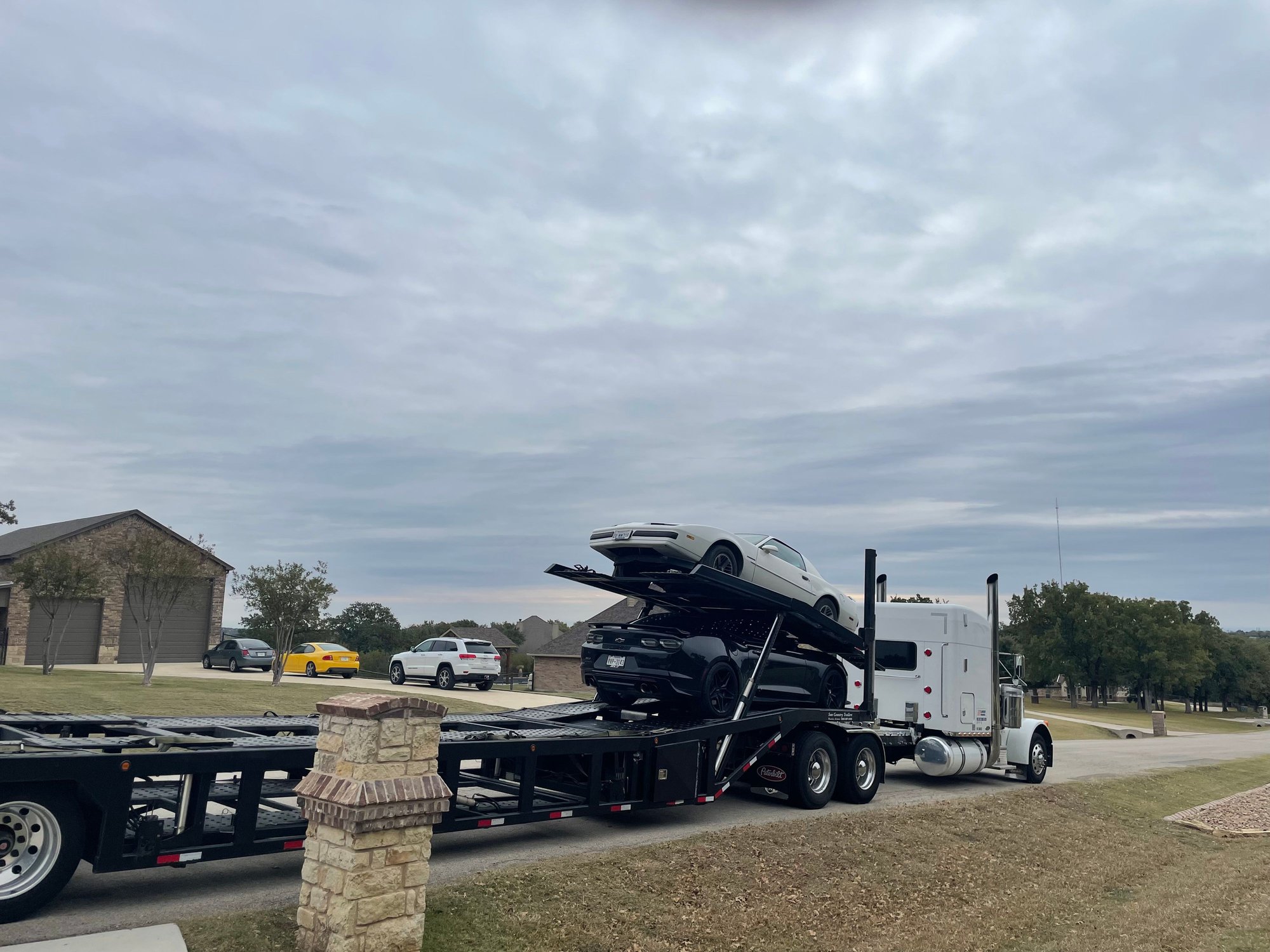

The day it got delivered to me in Texas.

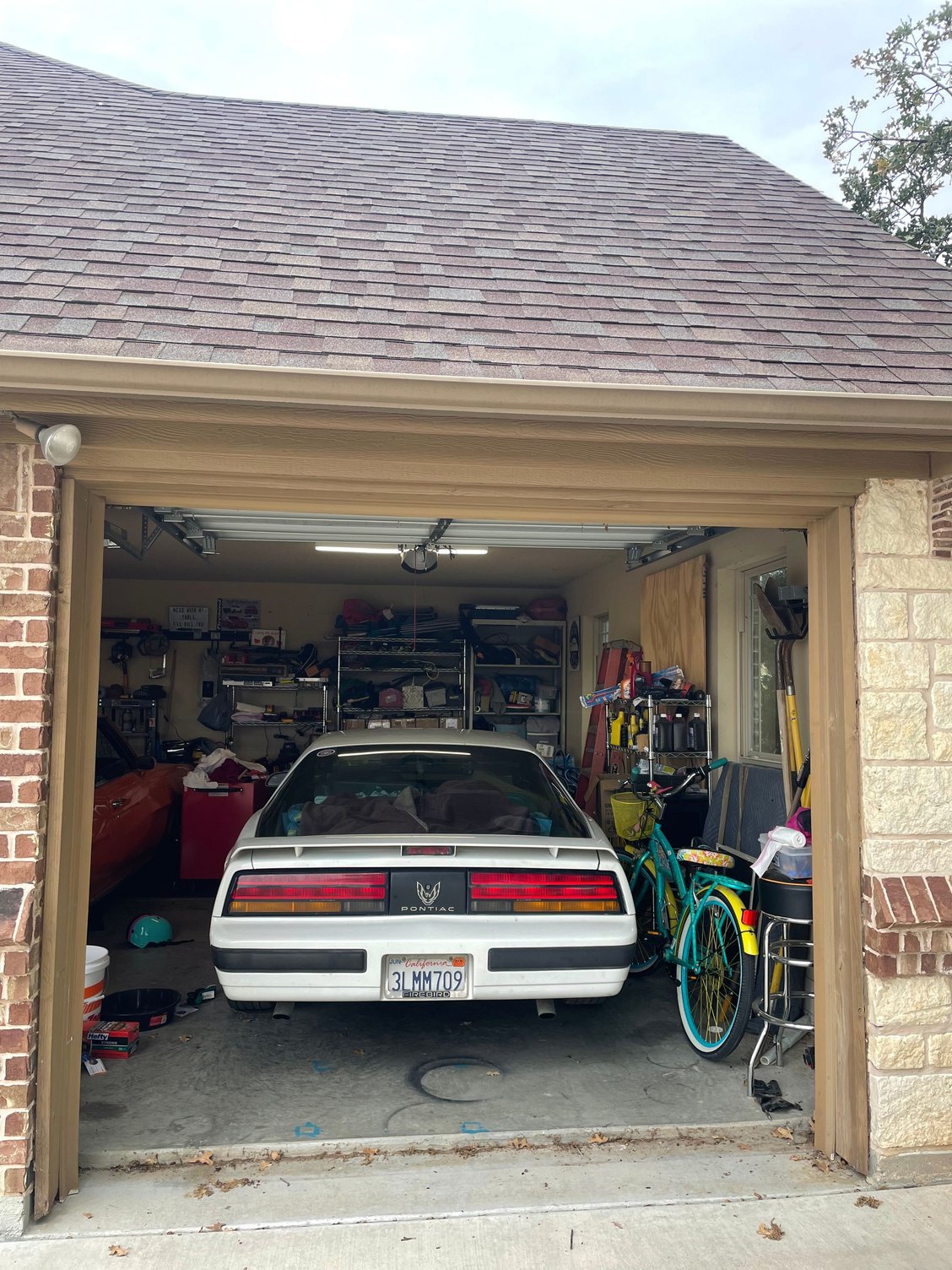

Where she now sits.
