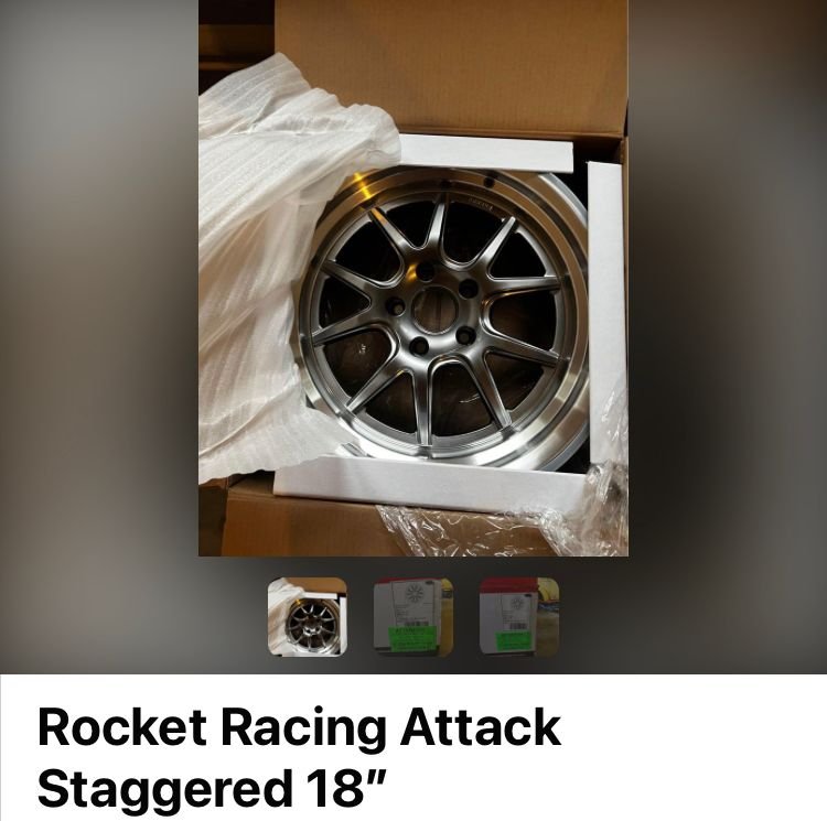

A friend recommended these to me for my 1989 GTA. The seller says they were for a second gen Camaro. They are 18x7 with 4” backspacing in the front and 18x9 with 6” backspacing in the rear. Would these fit a GTA?

IMHO the back spacing is to much on both of them. They'll probably sit too far under the car.
However, it depends on what look you're going for.

I’m wanting something I can put some more modern rubber on to go autocrossing with. But I don’t want it to be a project to make it work. Thanks for your input.

if your looking to go autocrossing jus find some 18x10.5 corvette wheels all around can find them local to you I'm sure used

I would pass. Not the right backspacing, and frankly, the fronts are rather skinny. Not that it's not do-able, because it certainly is.....but.....personally, I'd pass.

I did. I’m going to hold out for something better after I rebuild the front suspension. Thanks for the input!

I’m going with the rockets but 18x9 5.5 backspacing in the front. 18x10 6.0 backspacing in the back. I think they should fit flush.

10s in front 11 in the rear would be a perfect setup if they had it
