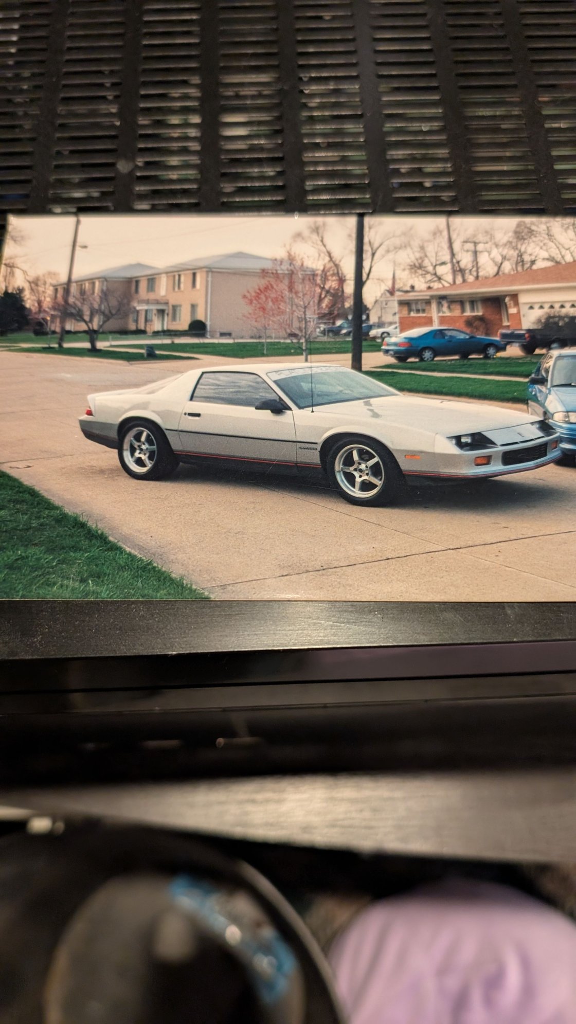

2" all around with ROH Snyper 17x8 front 17x9 rear. I think I have a profile picture, I'll have to look when I get home.
