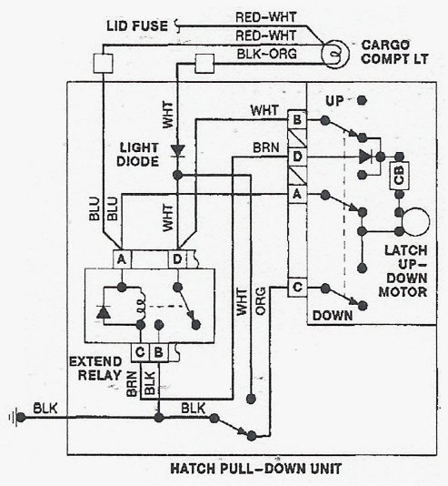

can someone tell me where this white wire goes, the single one off to the right? its on an 87 hatch pull down motor. i cant figure it out, i remember pulling it out of somewhere but i cant remember where it went PLEASE HELP!

Don't know if it's the same as an 87, but here for a 91:

i have that, and i tried using that, and all it did was make my brain hurt. i couldnt figure out which wire it was...thanks for your help tho!

the motor is an 87 so its a little dif. then the 89-up ones. i know where the other wires go, they go into a black relay box, ive got them im there fine. this is off my old unit that doesnt work, and ive got my new one in and hooked up, i just dont have power to it. i was wondering if this wire hadanything to do with it, it'll lock the hatch, and release, but it wont pull down. ive read though Lon from TDS's posts and it seems like ive done everything he says, but i dont know wtf is wrong. do camaro's have the 2 fuses like the firebirds do for this thing? perhaps that could be the problem?

The white wire in question isn't plugged into anything on your 1987 model year car. In 89 or 90 GM changed from a manually switched hatch light to one that is turned on and off by the hatch pull-down unit. In those cars (as I recall) it connects to an orange with white stripe wire. Bottom-line, that white wire in question has nothing to do with why your pull-down isn't working.
Did you check for power at the red with white-stripe wire that connects to the blue wire? Next to check is that the ground wire is connected to the ground location below the hatch pull-down unit. If your wiring has been cut, then you're probably better off replacing the striker-sensing switch.
The only functional difference between the 86-87 and 88-91 pull-down units is the connector on the blue wire. Yours has a large white connector. The 88-91 has a much smaler black connector on the blue. wire. Some people make the mistake of plugging that white wire your questioning into the blue wire.
There is one fuse and relay for the pull-down unit on Firebird and Camaro and another fuse and relay for the hatch solenoid release.
