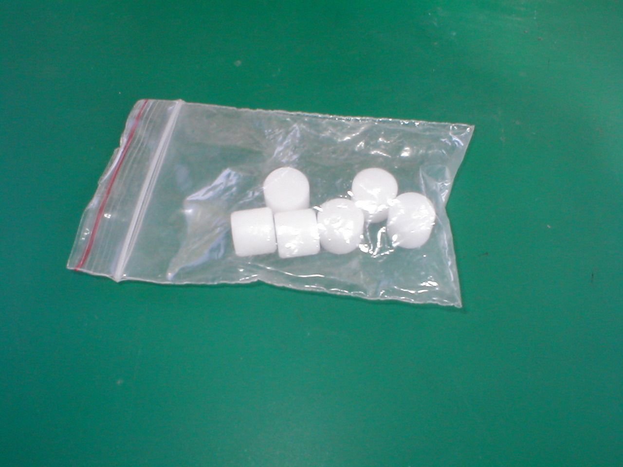

Well... The motors turn a worm gear attached to the end of the armature, the worm gear drives a round gear attached with plastic pellet bushings to the arm that lifts the headlight. Turning the manual **** just turns the armature. The worm gear can turn till the cows come home, either by hand or angry pixies, when the pellets are turned into powder, the powder can't bear between the plastic gear and the shaft attached to the arm that lifts the motor.
The pellets are cheap and can be found all over Ebay or any of the restoration/specialty houses that deal with Firebirds, Corvettes, Fieros, etc. You could even get super sneaky and cut chunks off a wooden dowel, or pieces of hot glue stick, but really I think I paid $8 on ebay for a set of Delrin bushings machined to fit exactly. One set of 6 bushings does both motors. Takes longer to get the motor out, then it takes to replace the bushings.

So I've now fixed mine, I used TDS's rebuild kit for gaskets/bushings, and that fixed them right up. Best thing I can advise is to take the whole assembly out first (2 bolts up top, 2 underneath). You'll have to jack the front end up to get to the ones on the bottom, unless you can squeeze your arm and a 10mm socket wrench underneath, which I was able to do. But for first time taking them off, you'll want the car jacked up.
With the assembly out, try to get the 10mm nut off the actuator arm. If that's off the lights can rotate freely. That's the best option from what I can tell.
