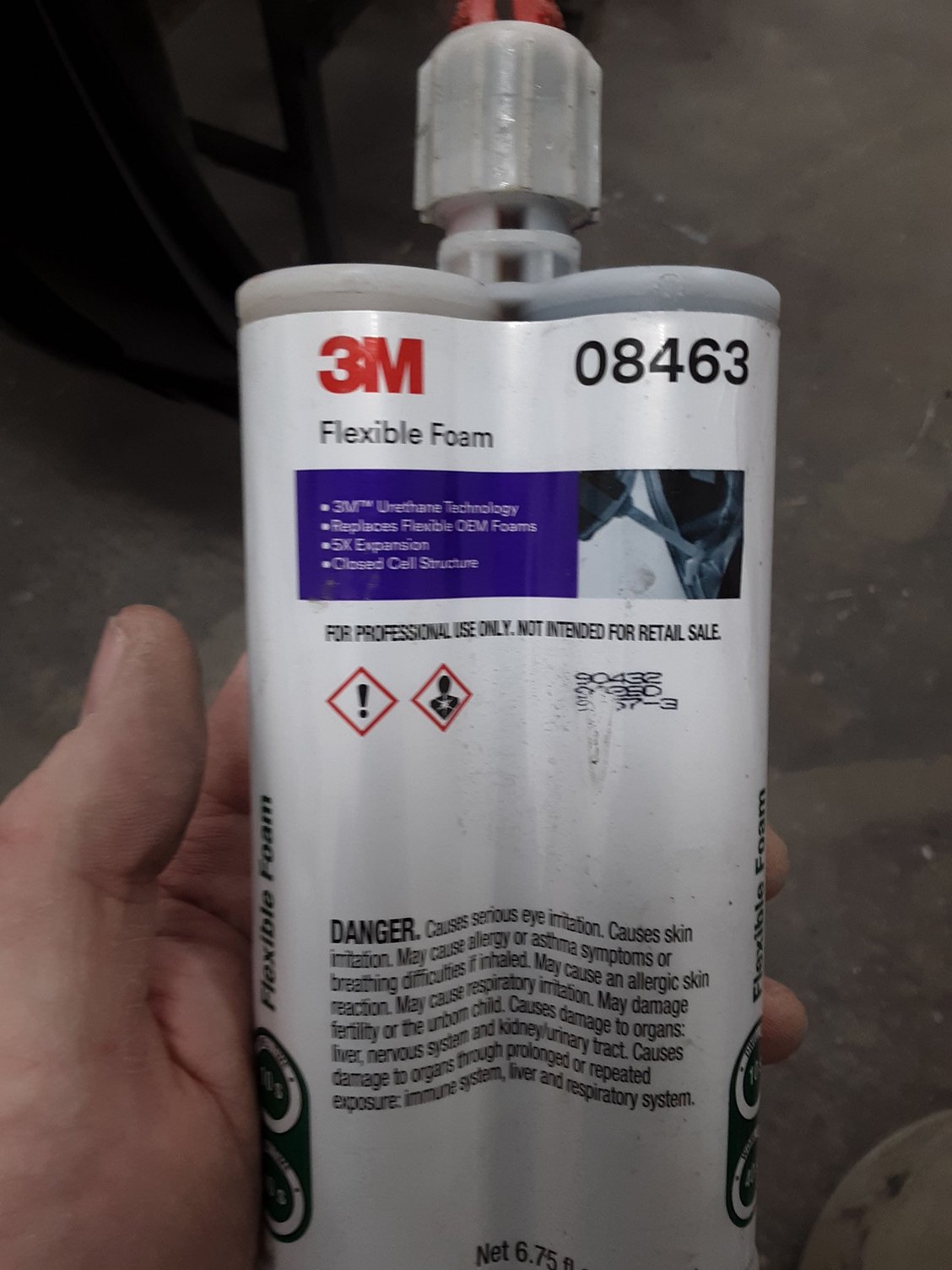

To adhere the inner door brace to the skin, we use this at our shop.
Old Feb 18, 2020 | 01:55 PM
dagwood's Avatar
Top Answer: 1
Posts: 2,678
Likes: 1,267
From: In the paint booth!
Car: 1986 Camaro Drag Car
Engine: 383 on Ethanol
Transmission: Automatic
Re: Door impact brace adhesive
We use the 3M panel bond everywhere else, but the flexible foam is what you want in that spot. It's the same type of stuff that the factories use

High 10:1 expansion rate fills large cavities with a small amount of material
I considered the foams, but decided to avoid them due to expansion. My concern being that an expanding foam could cause the door skin to push away from the impact bar. But if you say it works in that role, I trust your judgement.

NVH 4274 looks promising! I think the 3M 08463 Flexible Foam is what I need. I'm curious as if I was to use too much, would it buckle the door skin? Also, is it possible to rent the gun to dispense the foam?
