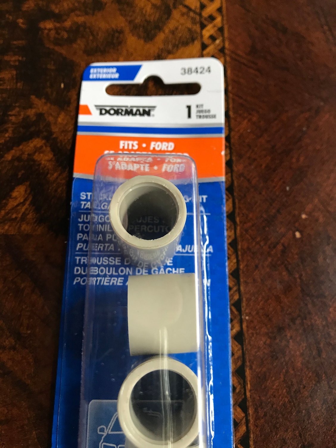

great to hear! Here is a photo, they just arrived. note the pretty bevel

Wont it make the bolt too thick for that latch? Is the plastic block in the latch still there? If its missing it can also cause rattles with latch/striker.

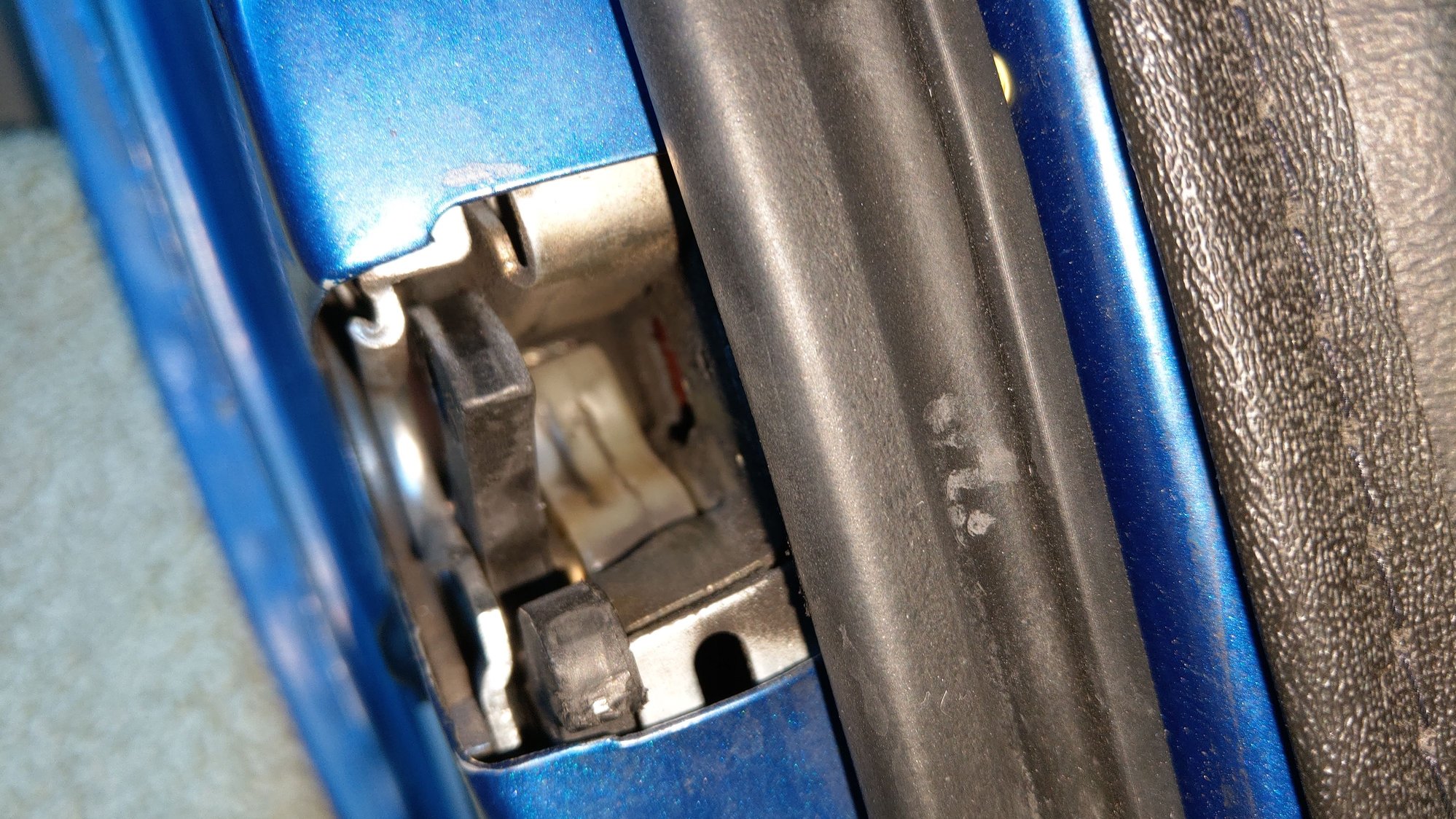

yep,too big. latch wont go over it. which plastic block are you referring to, in the latch or on the door? i noticed the door is bouncing when I shut it, unlike the driver side, which does not.

In the latch.Striker slides on that and stops against it.

thanks, i see. not sure if later model latches have those?? i was able to adjust the latch assembly up a millimeter or so, big improvement. Maybe it was an adjustment issue. wont know for sure until the next spin.

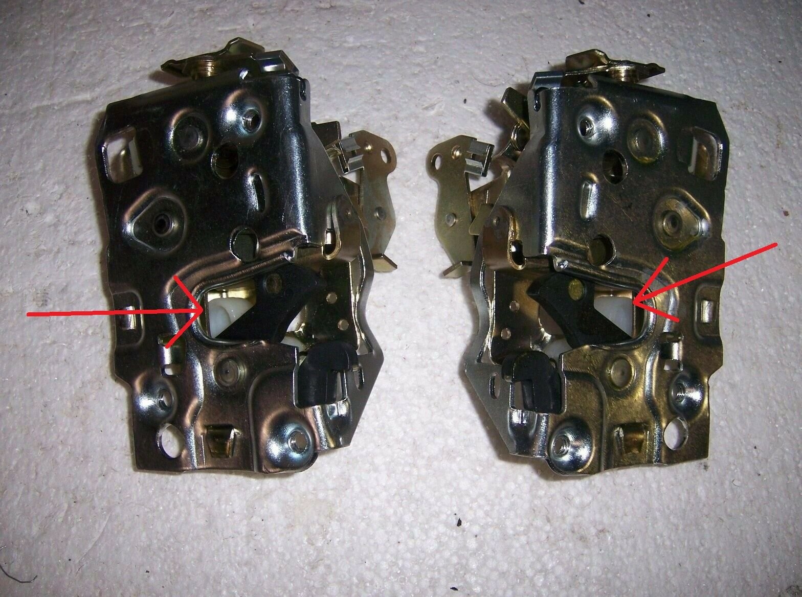

They all have them, unless they fall off,My 84 had them and so does my 89.

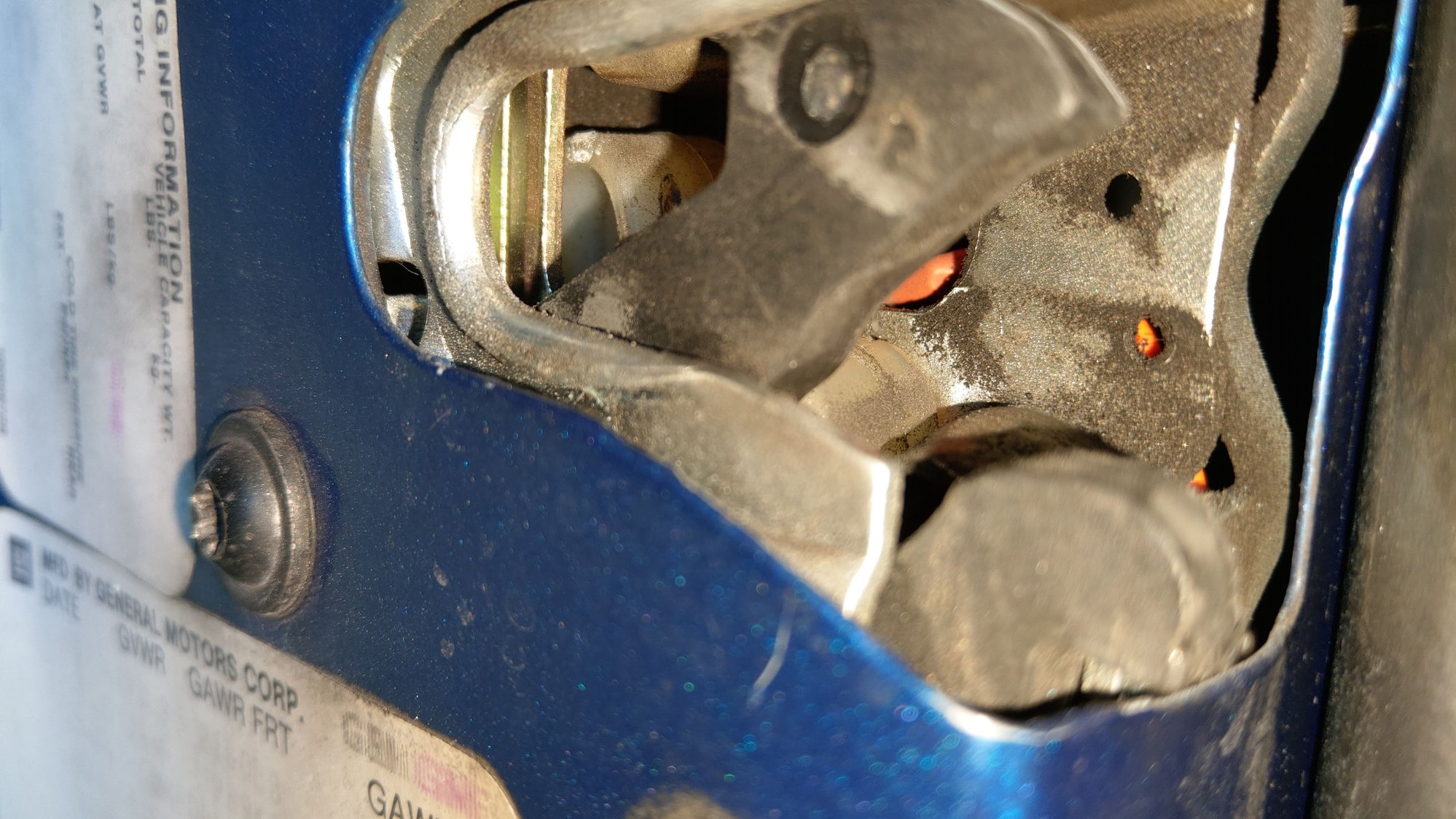

I don't see them in mine. How do they mount? Not seeing anything in there for something like to mount. Not even sure if there is enough room in there for something like that to fit. How big are they?

Not sure how the mount or how big. They're about next to the latch.Its what keeps the head of the striker snug.Here's a pic of mine, even my 84 had them
