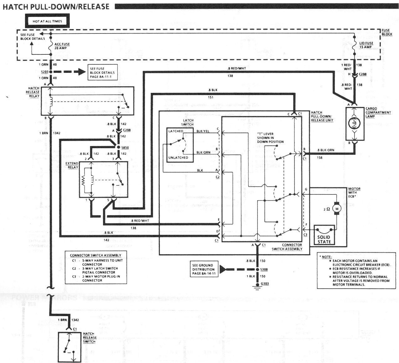

The wiring at the cargo light also supplies power to a portion of the pull down unit, if the light doesn't work due to a bad bulb or a blown LID fuse at the fuse block the pull down unit isn't going to work as it's supposed to. While we're at fuses have you checked the LID and ACC fuses?

91Bandiit2,
If the cargo light bulb is bad would these make the pull down unit not function? I have a 92 with low mileage and can not figure out why my mine doesn't work? I 've done all the testing and everything seems fine. Thanks for any help.

I could be wrong but I believe the filament in the bulb completes that circuit. Do you have 12vdc going into the bulb socket?
“EDIT” You have a 92, that pull down motor is different than previous years. Starting about mid model year in 91 GM switched the pull down motors on these cars, not sure they also switched other GM models like the Cadillac that used pull down motors that were kinda similar in operation. Short story long, I’m not familiar with that newer style of pull down motor so I don’t know how different the wiring is, I can only imagine that the wiring diagram above could be used as a loose reference. The wiring of the bulb could be identical as the previous models?
Yes, I have power to the bulb. I have a 88 Iroc and 92 Z both with pull down motors and noticed the difference between them. On my 92 I did most the troubleshooting according to the service manual and everything seemed to check out fine so I was thinking the motor was bad. Now I'm hoping its just the bulb. I did not bother to change it when I was troubleshooting. I'll keep you posted! Thanks again.

Glad the new to you unit is working for you. If the pull down assembly is stuck in the down position then it could be the reversing switch/T lever. For my pull down motor assembly I ended up taking the reversing switch apart to inspect and clean the contacts as I suspected that this switch was the problem with mine. I posted some pictures last year here......
