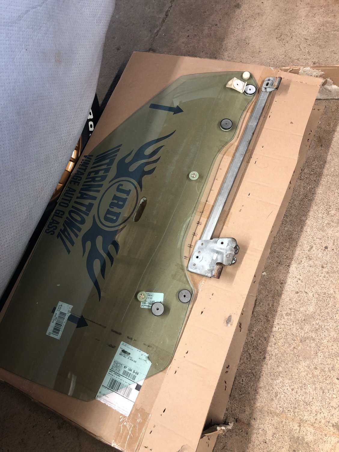

Here’s a picture of the window track. Will the new glass fit into the opening at the top of the door if I install the track now? I assume so if the glass came out of the door like this. I really don’t want to scratch or break the new window. Took over 2 months to receive after I ordered them.

I didn’t read everything carefully so may be redundant.
Install everything in the door except the glass.
Then install glass from top down into that lower track slot.
Then rivet the glass in place. Make sure the plastic bushings are in good condition and in place. No part of the glass should touch metal.

that's what i was wondering. seems like i need to put the glass in the door without the front plastic limiter piece (not sure what it's called) or the track attached. then rivet these pieces to the glass through the holes in the door metal.
this is exactly what you're describing right?
i have power windows. sounds like it's going to be a pain trying to get the wheels on the regulator arms back in the window tracks.
i'm definitely going to cut some wood supports and have a friend or two come over to help hold things as an extra precaution.

I cannot remember exactly.
My recollection is all parts can go in the door ahead of glass. Leave that front assembly loose. I would expect GM designed it to allow glass replacement with the front track and triangle In the car. I’m 99% sure. Im guessing it doesn’t even need to be loose. There should be enough space at the back end of door to fit in the glass if the rear seal is loose.

As mentioned everything gets built/installed in the door and then the glass goes in last. Originally the glass was riveted into the horizontal bar however some have used bolts and lock nuts instead.
